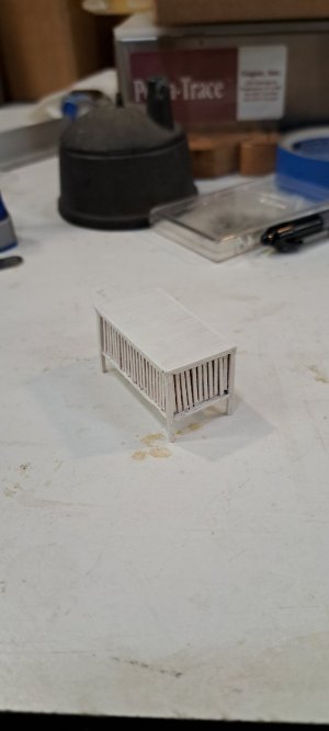

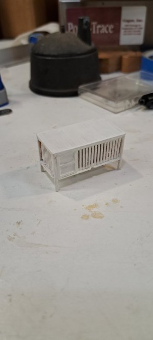

I agree that these working additions add realism and interest to a replica. From what reading I've done, pretty much every cargo hatch would have livestock pens temporarily erected over them. There were pig pens, chicken coops, probably other live animals to eventually serve as dinner over a three or possibly four month journey.
Interestingly enough, I read that often the upper decks of these vessels would resemble a barnyard, what with all the livestock taken aboard. When you think about it, this makes total sense too. I seem to recall reading this account by first person observations of lady passengers aboard Flying Cloud on her record breaking inaugural passage.

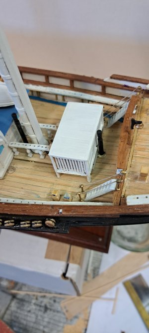

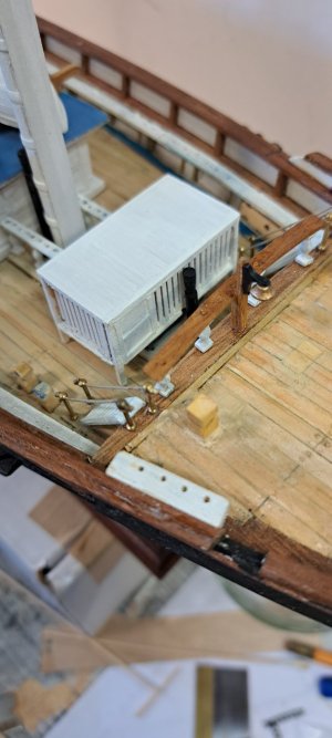

Peter, Not to be a Debbie downer...but the reason you are wondering why the animal pen looks too large and awkward.....is because it is. The pens for livestock on Clippers were generally the size of the hatch it sat upon. During the voyage, the hatch bas button down tight...so the real-estate was used for this purpose. Crowding the deck with such a large *house* made working the ship impossible.
Notice the animal crib(house) on glory of the Seas...sitting atop the main hatch. Aft the main cabin, and the fore hatch has a companionway atop it.
I was basing mine more or less on Scott Bradner's. And yeah it DOES seem waaay too big to move around in the cramped quarters it creates up forward. I don't think anyone will notice anything amiss if I leave off stock pen and poultry coop details altogether. Gilding the lily. Oh well, it was fun to make.:rolleyes:
Not an issue really, "Debbie" This was the conclusion I was slowly arriving at on my own. The evidence was too glaring to ignore. Not the first time on this build.
I happily accept any well-reasoned evidence-based critiques. (Not the same as criticism.) My model gets better and benefits as a result. Something I got used to working at the USNA museum workshop where the font of knowledge was overflowing and unsparingly dispensed! Thumbsup ;)

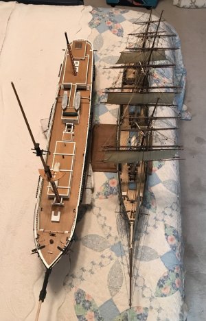

I expect the discrepancy in scale between your premade deck furnishings and the hull could be attributed to error creep in the translation from design to computer file to laser to the final laser engraving. Even an error creep discrepancy as small as 1/32" or less will add up to a discernable difference once the hull is assembled.
It seemed (even to me) to make good use of the time, waiting for the bulkheads to be cut and delivered, by making the deck furnishings in the interim. But there's no accounting for error creep. So, I guess the lesson is wait until the hull and deck are finished and build all the rest accordingly so as to maintain control over the proportions. Even considering this and making card stock templates to adjust for fit, I have largely failed in this regard and made many of my own deck furnishings slightly too large. Thanks for not leaning on me in this regard as I'm sure you can't have missed it. In the end I hope to have an interesting and aesthetically pleasing model, warts and all. I doubt that anyone interested in building a model of Flying Cloud will be likely to use mine as an example of the final word. ;)

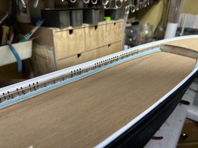

I began the starboard side waterway.
