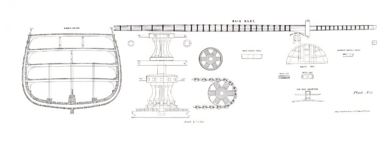

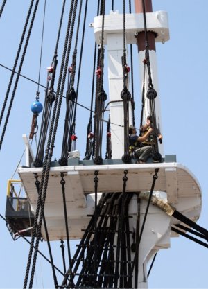

I hope you can take advantage of this latest revelation. Current commercial plans are wrong when illustrating solid top lubber's holes. On Glory of the Seas her lubber's hole opening went clear across the entire top, only ending at fore and aft frames. On the Great Republic booklet there's an illustration of a solid top. The lubber's hole extends from the forward frame about two-thirds across. Both of these examples are easily more than double that shown on plans. When you think critically about this feature, it was designed as an ac too.cess point for crew climbing through to service sails. A long wide opening makes more sense. Ironically making this revision to your solid tops will make it much easier to rig too.

Pete,

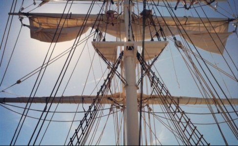

I didn't mean to imply you should do retro surgery. I was thinking you could simply modify other tops which hadn't been installed yet. It would make it far easier to rig the other masts, if you chose to do so. However, taking care of your wife must obviously take precedence over everything else. Family first. As for thinking that only McKay vessels had longer lubber's holes, that's incorrect. Historic vessels have always had long, wide openings to accommodate crew. As confirmation, here's a 1797 fighting top on USS Constitution "Old Ironsides" and a decades later 1843 Whaler Charles W Morgan's civilian solid top. They're virtually identical. It's also another area where it seems like Mamoli and other commercially produced plans and kits are just plain lazy. They should do their customers justice and correct this error in their kits.

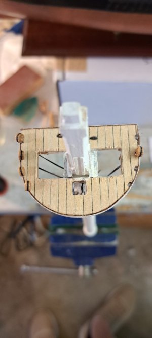

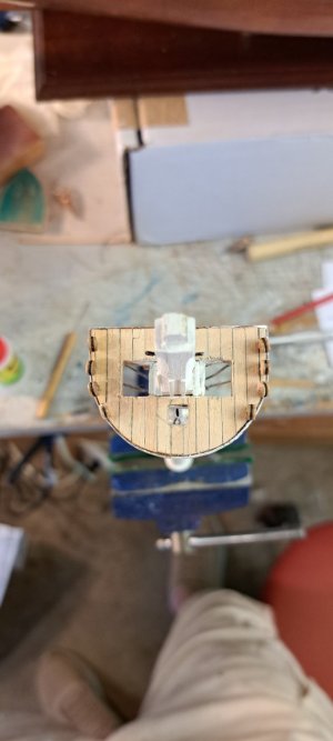

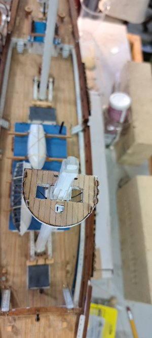

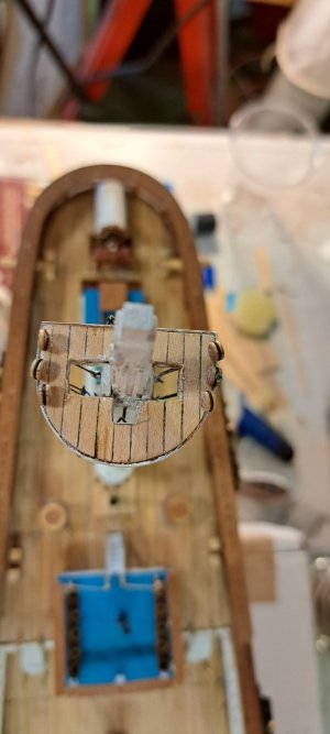

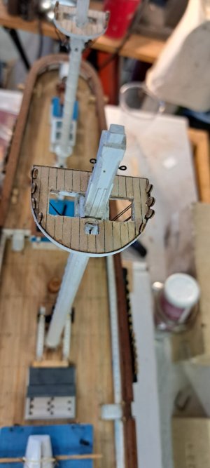

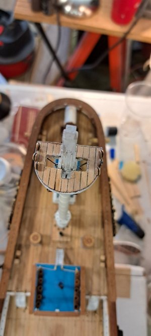

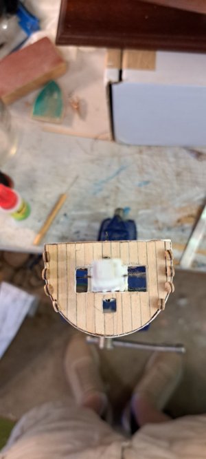

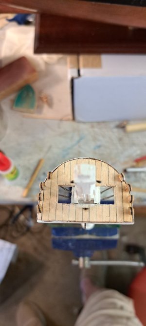

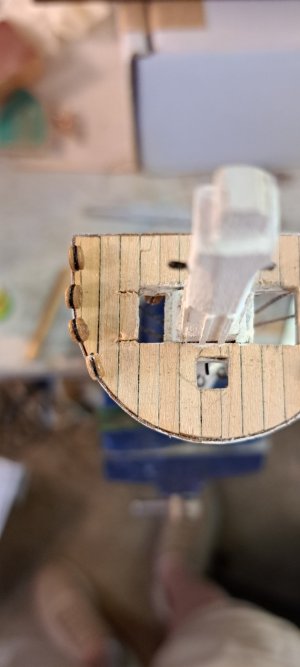

I did find that I was able to open up the lubber holes in the tops, which would allow greater ease for rigging to pass through as well as a man. So, I did that without too much more ado. The only casualty being the supports for the main top left side deadeyes. Easy enough to re-do. On the Young America and other clippers, much of the rigging from above passes through fairlead holes drilled into the tops outside the lubber holes.
I like the look of the roomier lubber holes.20250623_115217.jpg20250623_113857.jpg20250623_114311.jpg20250623_115828.jpg20250623_152414.jpg20250623_115848.jpg20250623_115828 (1).jpg20250623_152436.jpg
I like the look of the roomier lubber holes.View attachment 527755View attachment 527756View attachment 527757View attachment 527758View attachment 527759View attachment 527760View attachment 527761View attachment 527762

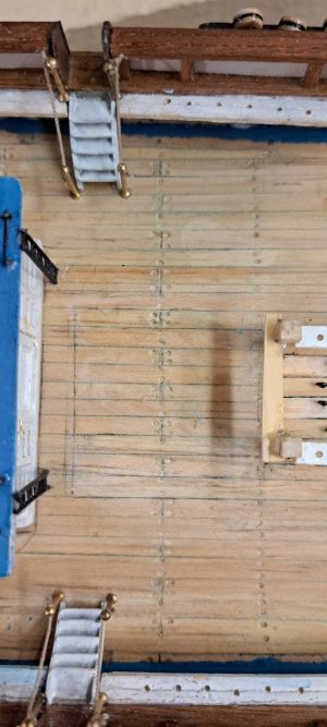

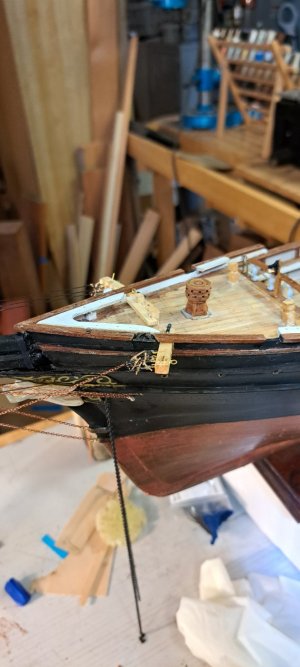

Last pics of the newly modified lubber holes, masts dry fit in place. This build has been a zig-zag path of modifications and do-overs. But, hey, it just keeps getting more interesting, an unfolding story of the "Flying Cloud" My most Iconic favorite since I first fell in love with these clipper ships as a kid 70+ years ago.

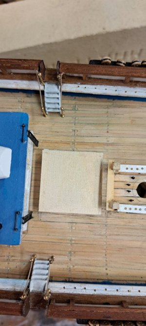

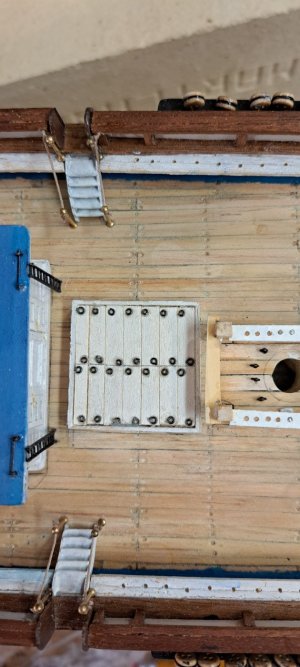

Back by popular demand, I'm starting on a second iteration of the over-the-hatch animal pen. This time over the main hatch, which makes the most sense and doesn't crowd the deck egregiously. (He said,.. hopefully :rolleyes:) Also started fitting cocks into the spray rail.20250624_141749.jpg20250624_141708.jpg
I had to unglue my main hatch and reduce its overall dimensions for the animal pen to fit on top leaving enough room for crewmen to move around it on deck. if the hatch had an inner coaming the pen could securely fit on top, if its floor had a framework to secure it snugly over the inner coaming (not shown on my hatch as it would not be visible once the pen is secured on top and battened down). This eliminates the need for overlap of the pen floor and overlapping legs. This is the best way I can think of for everything to fit and still leave a believable amount of working room while still having20250625_132659.jpg20250625_132511.jpg20250625_132647.jpg a hatch close to the dimensions of the various sets of plans I have. I also slimmed down the front part of the fife rail.
I'm glad I made use of various kinds of white glue as it easily releases with a little isopropyl (rubbing) alcohol, considering the number of dis-assemblies I've been required to make. :eek:
