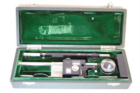

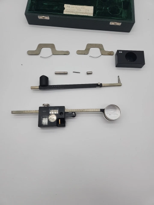

You are absolutely correct. It's not likely that a modeler would require a professional drafting instrument of any kind. In most instances the student level instruments get the job done if used with care. The one exception I would note, however, would be instruments which are marked with scales. The scaling affects the accuracy. There's a big difference between the scale on a classic machine engraved rule and a cast plastic one!

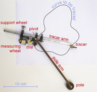

Actually, there's a trick of the trade for taking accurate readings with a planimeter. It's critical when tracing the edge of the irregular plane with a planimeter that you keep the cursor exactly on the edge line. While this is easier with planimeters that have good magnifying "bullseye" cursors, it is still a tedious exercise, and a shake of the hand can cause an error. To minimize the error, one can take repeated measurements, five or ten being quite adequate, I'd think. Any measurement which is obviously greatly erroneous can be discarded, and then the total area of the measurements retained thereafter is then divided by the number of measurements retained to yield an average measurement which, in theory, at least, increases the accuracy.
I suppose I should also mention that anybody who may be considering acquiring a planimeter should identify the type of scale measurements they want to obtain. There are a lot of different options, the most obvious being metric or imperial measurements and the range of measurement, e.g. feet, yards, meters, etc. Some planimeters can be set for a wide variety of measurements, while others are limited.
