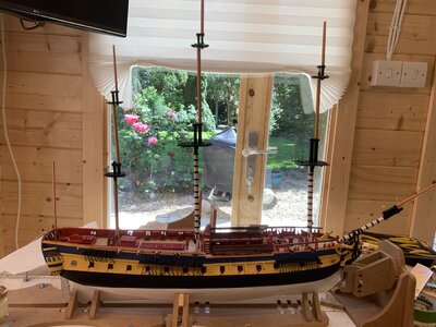

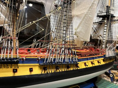

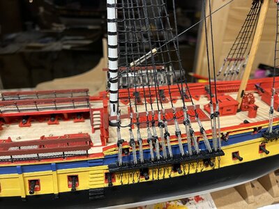

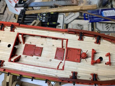

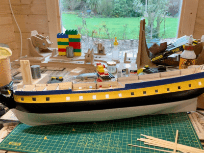

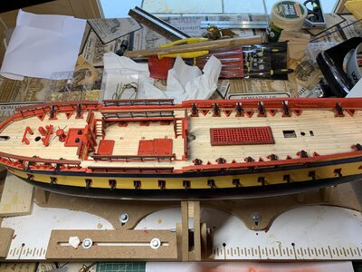

Frigate Hermione, Scale 1:89 , Artesania Latina kit, by John G [COMPLETED BUILD]
Feb 2, 2021
24
58

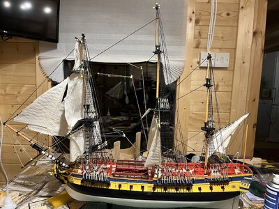

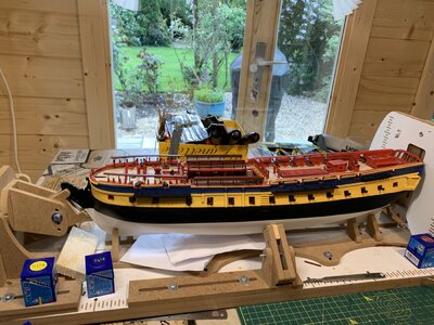

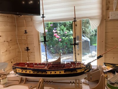

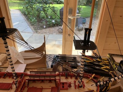

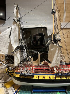

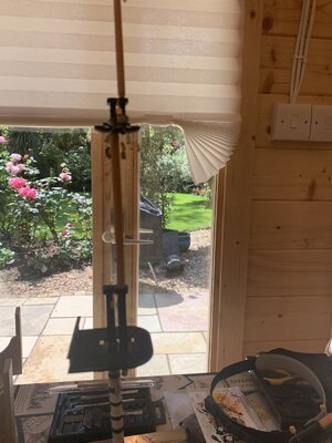

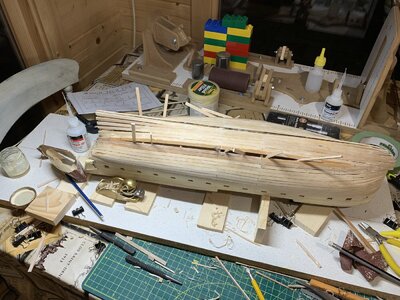

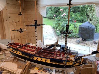

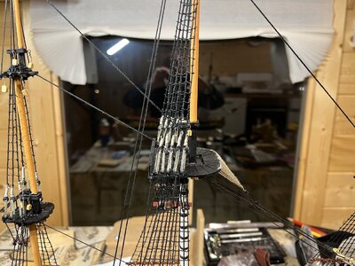

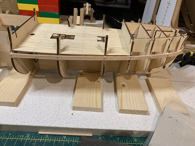

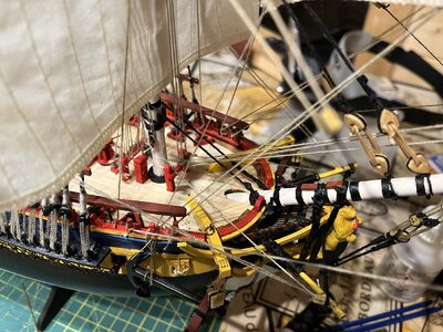

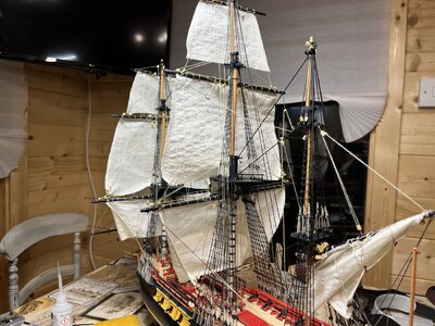

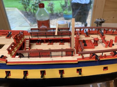

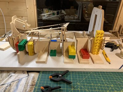

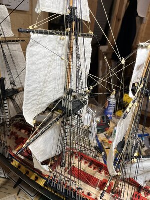

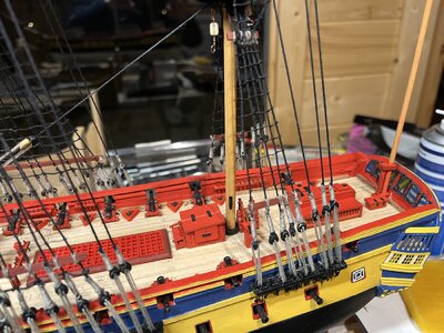

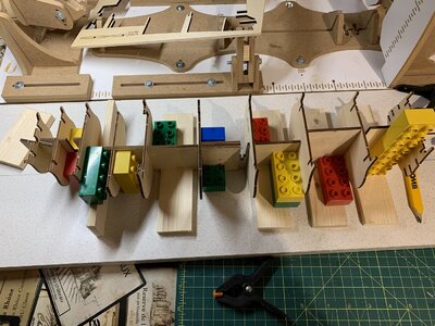

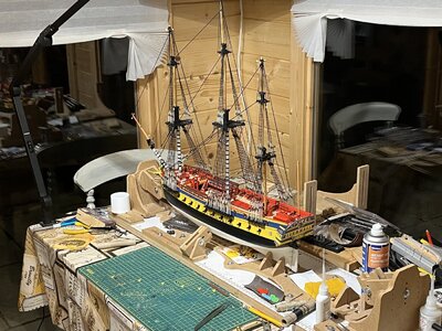

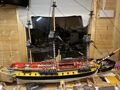

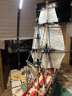

Started Jan 2021 . Just completed Dec 2021

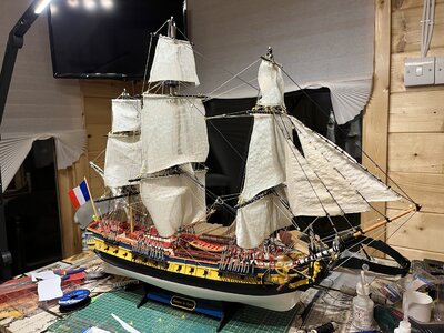

On March 21, 1780, the young Marques de La Fayette embarked on the Hermione, setting sail for America to fight alongside the American insurgents in the struggle for their independence. Two years earlier, at the Rochefort Arsenal, in a building berth close to the Cordeire Royale, work had begun on the Hermione, a light 12-pounder frigate, over 64 meters long weighing in at more than 1200 tons and with a sail surface of over 1500 square meters, spread on the 3 masts. The Hermione was built from plans drawn up by the engineer-shipbuilder Chevilliard l’aine.

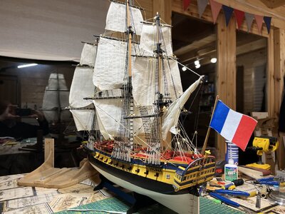

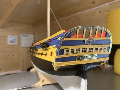

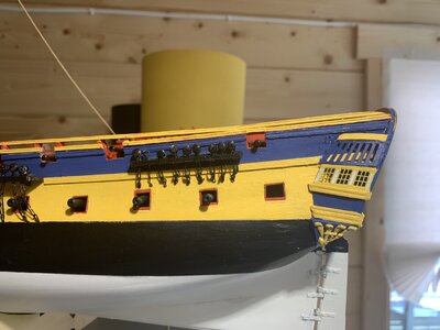

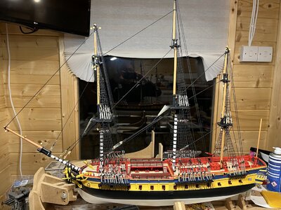

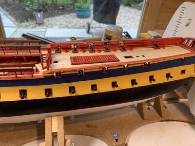

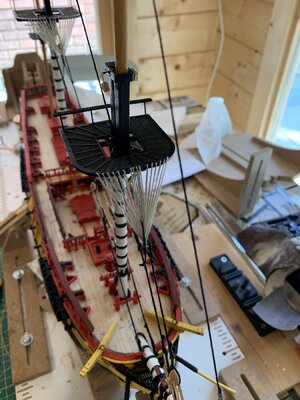

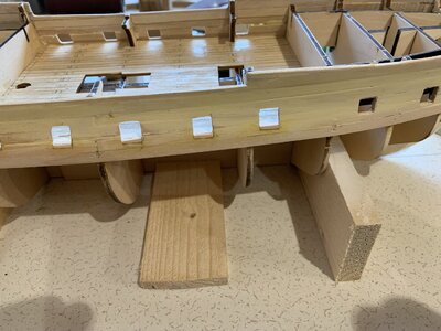

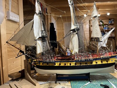

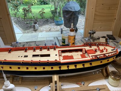

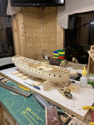

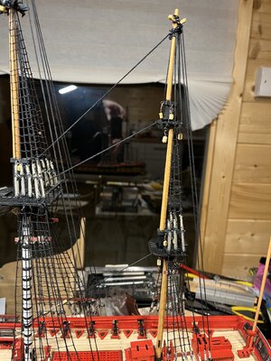

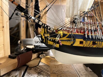

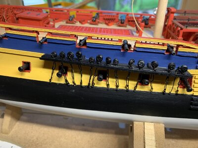

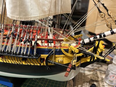

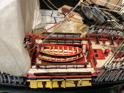

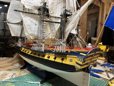

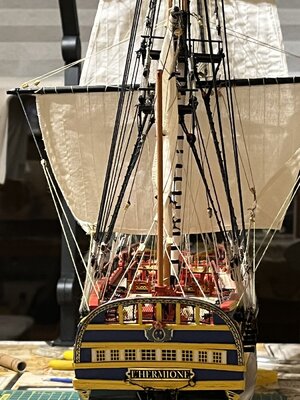

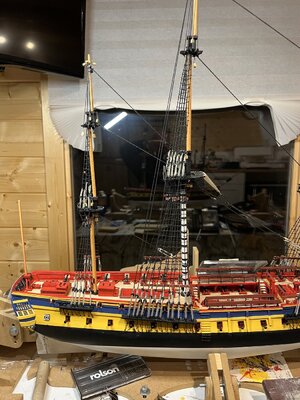

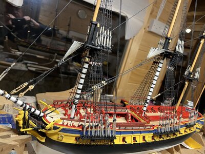

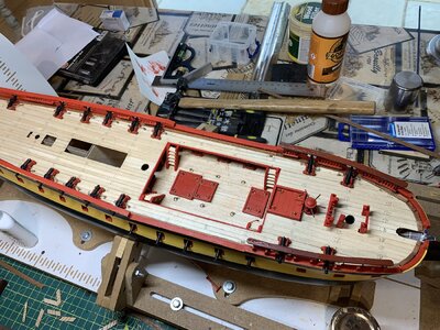

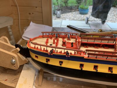

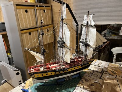

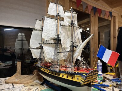

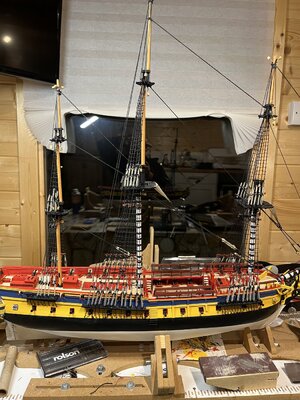

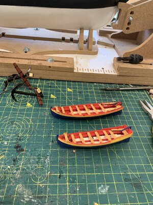

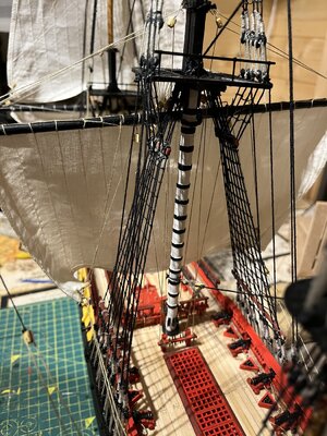

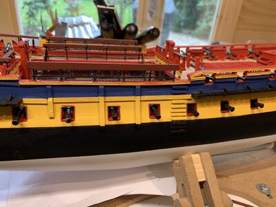

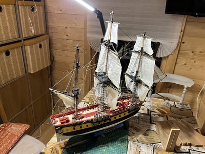

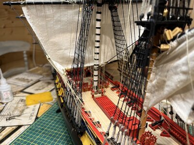

IMG_2287.jpegIMG_2286.jpegIMG_2280.jpegIMG_2281.jpegIMG_2288.jpegIMG_2290.jpegIMG_2289.jpegIMG_2291.jpegIMG_2293.gifIMG_2313.jpegIMG_2314.jpegIMG_2315.jpegIMG_2319.jpegIMG_2321.jpegIMG_2320.jpegIMG_2326.jpegIMG_2325.jpegIMG_2328.jpegIMG_2327.jpegIMG_2330.jpegIMG_2331.jpegIMG_2339.jpegIMG_2340.jpegIMG_2341.jpegIMG_2342.jpeg

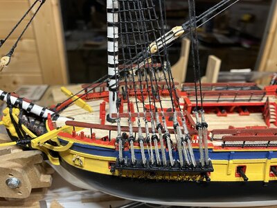

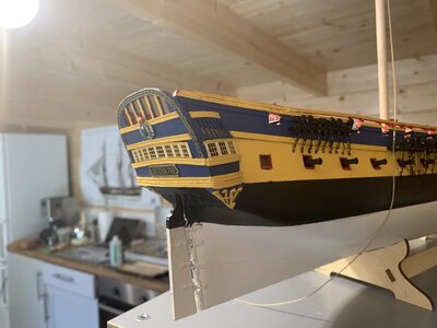

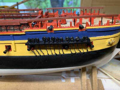

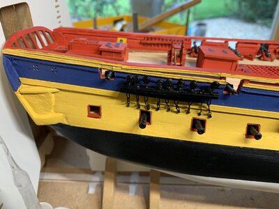

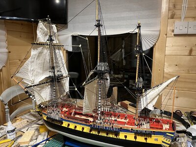

Thank you. I used Revell aqua acrylic paints. They have a very high pigment content and give a great finish with just brushing. However they also dilute well for use with an airbrush which I used on the hull initially but during the build there was plenty of touching in with a brush. Being acrylic the colours remain true which is very important when touching in.
Thanks for your answer. Think i need to convert all colors to Tamyia. My local dealer dont sell the revell type.
Instructions is mentioning two types og yellow. Pastell yellow & yellow. I’m not sure if I’m going to match the colors in the instruction sheets or just plain yellow
Is it possible for you to send me the revell color #??? I can then convert them into tamiya colors.
This is the Revell Aqua chart available from Amazon . Perhaps they will ship to Norway
Amazon is not up and running in Norway yet so my plan is to test mix the tamiya colors to match the pictures in the DVD instructions… but I’m still at hull planking at this point so no big decision has been made

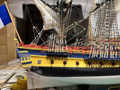

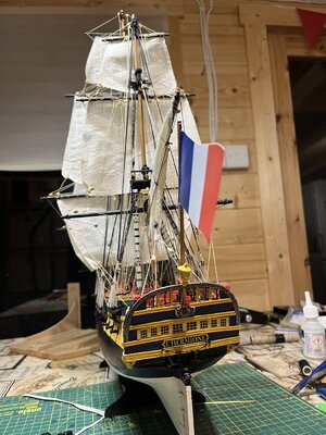

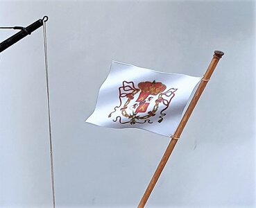

Hiciste un gran trabajo, los tonos de la pintura son muy brillantes se ve bastante bien, felicidades, si me permites una opinión mejora mucho si le agregas movimiento de viento a la bandera, lo puedes lograr poniendo un poco de pegamento blanco diluido con agua a la bandera y la dejas secar dentro de dos láminas metálicas a las cuales les das la ondulación que desees, saludos.
Mira esta una bandera que le hice efecto de viento en uno de mis modelos.
