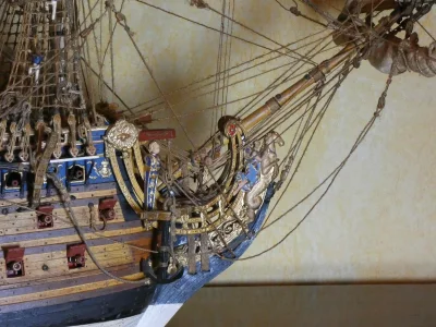

Thx - I have a metal ships boat on my wooden Amati Pinta - to which I'll happily apply some of these techniques. And oh yeah - nice work, BTW. Wow!
