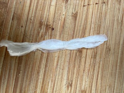

Here's my first experiment at a technique. It involves tissue and dilute PVA. I haven't gone near a ship with it yet, it was just a proof of concept. Don't laugh.
It produced a sail that is easily manipulated for a long time. The fluid dripping out may be an issue if the yards are already mounted. The colour can be altered by adding dye/paint or whatever. The finished article is a rubbery consistency. Next step is to try using string to make the furl more realistic - this one just got prodded with fingers. This is about 6 inches long. The transparent glue edges would need to be trimmed off.IMG_8561.jpg

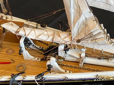

I followed his instructions and I think it looks great. These sail were off the Bluenose.

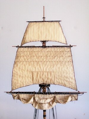

Hi all, For a short time ago, I mentioned that their es NO questions, but many stupid answers to a question, so in this case, I will -instead of an answer- make a few other questions to Pkloui, as there is absolutely no more info than you will like to furling sails. Question nº1: which type of sail? Squiersails or the Latina Sails.
2: Have you make the sails already, or how far are you with the building. I have a lot of information about this on ships from about 1750 to 1850mnabout on a bigger warship- 74 Gunner. here we have a Cargo Ship? from 1620 with a different riggen- only two squaresail on the foremast and main, so I do know this type of riggen. I will add some info -but not going into making the sails, as this was not part of your question - but before that, I was furling my sails- mainly the lower one, as in the real-life, as I have had all types of ships around my hole lite. I have in fact been onboard "LILLA DAN" a topsail schooner as a member of the crew.
