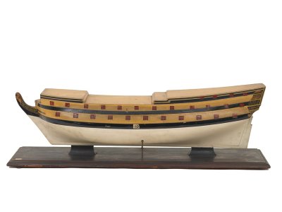

1733 Establishment
Suffolk 70 1739
151 x122 1 x 43 5 x 17 9 1224bm
O 35
K 36
L 39
Sister ship
Elizabeth 1737
Essex 1741
Prince Frederick 1740
Nassau 1740
Bedford 1741
Royal Oak 1741
Revenge 1742
Stirling Castle 1742
Captain 1743
Monmouth 1742
Berwick 1743
The plan
ZAZ1434
Other plans
ZAZ1364 WIKI
ZAZ1375 WIKI
ZAZ1393 WIKI
ZAZ1392 WIKI
ZAZ1355 WIKI
ZAZ1437 WIKI
ZAZ1368 WIKI
ZAZ14380 WIKI
ZAZ1433
ZAZ1436 WIKI
ZAZ1437 WIKI
ZAZ1438 WIKI
ZAZ1514
ZAZ1515
HIL0162
Models of the ship

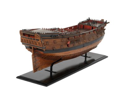

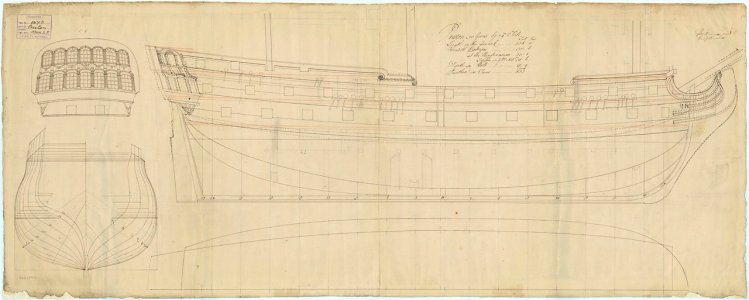

1733 Establishment
Preston 50 1742
134 1 x 108 7 x 38 7x 15 9 860bm
O 39
K 39
L 42
Sister ship
Gloucester 37
Severn 39
Saint Albans 37
Woolwich 41
Dartmouth 41
Guernsey 40
Antelope 42
Hampshire 41
Leopard 41
Sutherland 41
Nonsuch 41
The plan
Other plans
ZAZ1790
ZAZ1791
ZAZ1652
ZAZ1703
ZAZ1653
ZAZ1721
ZAZ1745
ZAZ1793
ZAZ1792
ZAZ1822
ZAZ1813
ZAZ1732
ZAZ1733
ZAZ2207

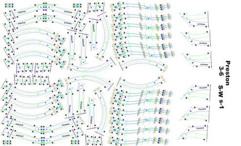

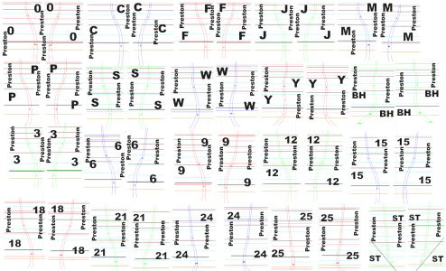

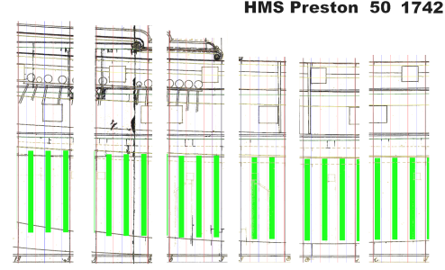

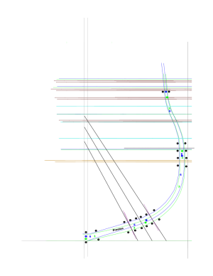

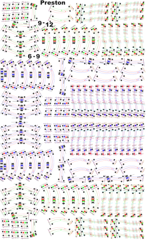

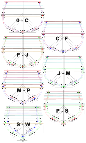

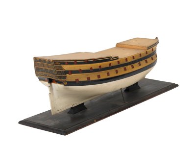

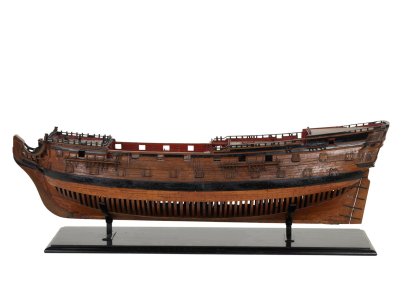

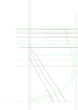

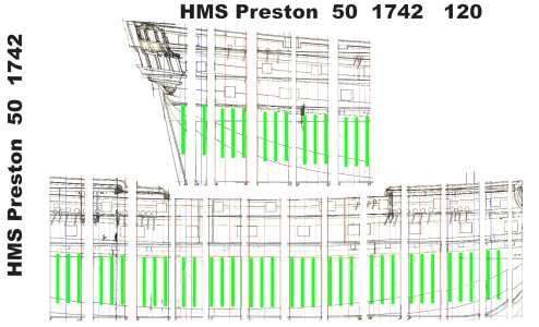

Models of the ship
Stations 96"
R&S 32"
Floors 15"
This is my midship framing plan and instructions and lofting steps
1:60
Preston Station frames 2 .pngPreston HF 48 3 .pngPreston HF 3-6 .pngPreston Timbers 3-6 S-W s1 ii .png
1:120
Preston Station frames120.pngPreston Sandyply 1.pngPreston gauges .pngPreston Timbers120 6-9 9-12.png
