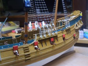

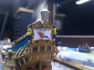

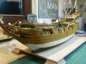

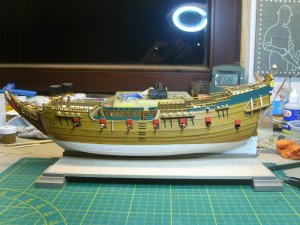

Thank you. But the only wood I've used here are the masts and deck planking. The hull is made of cardboard and treated only in color.

WOW that's amazing for being cardboard. I have the shipyard Victory I have been collecting card stock in the proper thickness for the build but I'll probably mix wood into the kit as well. I did buy the sail and mast kits for it also so ill probably do the decks in wood. I bought the kit with the idea in mind to use all the patterns for an all wood ship build, but I have a Victory wood kit and though it might be nice to just build it in the stock its supposed to be in. The biggest issue for me with the kit is I hate to cut stuff out with scissors so I have done the frame and its parts with a straight edge and hobby knife even that gets to me after a bit so I enlisted the help of my wife. she is a scissor using fool and cuts the parts out super quick as well as accurately.

Wow! Wow! Wow~ That is beautiful, and it looks like a wooden model. How strong is the hull as far as durability goes, how well does it take being handled?

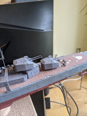

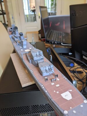

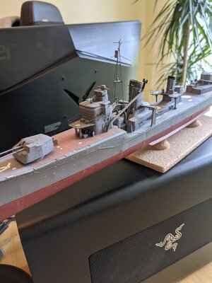

It is a clear, custard-like consistency. It makes the paper a little wet and softer - easier to bend and roll etc. Below my never to be finished IJN Yukikaze made with paper glue. the contact adhesive was used for bulkheads and deck.
CA glue is used to soak edges to make them sandable.
View attachment 235306View attachment 235307
