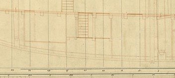

Trying to work out if the Mizzen has a slot for the Mizzen Mast like the Fore and Main
If I understand your question correctly the contemporary inboard profile drawing (RMG ID ZAZ3383) shows the mizzen step with a slot where it goes over the keelson similar to the main mast step and foremast step and rests on the frames.
