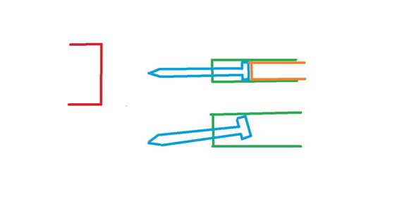

Most important is, that the inner diameter of the nailor is not much bigger, than the head of the used nails.
Only with this the nail is alligned and follows the same direction like the tool. Otherwise damages can happen.

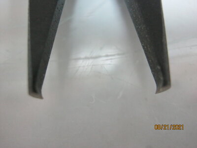

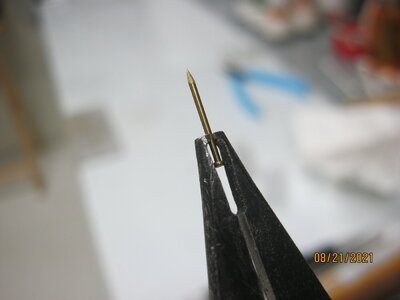

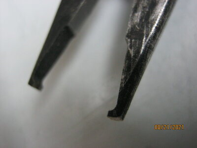

I use this from Micro Mark. It is a tool used by model railroaders for track laying, made by Xuron.
It grips the shank of the pin or nail. To prevent bending longer pins / nails, I grip it close to the pointed end to get it started in a pre-drilled hole, then slide it back further up the shank until the nail is mostly all in. Then remove from the pin, close the jaws and using the flat end, gently push it in all the way.
This tool is a cutter / snipper. Wil cut off BRASS pins and nails flush with the surface.
