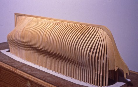

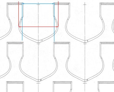

Harold Hahn had written 35 articles on ship modeling, 2 books, 16 sets of plans, 25models and hundreds of figures, 16 etchings of nautical subjects and hundreds of prints, etchings and drawings each and everyone titled, numbered and signed and his work in three museums. He won awards at the Cleveland Museum of art as well as national competitions at the Library of Congress in Washington and the National Academy of Design in New York, at the Victory show at the New York Metropolitan Museum his was the first of five prints purchased for the Library of Congress collection. This classroom will pick up where the Harold Hahn article ended. An overview to show the system used by Harold Hahn, the system known as the upside-down method which is designed for a first-time builder of a plank on frame model. There are pros and cons to the system and pit falls a builder has to watch out for which we will get into later on. For now, the focus is on how to modify the original plank on frame plans to a plank on bulkhead model. The article will focus on building the Hannah, all the plans Harold drew are set up the same so the same procedure can be applied to any of the ships in the Hahn collection or any plan with hull lines.
