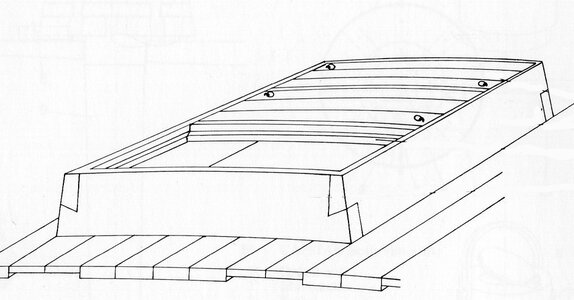

This is a very interesting topic. I do prefer the look of the lap scarf joint rather than the picture frame mitre joint.
On the subject of the lap scarf joint I'm a bit confused on the logic behind the 'dovetail' wedge on some of the below pictured joints, specifically since the lap scarf joint does not have the second dovetail wedge to lock the joint in place.
Also, the lowest point of the wedge is located on the inside of the joint.
If the lap scarf joint is not serving as a locking dovetail joint, then wouldn't the inner corners of the wedge (red Arrows) be better placed higher than the coaming corner to not allow water to accumulate inside the joint? (I hope I explained this ok)
Or is there another reason for this type of wedge shaped lap scarf joint?

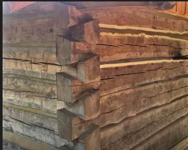

Back in the 1970s i worked with the Cuyahoga National Park to research, document and draw working plans for a historic canal boat. The idea back then was to build a working canal boat the park would use on the canal as an attraction. There were a lot of issues so the park ended up with a 1/2 scale stern section for the Canal Museum. During the research old ads and interviews were uncovered that were asking for barn builders to work in the boat yards. Not ship or boat builders but "barn" builders. This was because of the German immigrants that settled in the area were master woodworkers and builders. The saying at the time was building a canal boat is like building a barn upside down.
Barns were like Starbucks of the day i could not walk a mile from where i lived in any direction and not come across a barn.
Looking at barn construction it becomes clear the same joinery used in their construction was also used in boat building. The dove tail in various versions were used for 100s of years to join timbers at a 90 degree angle.
Even in ship building the lap joint and dove tail was used way back. In some cases a simple version was used as just a lap joint and sometimes the carpenter got his fancy on and did a dove tail.
keep in mind a ship was a dynamic structure it moved and joinery had to be strong or the ship would pull itself apart. a mitered corner on a hatch coaming would pull apart.
very good point John and when you look at the joint when i was cutting it you can see a oh so very slight rise to the top of the coaming below before i trimmed it. Once it i was trimmed that slight rise is hard to detect.

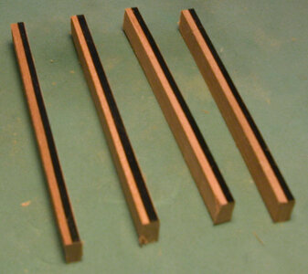

Another method to create the bevels on the hatch coamings is to use a disk sander. First I marked the upper edge by using a strip of electrical tape. Next is to set the table to the angle of the bevel.
A problem with the small, short pieces is holding them against the sanding disk without sanding the tips of your fingers in the process. A solution to this is use two sided tape and stick the coaming to a larger piece of wood. This give you much better control and saves your finger tips.
By holding a larger piece of wood you can gently move the coaming back and forth on the disk to get an even sanding along its length. The idea is to sand the coaming right to the edge of the electrical tape.
sy to rock you piece or sand it uneven the electrical tape give you a clear and sharp edge to guide the sanding.

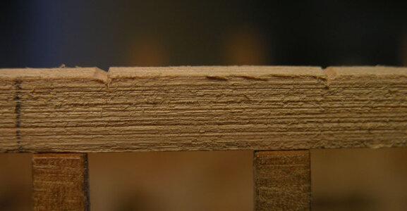

Once all the coaming pieces are cut and beveled the next step is to mark them out for length. Marking is always done with the knife by making a small cut line.
Here i am marking the length of the coaming to the inside if the carling. If you are building a model using a false deck and you intend on keeping the hatch open mark the coaming to the edge of the opening. If you intend on keeping the hatch closed you can totally skip this step and just make the coaming to the dimensions on the plans.
a notch is more accurate than a wide pencil line when marking a piece.
a trick i do is cut a tiny notch at the side that i want to cut off, what this tends to do when i start my saw cut the notch gives the saw the least resistance and it follows the side of the notch and does not cut into the piece.
