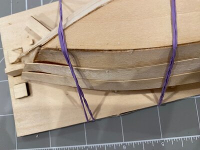

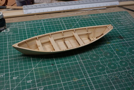

Hello from Tucker, Georgia. The ships on this forum are truly impressive and inspiring. I've undertaken my first build, the Lowell Grand Banks Dory. As meticulous as I've tried to be, I've managed to botch a few things up and am learning from my mistakes. Now that I have all the planks glued on, I've got to clean up some issues caused by putting too much pressure on the plank while it was drying. Should I wet the planks in the areas where they're warped out of shape and try to reshape them? If doing so, will that make the white glue I used dissolve? It's embarrassing to post the results in the picture to such an experienced group, but I've learned a lot and will likely order another Dory and try to do a better job applying what I've learned. Any advice, including yea, trash this one and start over, are appreciated. Dory.jpg
i have been buiding models for 50 some years and i goofed up the dory. What i suggest you do is go to hobby lobby or get a sheet of basswood and use the laser sheet as a template trace the shape on the sheet and cut it out. Trying to reshape a warped plank usually does not work.
Thank you for your reply. I like the idea of getting a piece of basswood and recreating the planks. That would be good for practice. Although I'm tempted to finish this one as-is to get my learning curve under me and just do a second one better. Someone mentioned in the forum that it's good to use sander sealer before painting due to the basswood grain. Are you familiar with this material?

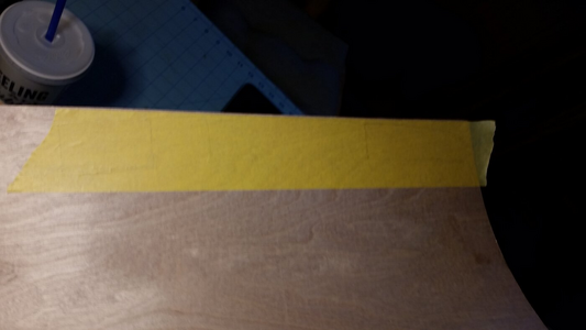

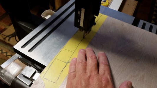

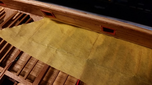

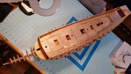

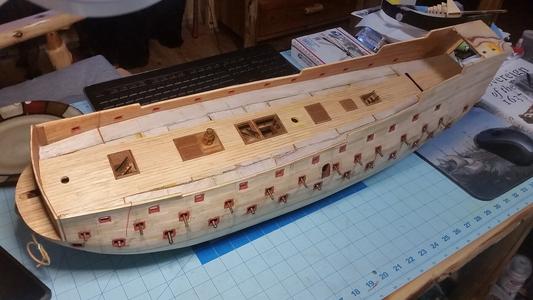

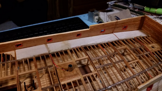

I have used sanding sealer with basswood. It clogs up the larger pores in the wood so the paint won't soak in as deep, leaving a smoother paint finish. It is also good for ensuring that wood stain comes out more even and not blotchy, expecially on softwoods like pine. When wet, basswood is very pliable as you have experienced, but also coarse in grain such that if you bent it too much, it delaminates into a bunch of fibers. Basswood is easy to shape, carve, and sand, but does not stain well, and lacks grain contrast. The good thing is that it's cheap, and great for structural work in models, and you can layer hardwood veneers over it to provide the appearance you want. Damaged pieces like those on your dory are easily replaced. If you cannot remove the old planks and use them as patterns without destroying them, then use the tape-pull method: Cover the damaged part with masking tape, take a pencil, and trace the outline of the part on the tape. Pull the tape off the model carefully, and stick the tape to a new, flat piece of thin basswood. Use a saw or razor knife to cut the new wood to the shape of the outline. This preserves the curved shape of the old part and lets you transfer it accurately to a new piece of wood. Then cut the damaged part off your model and replace it with the new part.

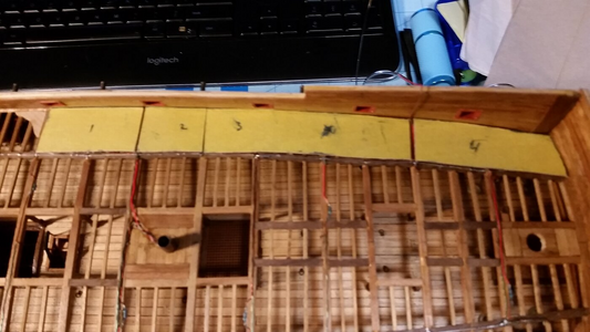

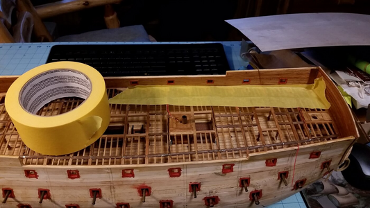

Tape-pull method example, using tape to create new false deck panels whose edges match the curves of the bulwark precisely with no gaps:
Trace seam lines and edge along the bulwark with pencil
Transfer the tape to new wood
Darken the lines so you can see them.
Cut with bandsaw.
Test fit.
Glue down new parts.
Repeat the process until entire deck is covered.
Plank over the false deck.

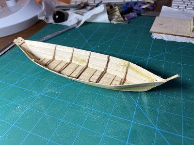

I appreciate the comment about the instructions not being clear. I would prefer a photo for each step in the instructions. I've been following a YouTube video build video and it's been very helpful although there's no narration. And you're right about paying close attention to the instructions. I've already learned "that looks close enough" or "I guess this is what that means" is not the way to approach this. I now have an appreciation for how carefully the parts go together.
