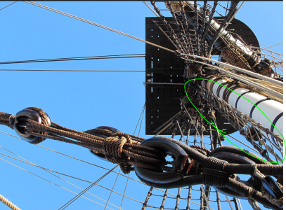

I can! I have a few thousand photos I've scraped from dozens of sources. I don't have a single "smoking gun" photo to reinforce my assessment here, but I have a few that a more clear than others. I was, by the way, a bit mistaken about the tackle pendants being lashed to the shrouds. I was working off a quote from Jean Boudriot's 74 gun ship treatise, which says they are typically "stored inboard of the shrouds". I'm not sure how I misconstrued that as having anything to do with lashing. but I have this nice pair of photos which capture both a clear view of a descending tackle pendant *and* (albeit rather occluded) the main top preventer stay. I'll attach them twice below, each once unedited, and once with my highlights.
you can see the tackle pendant fitted to a triple block, which is consistent with every description I've found of them on a ship of this size, and to the right you can see the considerably less substantial preventer stay reeving through a single block, proceeding down and abaft the foremast, and you can also see the turns of the "rattling" (or whatever that is) along it.
If you're curious why I seem fixated on the replica (which I'll admit, is not 100% accurate) Ill say I'm a relative newcomer to studying this material, and it's a lot to take in. seeing these complex arrangement in full scale really helps me. and while the replica deviates in many small particulars, it's usually close enough to help me make sense of what I'm reading about from primary sources. and I'm also curious about *why* it deviates from traditional rigging. the people who built this ship were certainly as passionate as anyone here, I'd wager, so I'm curious about what the rationale behind the changes is.
