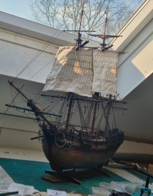

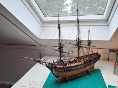

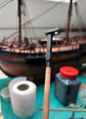

The last 6 yards are ready! I hung them (ry-fit) on the masts for the photo.
Now I have to decide whether to equip my Bounty with some sails. If I do, I will make the sails myself. However, I think the ship without sails is also nice. This way, there wile be a good vieuw of the yards and rigging.
Ideas and opinions on this are (as always) welcome.

maybe try paper, that's perfect ffor the job. But with furled sails you have to raise a few yards.
It is possible that I will indeed try paper if the initial attempts with canvas do not yield the desired result.

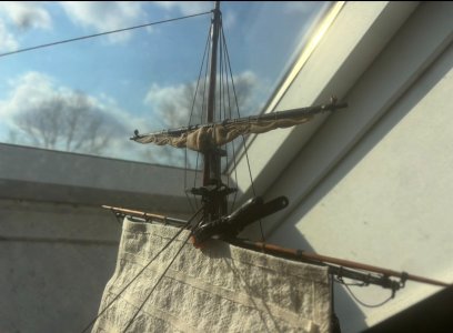

In the photograph, I have temporarily hung the yards to get an idea of what the ship looks like without sails.
A question about the running rig of the sails:
When a ship removed the sails from the yards, what running rig remained on the masts and yards?
If I decide not to equip the bounty with sails, I would still like to show as much rigging as possible. At the same time, I do not want to ignore historical accuracy.
Example: The photo below shows that I have already started installing running rig, without a sail attached to this yard. So I wonder if I have done something here that did not actually happen. I would love to hear your thoughts! All comments are welcome.
I don't think much was removed. Because this was less work than putting the sails back in place. A lot was stored on the yard. You can take a look at Johann (Archjofo)'s report, he is currently working on this and has done a lot of research into it. I have never looked into this in depth, I have always built with sails until now.

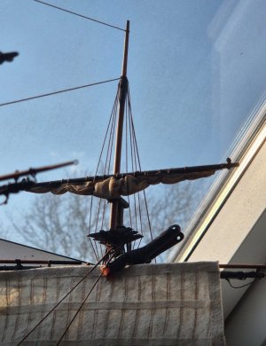

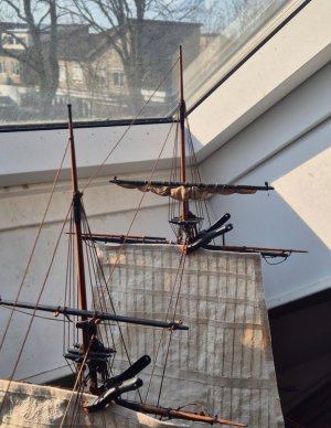

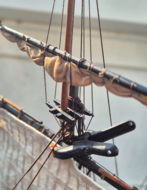

Yesterday I carried out a TEST using a stowed sail.
The aim was to see how I could colour a stowed sail and hang it and let it drape in a realistic way.
As far as I’m concerned, this first test has already been a success!
Once I have the final sailcloth ready, I will remake the stowed sails for both royal yards and hang them up permanently.
The other sails will also be remade using the new, thinner sailcloth. The sails in the photo are only there to give an overall impression of a possible final result.
As always, I’d love to hear your thoughts!
