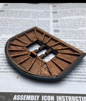

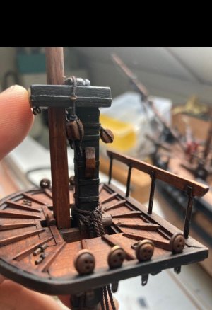

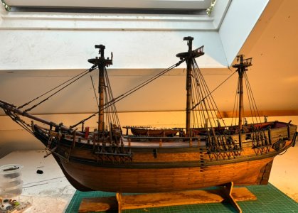

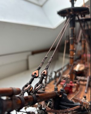

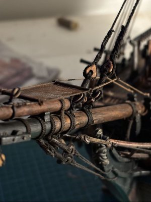

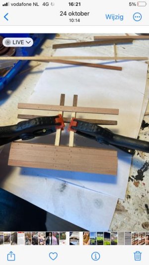

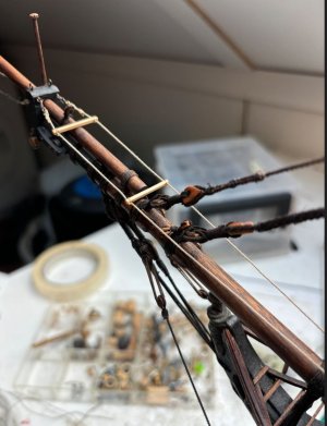

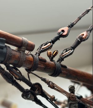

The next step was to make the masts. I only used the round timber from the kit.

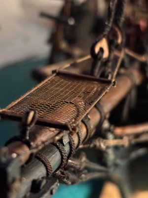

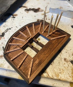

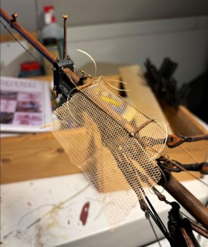

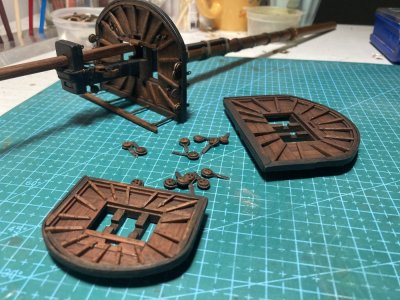

AL included grates in the kit for the platforms. However, these were of such poor quality that they were unusable. Below is a photo from the Artesania Latinas manual.

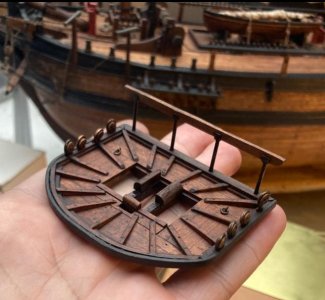

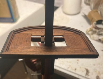

Although I read somewhere that Lieutenant Bligh had the Bounty (Bethia) fitted with platforms with grates, I decided to make the platforms solid. I then scratch-built them using pear wood.

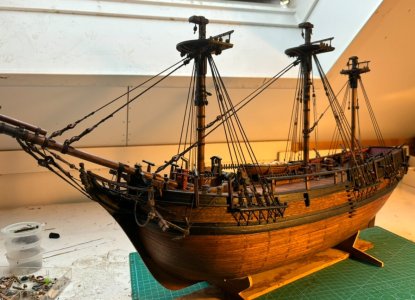

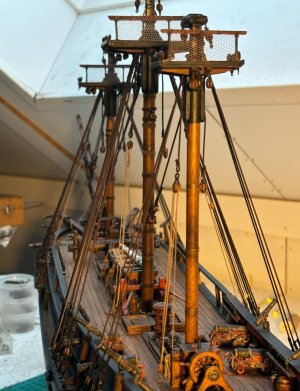

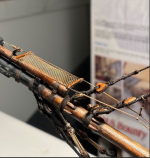

The result can be seen below with a (large) number of photos. Have a great weekend!
Cheers Erik

grated tops which I believe were introduced when they changed the HMS Bertha to HMAV Bounty. Cheers
That's right, Grant. Although the tops of the Bethia have indeed been replaced by gratings, I also made the tops solid. The gratings from the kit were of such poor quality that it was impossible to make nice symmetrical grated tops.
That's why I had to scratch them. I made it a bit easier for myself with solid tops.
