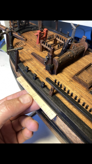

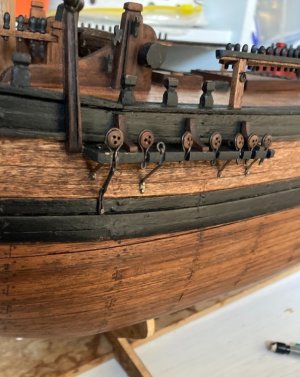

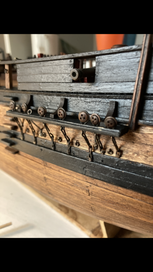

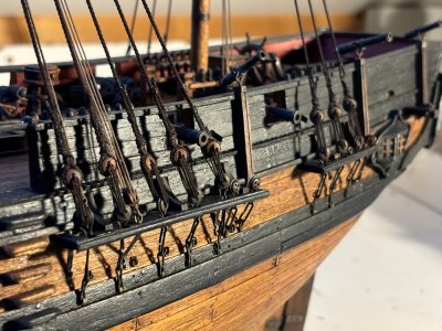

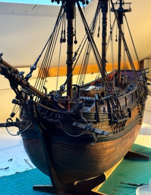

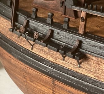

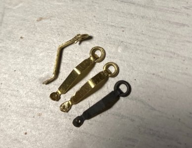

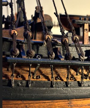

The next step was to install the fore, main, and mizzen channels. From this point on, I increasingly deviated from the Artesania kit. The kit provides unrealistic chains and other brass parts for fixing the deadeyes. So I decided to make these parts myself. The result is shown below in a few photos.
3D71132F-2021-4677-9297-C1D674785AF5.png5B78AF13-EF83-48BF-A74A-6C266FD0D857.jpg59A644C7-9CA6-4A3D-B919-BF6548E3D771.jpg729D30E1-80F7-4DEA-A8C3-D4FC5C48620D.jpg
And as usual, here are a few more photos to give a more complete picture of the later stages of construction:

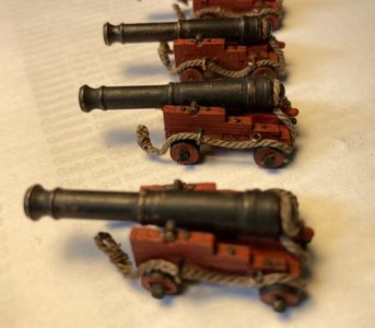

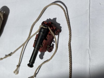

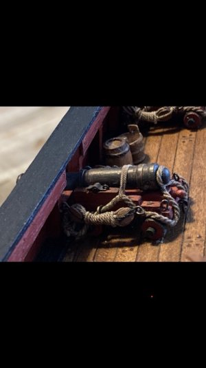

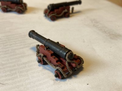

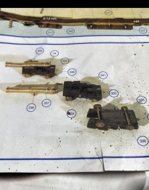

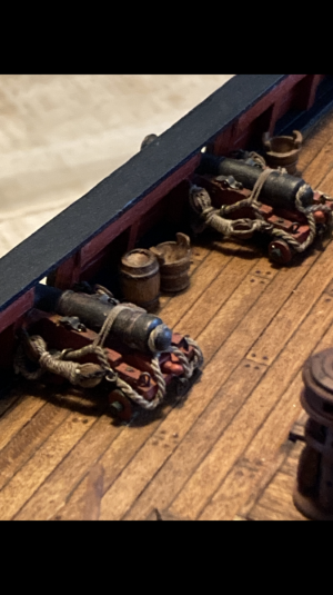

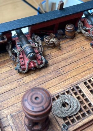

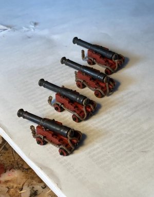

The same story more or less applied to the cannons. Many adjustments had to be made to the parts from the kit. For example, I think the AL carriers are too long. I shortened them and added more detail. I did use the barrels from the kit after blackening them.
The rope that you can see in the photos from this point onwards is also not the rope from the kit. I order all my rope for this build from
www.modellbau-takelgarn.com.
2.jpeg9C59A7D7-D5AD-4C34-9E89-8C27FFE99584.jpeg0F24AD7A-788A-47F1-B74D-ABF065A9663F.jpgAF9C7C50-2740-4B49-9784-CED2CF34E45B.jpegE7C174EC-D363-423D-AC02-BA5B7D79D150.jpegF20666CA-A8F0-432E-971A-14E46C6CDAED (1).png
View attachment 553774View attachment 553775View attachment 553773View attachment 553776View attachment 553777View attachment 553778

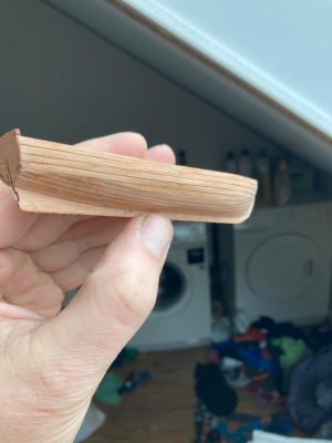

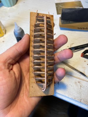

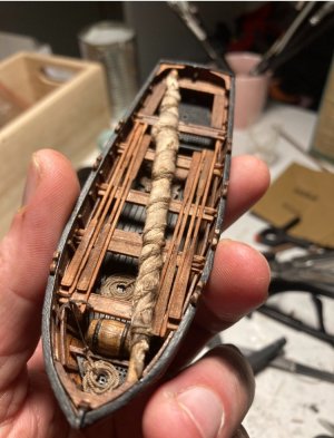

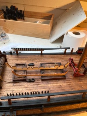

Today, I will show you how I made the boat on the deck.

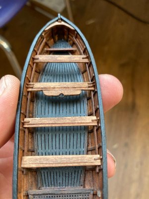

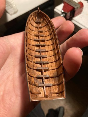

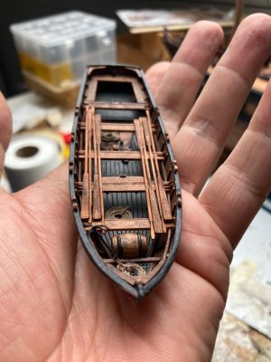

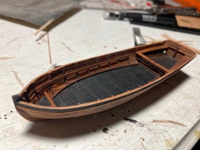

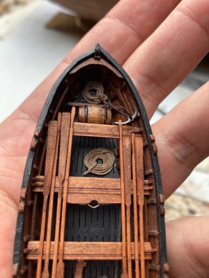

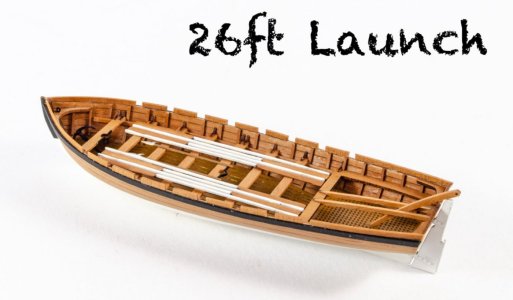

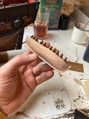

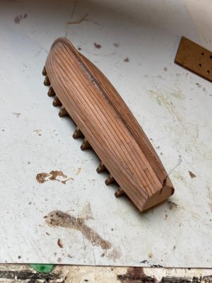

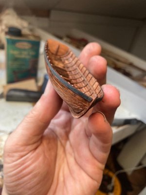

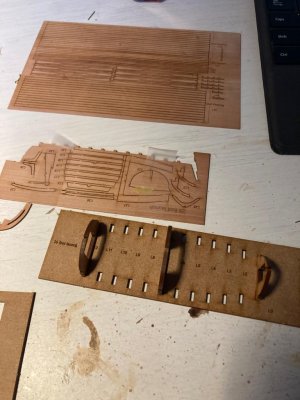

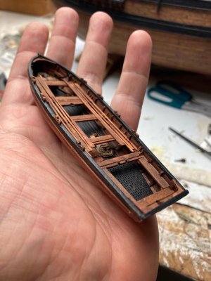

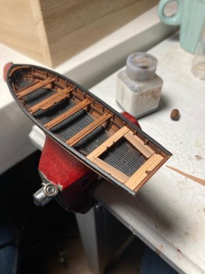

Here too, I chose not to use the boats from the kit. However, I didn't want to scratch build the boat entirely either. That's why I ordered a small kit of a 26 ft Launch from https://vanguardmodels.co.uk. It turned out to be a great kit for making the launch exactly the way I wanted it. Although the scale of the kit is 1:72, the boat is only slightly smaller than the large boat from the Artesania kit and still larger than the small boat. That's why I decided to build my version of the Bounty with only one boat on deck. You could compare it to the situation after the mutiny. As far as I'm concerned, this brings me close enough to the historical situation.
Anyway, I will show the building process again using an extensive number of photos.
