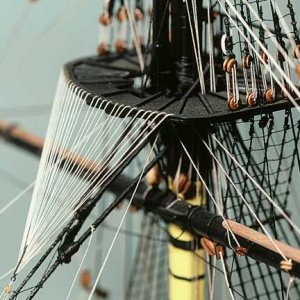

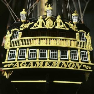

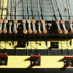

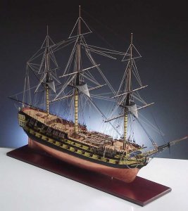

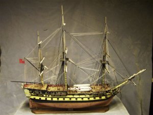

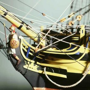

A customer model by Roger W Clark
http://www.jotika-ltd.com/Pages/1024768/CKit_Aga_01.htm

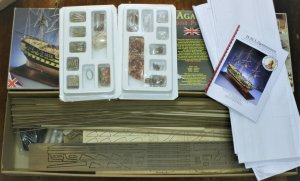

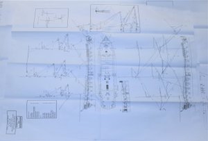

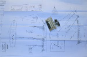

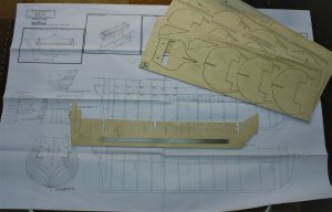

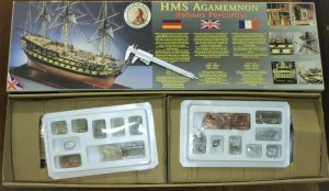

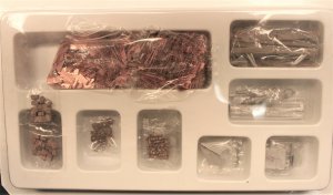

Now the Look Inside of the Box

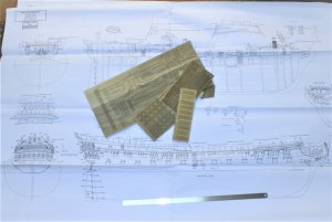

More Look Inside photos of the kit please take a look at the following post
HMS Agamemnon 1781 - 64 gun ship - scale 1:64 - JOTIKA / Krick

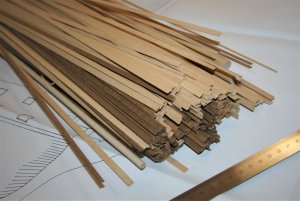

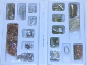

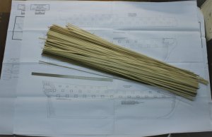

after the years in the box the rubber bands are damaged, so all strips only in one bundle

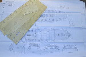

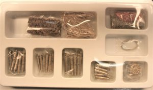

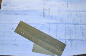

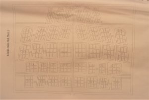

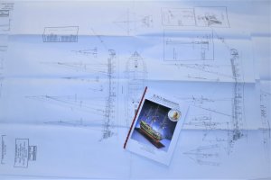

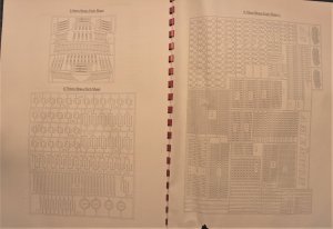

unfortunately I can not find the photo-etched plates in moment, so I made photos of the content list in the manual
