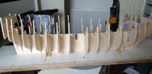

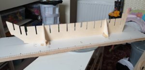

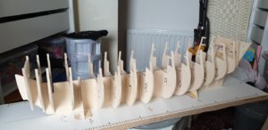

These photos are testing to ensure the keel is straight, I'd read many stories for warped keels but this one is very good
The fitting of the bulkhead took a while,, they are very tight... As I will be altering them and expect to remove and fit them a few times I needed them to be fairly loose,, or I would definitely break parts.... the plan is to use the lower gun deck part to ensure they are secure in the correct positions before they are finally glued into place

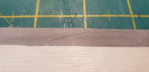

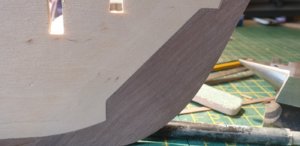

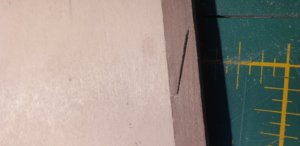

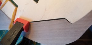

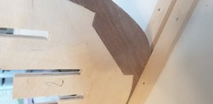

First parts to be tested and glued into place were the 'Bow', Keel strips' and Rudder Post....
The ‘Bow’ was not a snug fit in the middle,, causing the part to be able to move up and down.. so whilst deciding what position was correct I decided to work from the Rudder post, this was a very good fit then I worked forward,, once the ‘Keel’ strips were fitted this showed the correct position (I hope) for the ‘Bow’
There was a gap of about 2mm that had to be corrected,, the top and bottom of the part fitted very well
and a small gap where the keel strips joined
All sorted,, I suspect these will be hidden anyway,, but i couldn't not fix them,, my inner nagging voice wouldn't let me

Jim do not forget the rabbet & deadwood area at the stern before fitting the keel. CC kits have multiple layers that will not fit properly unless these are done. ( My first mistake with the CC Endevour. CC also put lots & lots of info in their plans so study them well and couple of steps ahead. I have the CC Victory to do next and its 1.4m
