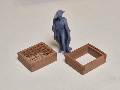

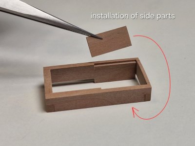

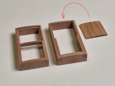

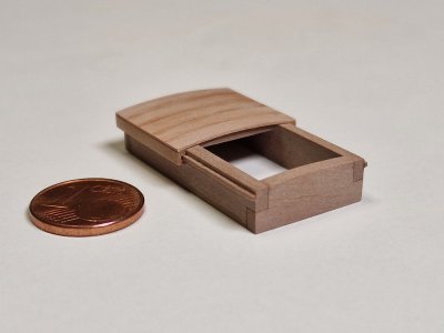

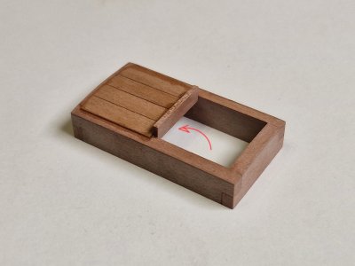

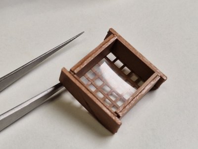

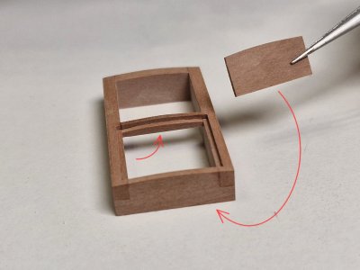

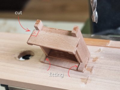

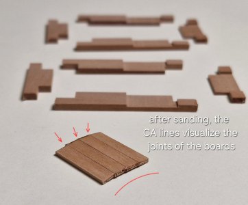

4. Skylight (companionway to captain`s quarters)
1/2

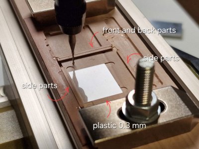

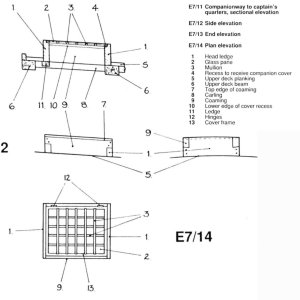

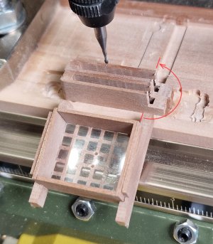

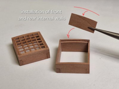

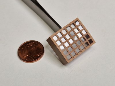

To understand the procedure, you can recall this information, where I showed a 3D visualization with step-by-step instructions.

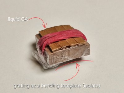

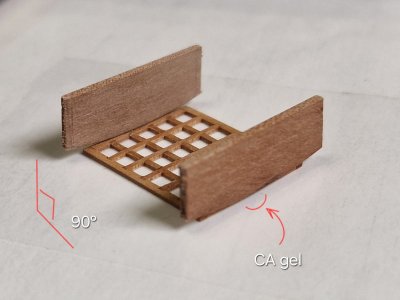

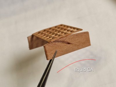

Well, now step by step, how I made Skylight.

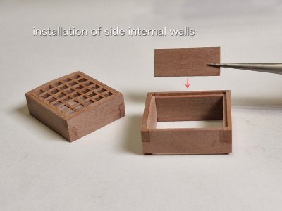

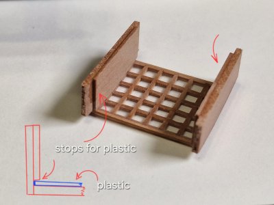

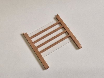

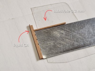

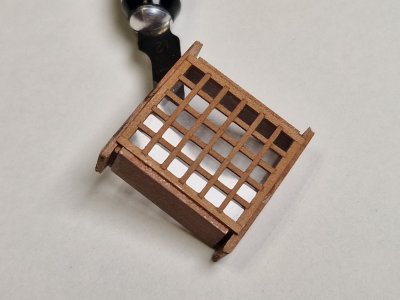

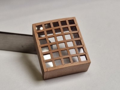

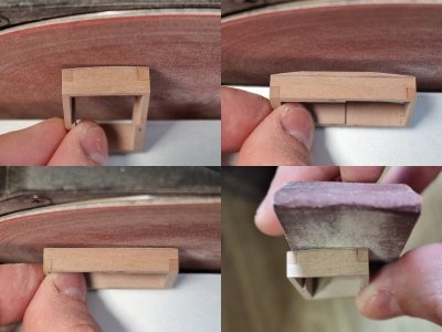

I accidentally spilled glue on the plastic and it turned white. So I carefully peeled it off and made sure the glue no longer touched it. I made internal stops to hold the plastic in place.

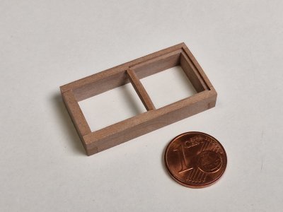

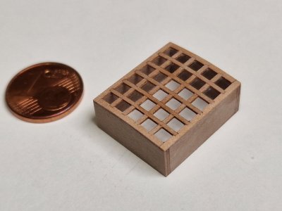

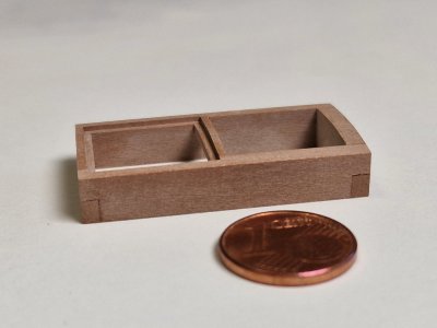

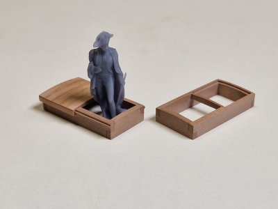

Well, here's the result. But let me clarify one thing! The frame isn't ready yet; this is only the inside. The main part of the frame will still be on the outside.

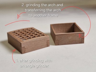

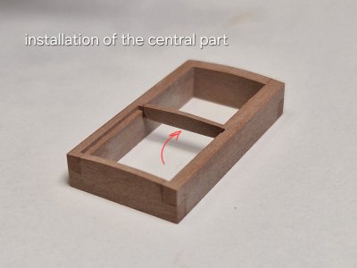

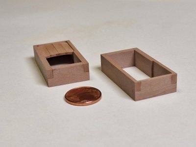

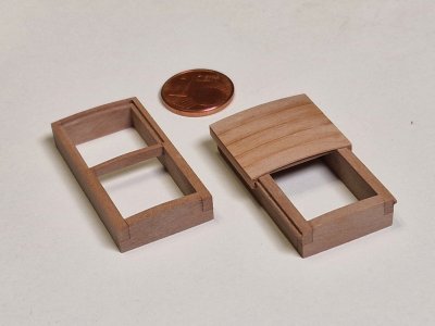

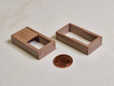

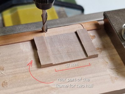

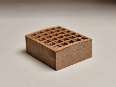

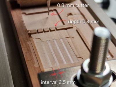

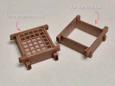

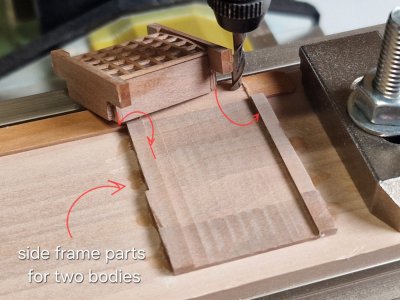

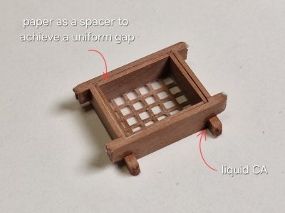

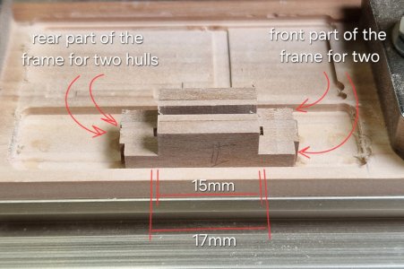

2/2

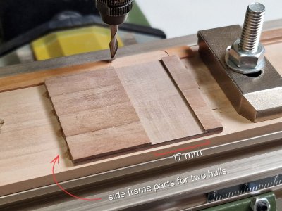

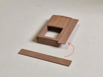

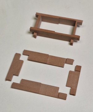

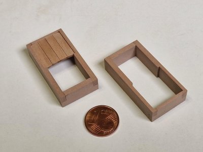

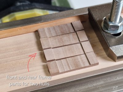

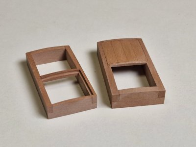

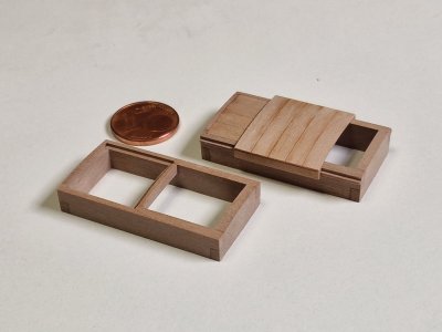

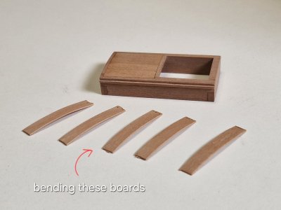

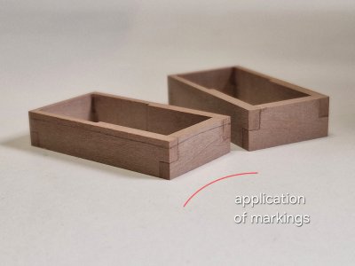

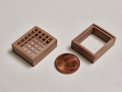

In this part I will make two skylight frames for two hulls.

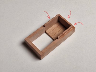

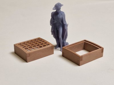

I'd like to clarify that these details are not yet complete. We still need to make the bolts and dowels, fake hinges, and adapt the surfaces to the deck.

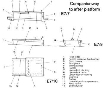

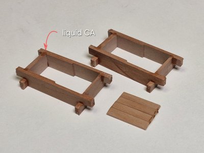

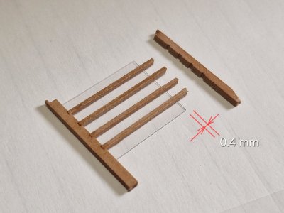

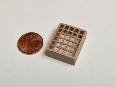

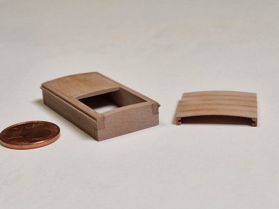

5. Gangway (companionway to after platform)
1/3

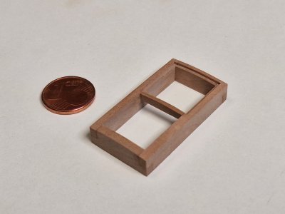

One of the most interesting parts, not as complicated as the previous ones, but there are still some manufacturing challenges. I plan to make the doors slide and be able to be either closed or open, but that's for the next part. In this one:
I still make two copies for two ships, but as everywhere there are some differences, but for now everything is unchanged for the two variants.

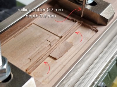

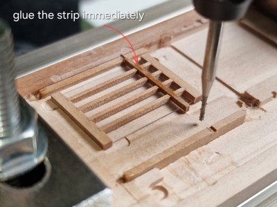

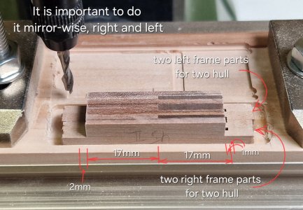

I milled with a 3 mm cutter (for speed), the depth was 1 mm and this is important.
This is NOT the finished ladder yet. There will still be parts in the middle section and, naturally, sliding doors... but that's in the next part.

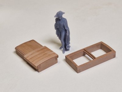

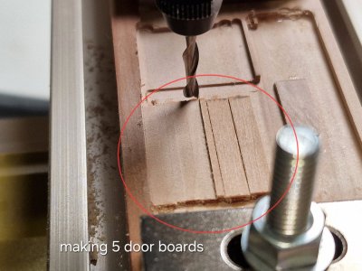

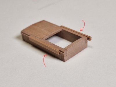

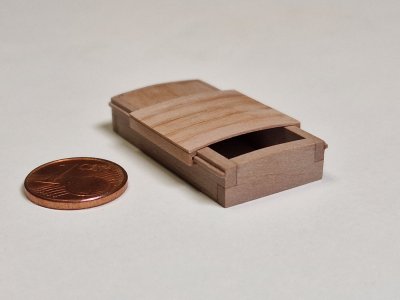

3/3

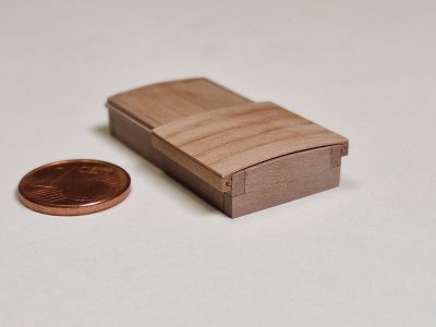

In this part I will show how I made a working door and it was very interesting. :cool:

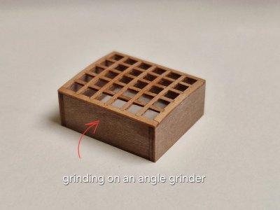

The guides are cut slightly larger than the required size and ground on an angle grinder.
And as I already said, the door is fully functional and can be in any position, both open and closed.
The ladders are not yet completely ready (they still need bolts and nails), but the final appearance is almost complete.

Thank you for such a high rating, and this time I'm also glad everything went as planned. I wanted the door to work, but I was prepared for the possibility that it might not. One thing I can say is that a milling machine really does work wonders, the main thing is to calculate everything correctly. Thanks again for your feedback.
