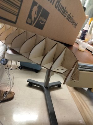

Having been denied the use of my plank bending iron I didn't get this area round enough using only water as an agent.
Consider this another one of those learning lessons. Next time, fill in any areas where you suspect that your planks may go flat, without heat and proper forming, with balsa wood blocks or foam blocks. Fair the block infills just as you'd fair the bulkheads and your wet forming of planks/laying those planks will work. It's an extra pain, but those faired blocks between bulkheads will easily support the needed shape of your planks below any unfriendly areas such as you are having issues with. The below image is using balsa, but you can use whatever material best suits you.
To better bend your planks at the bow, you could cut them about half through multiple times with a scalpel-like cutter, at +/- 5mm distance betxeen cuts. Even when dry, they bend nicely that way, but dont forget to dab them liberally with white glue on the inside when placing them. That way you glue all these little parts together so you can sand them later on the outside without the whole plank falling apart.

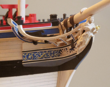

Is the black strake in your photo a wale? There may have been exceptions, but I am pretty sure wales tapered in thickness as they approached the bow so they could be seated in the rabbet the same as the other planking rather than sticking out of the rabbet. In the contemporary planking exapnsion drawing below you can see the smooth line at the rabbet of all the planks, including wales and thick stuff above and below the wales.
That photo is from MThomas and not of my model.
