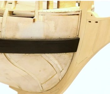

To better bend your planks at the bow, you could cut them about half through multiple times with a scalpel-like cutter, at +/- 5mm distance betxeen cuts. Even when dry, they bend nicely that way, but dont forget to dab them liberally with white glue on the inside when placing them. That way you glue all these little parts together so you can sand them later on the outside without the whole plank falling apart.
Having been denied the use of my plank bending iron I didn't get this area round enough using only water as an agent.
Consider this another one of those learning lessons. Next time, fill in any areas where you suspect that your planks may go flat, without heat and proper forming, with balsa wood blocks or foam blocks. Fair the block infills just as you'd fair the bulkheads and your wet forming of planks/laying those planks will work. It's an extra pain, but those faired blocks between bulkheads will easily support the needed shape of your planks below any unfriendly areas such as you are having issues with. The below image is using balsa, but you can use whatever material best suits you.
