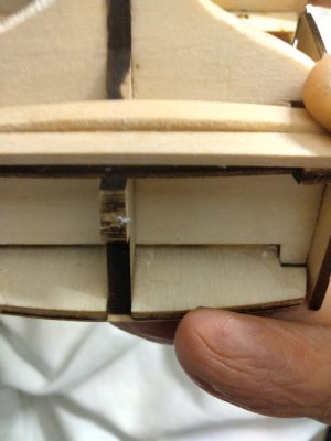

Yes, it's just like you say, sand down the bits with the orange x-marks so they blend into the keel part..... On the paper instructions, on sheet D, the third photo along gives a reasonable idea of how to fair those blocks at the stern. (You need to remove so much material that it's better to sculpt it with a hobby knife to start with.)

If you sand too much, it will become obvious when you lay a plank atop that bulkhead, but no biggie. Just add scrap pieces of wood to build up the low bulkhead and fill in the gap, fair your built-up bulkhead(s) until the loose fitted plank shows a nice fit, then proceed as usual. This might change the geometry ever so slightly, but who cares. Nobody will ever know but 'you'! ;)

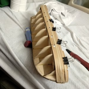

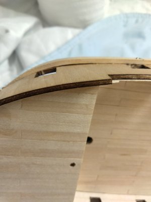

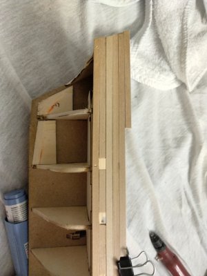

I'm working on the stern. When I go to install the second plank it is jumped in the middle from the false keel. Should I glue it in place.like.thisnthen sand.thebresulting plank or grind down.the keel first17750065977359128954822629832598.jpg
Sand the keel down first so that plank lays flat, and makes a nice smooth continuous run with that first plank.
