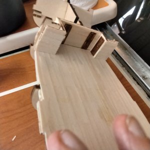

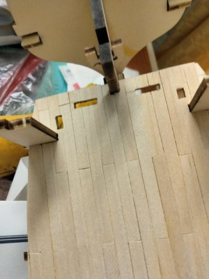

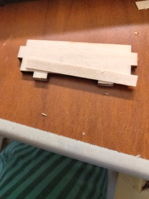

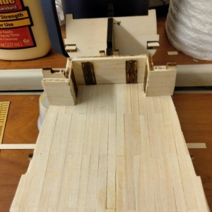

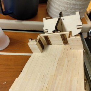

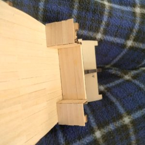

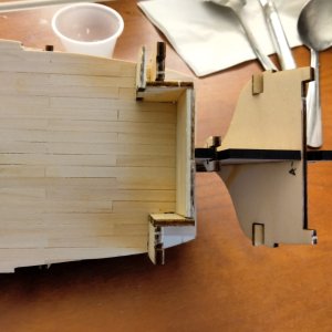

I'm having a wonderful time building this Beagle. I'm starting the recessed deck walls at bothe ends. I'm going to plank them before installing them to make it easier. 17743690796807204398411685629509.jpg17743691054348838836214817582090.jpgI
Yes, my preferred method here is to dab some pva into the cracks, then immediately sand the timber, and the dust will stick to the pva in the cracks. Instant filler.
Bear in mind that by the time you've finished the model, there's so much stuff on the deck that you won't be able to see much of it anyway. No need to overthink this stage.
Full steam ahead!!!

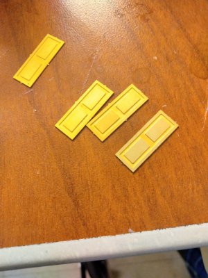

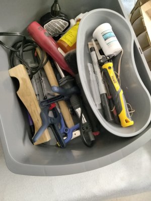

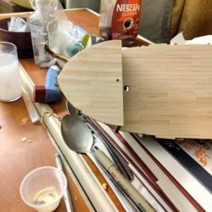

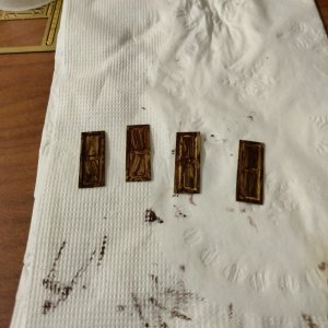

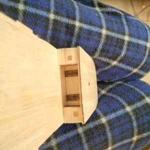

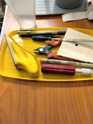

I d run into my first problem. The doors are photo etch. I can't leave them brass but don't really have anything to finish them with except some acrylic paint on tubes. I have the basic colors of ochres and siennas. If I wait they won't be accessable because they are recessed. I have no experience at doing fake wood finishes but am thinking to.do some.soert of a base coat followed by maybe drybrushing a top coat to get some sort of a grain pattern. I can sort this out while I'm fairing the hull frames. The first two photos show the full extent of the tools I'm building with.17744876022666038192653119254603.jpg17744876420842543856780757540835.jpg17744875349273890930056261001011.jpg
I d run into my first problem. The doors are photo etch. I can't leave them brass but don't really have anything to finish them with except some acrylic paint on tubes. I have the basic colors of ochres and siennas. If I wait they won't be accessable because they are recessed. I have no experience at doing fake wood finishes but am thinking to.do some.soert of a base coat followed by maybe drybrushing a top coat to get some sort of a grain pattern. I can sort this out while I'm fairing the hull frames. The first two photos show the full extent of the tools I'm building with.View attachment 586780View attachment 586781View attachment 586779
Hi, you could build nicer ones from 2nd planking and deck planking stock.
I remember thinking the same at this stage- I fussed around with a fake wood finish. But in the end, when you've added all the deck fixtures, masts, ship's boat, rigging... you can barely see any of these doors anyway.
Different modellers have different attitudes to this stuff, some people spend days, or weeks, on details that will never be seen- for the sheer joy of it and the satisfaction of a job well done. I say: if it can't be seen, it's not worth worrying about it. If you've got the Occre paint set, I'd paint the doors with their ochre, which is light brown, then make up a darker shade mixing a touch of black with some ochre, and paint the panels and surround of the door with the darker colour. It won't look brilliant, but then you can push forward with the rest of the build.
I felt the same with the stairs, which are brass... I just painted mine ochre and shaded them with a bit of darker brown. Maybe in future, I'd buy more paints and learn wood-effect finishes, but it's definitely more fun just pushing ahead with the planking and hull finish than getting bogged down in these details.
Once again I'll follow your advice and use what I have on the hand to keep the build going .

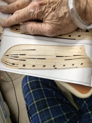

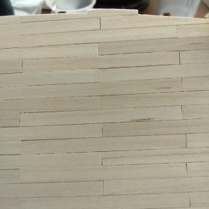

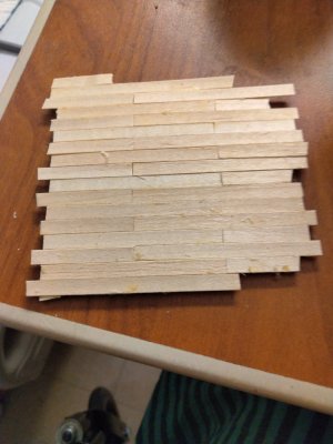

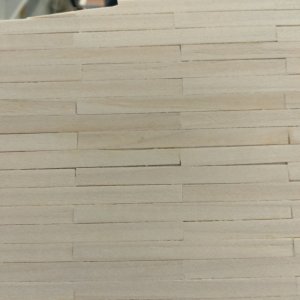

The instructional photos provided sho17745766269298734230570127791281.jpg17745766793618606693067588735019.jpgw a method of planking the hull I've never seen before. I don't see much, if any, tapering of the strakes. There a quite a few strakes that taper to a point without ending at a frame. What do you guys think?
The instructional photos provided shoView attachment 587152View attachment 587153w a method of planking the hull I've never seen before. I don't see much, if any, tapering of the strakes. There a quite a few strakes that taper to a point without ending at a frame. What do you guys think?
Not much. Better treat you first planking layer as a welcome practice ground for the final one, do it as good as you possibly can instead of just as fast as possible. It's a nice and slow hobby, not a speed contest!
