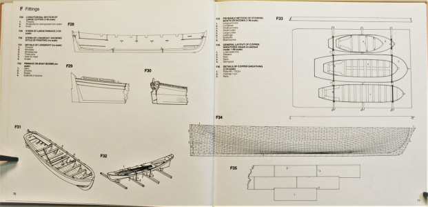

Do you have the book? If not I would recommend it for your build
Taken from my book review, you will find information about the boats

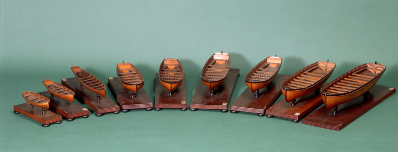

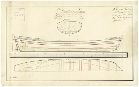

In addition you can check all the available contemporary drawings at the NMM
I made here a short research for "pinnace" and you can see a lot of interesting drawings, whcih will help you in addition
f.e.

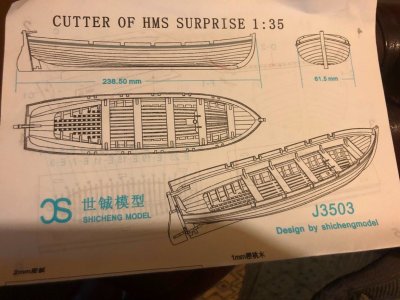

I have built a couple of 1/35 scale ship's boats from the kits by Shicheng Models. I don't know what scale your Bellona is, but if you can find the kits on the internet you may find one or two matching your requirements, and they would be useful for scaling down to produce a scratch built boat.shicheng.JPG
Thank you for the info the model I am going to build would be 32 inches in length I have the book 74 gun ship Bellona our model is going to sit on top of HMS venerable a large model built by Sunderland maritime heritage
