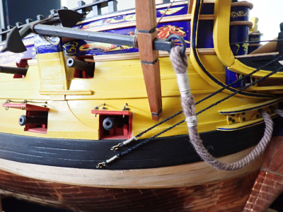

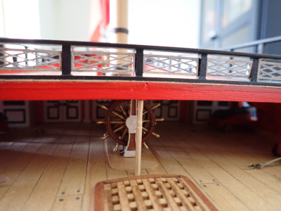

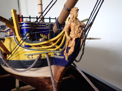

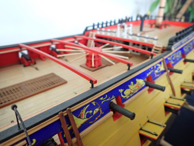

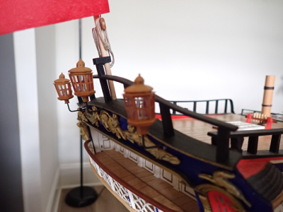

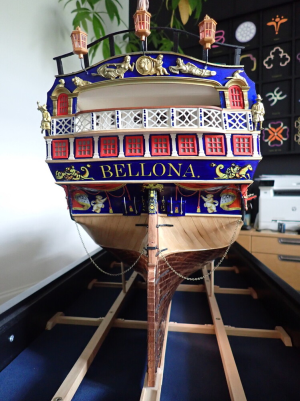

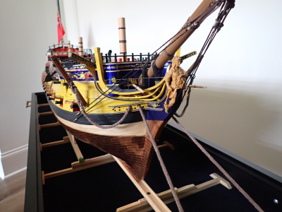

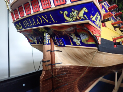

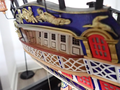

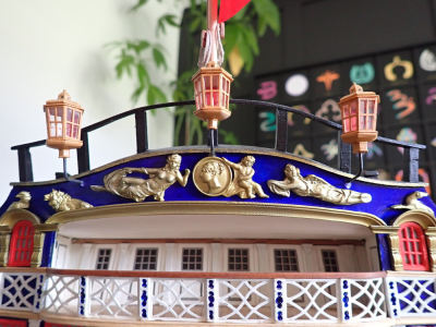

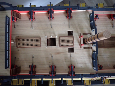

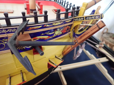

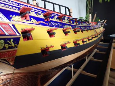

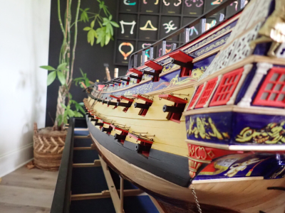

48 pages of extreme detailing and more than 54,000 views are what I remember of the original thread posted on the defunct MSW 2.0 forum. Describing again the complicated and tedious assembly of such a kit is impossible as I did not keep any pictures or document. I will simply post a few information from the CAF Model web site.

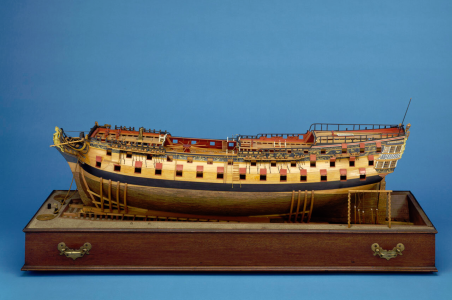

The Bellona kit comes in five installments (or sessions), which makes it very easy to spread the expenses and to stall the construction if you feel like it will not be possible to complete it. I started with the first session and after some surprising and encouraging success, I quickly acquired the other four sessions. In fact, it is not possible to go beyond the first session without the other ones, as some delicate decisions and assembly questions must be solved with parts included in Sessions 3, 4 and 5. The kit is presented in "Admiralty" fashion and has no rigging or masts, besides 4 stumps of dowels provided in the kit. The model is a smaller copy of the HMS Bellona model (1/36th) located in the National Maritime Museum in Greenwich, London.
Some of the CAF model characteristics are:
Scale 1/48

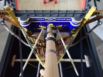

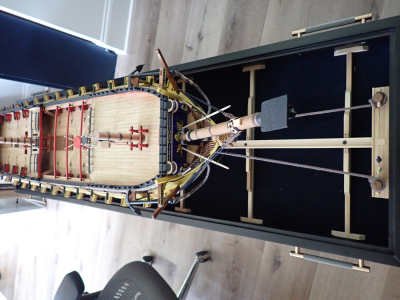

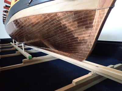

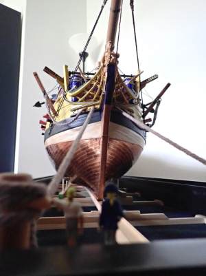

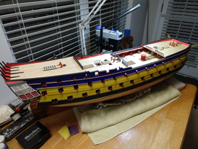

My finished model weights about 25 pounds, which makes it hefty and heavy. The length of my model was increased by one foot, due to the bowsprit that I built. It took me about 2 years to complete the model and its stand.

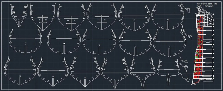

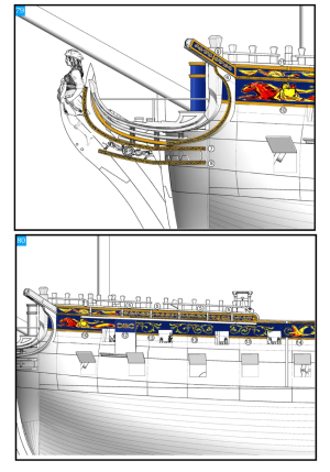

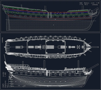

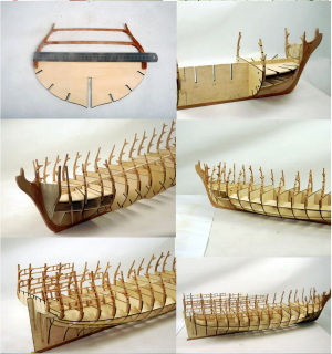

Session 1 comes with the following plan and is all about building the frames and keel:
Once you are done with Session 1, you have in your arms a heavy baby of close to four feet long.
More to come.....
Yves
