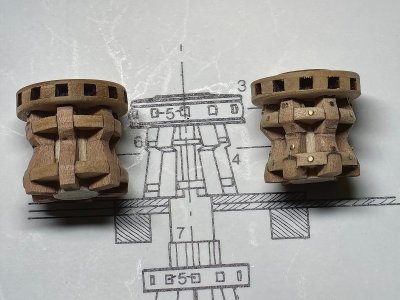

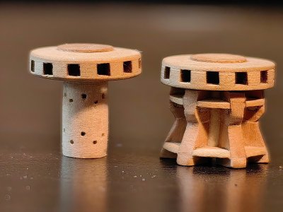

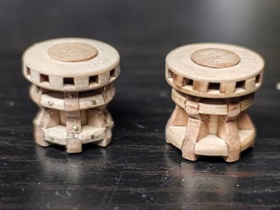

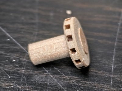

Some time ago, I made the capstans for Bellona.

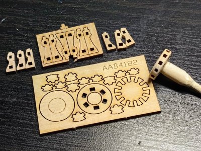

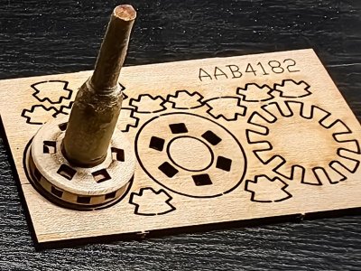

I wasn't very satisfied with the result, and I thought about redoing them. Recently, I purchased two sets for making capstans using laser cutting.

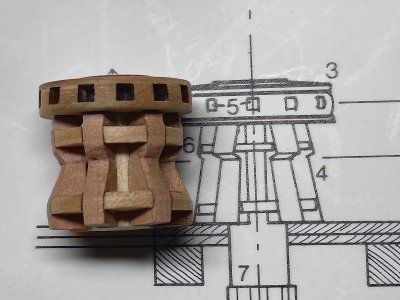

The problem is that are much taller than necessary and have a larger diameter Drum-head . I decided to reduce them to fit Bellona at 1/100 scale. After several hours of work, I achieved my goal. I needed to reduce the height of the whelps while preserving their upper and lower parts. I cut them, removed the middle, and glued them back together.

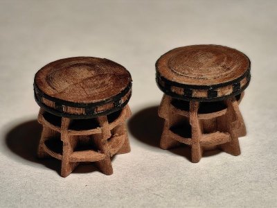

The first capstan didn't turn out very well, because I cut and glued the whelps separately. It was challenging to achieve parallel edges and uniform size. The second one was easier. I also cut the whelps, but I assembled the upper and lower parts of the structures separately. Then, once they were assembled, I polished the edges before clye it. After assembly, I clamped the workpiece in a drill machine and used sandpaper to finish the shape. According to the pictures, I inserted pins made of brass wire into the first capstan.

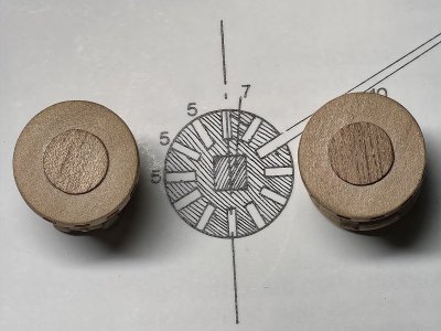

I didn't like the look of the pins, so I didn't install them on the second capstan. I made the height of the capstans and the diameter of the Drum-head according to the drawings from Brian Lavery's Anatomy of a Ship.
They turned out to be larger than in Corel's drawings, but I believe this is more accurate. They also look more substantial than the original design. The first capstan, which turned out to be worse, will be located under the quarterdeck. It will hardly be visible. The second one will be on the open part of the main deck.
Yours sincerely, FriCap

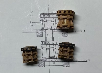

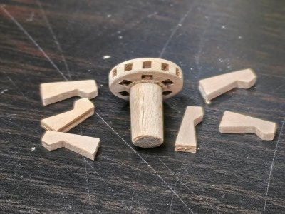

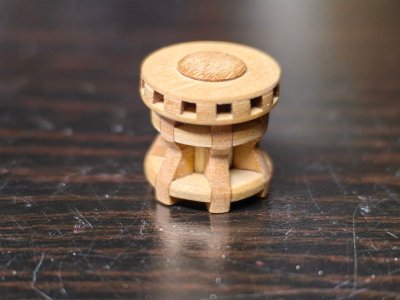

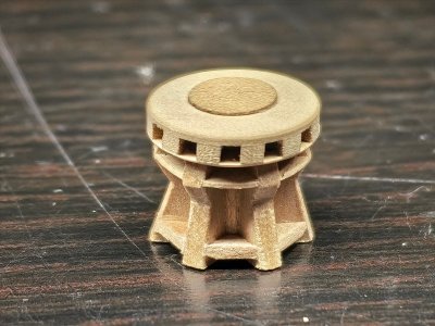

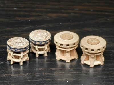

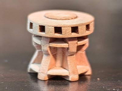

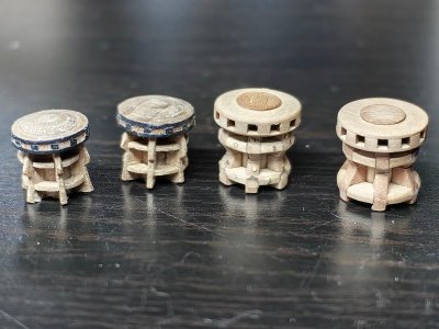

I decided to redesign the kabestans again. Fellow modelers pointed out the discrepancy to the prototype.
Cheeks should be much thinner than whelps. I redid the first capstan without disassembling it. The upper cheeks were carefully trimmed with a knife, and the lower part was ground on sandpaper, and then the lower parts of the whelps were glued. I've completely disassembled the second capstan. I'll remake the whelps and cheeks. Then I'll think about which one to install where... Although the capstan, which will be under the quarterdeck, did not make much sense to redo. It won't be visible anyway). But when I attached the quarterdeck, I found out that 14 mm of height, as per Lavery's drawing, was too much. The quarterdeck was almost touching it. So I made it 1 mm lower.

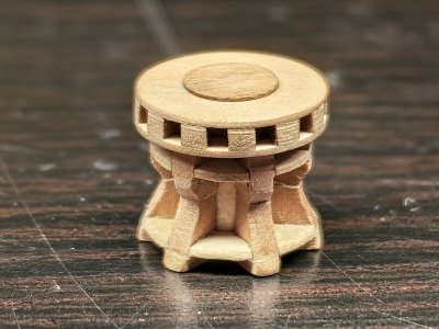

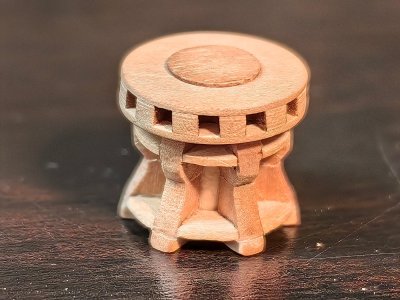

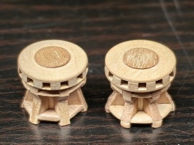

Hello everyone!
I have redesigned the second capstan. In fact, I had to practically make it from scratch. Even the barrel had to be made new, as the old one had holes from nails. Only the drumhead remained unchanged. This is the second redesign of the capstans. The photos show the difference between the new ones and the original version. During the construction process, I am studying various information about ship design and modeling techniques. Some of the details that I made some time ago no longer appeal to me, so I am changing the design. Unfortunately, some things can't be changed, as it would essentially be building a different ship. Well, hopefully the next model will be better!)

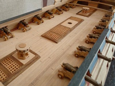

Hello everyone

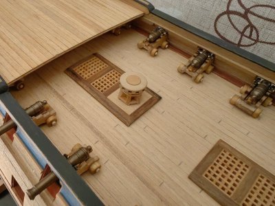

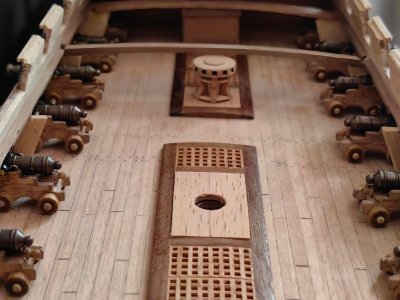

Before installing the quarterdeck, it was necessary to install the deck equipment and the cannons that are located under it, as access to this space would not be possible later. Since the area under the quarterdeck would not be visible, I simplified the details. For example, I did not complete the full binding of the cannons. I did not install the rings and hooks, but simply simulated them. Additionally, I used a thread from the kit, which had poor quality. These were done for practice purposes. I want to equip the cannons that will be open for viewing in a better way. To simulate the nagels that hold the deck boards, I bought a brown marker with a line thickness of 0.2 mm. The result is still not perfect. The size of the dot depends on how hard you press. I decided not to clutter the deck with this pattern and only simulated it at the joints.

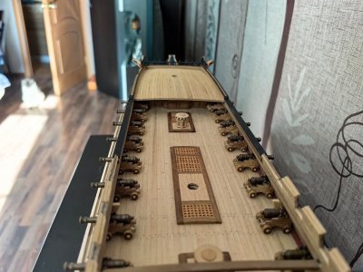

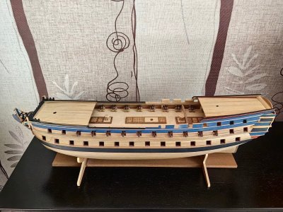

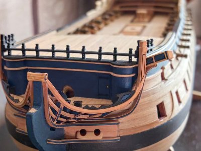

The next step after installing the quarterdeck is to lay the decking boards. When I did this on the main deck, the poop deck, and the foredeck, I didn't join the boards together like I did on the prototype. However, after observing the work of other modelers, I decided to include this feature. On the main deck, I made transverse cuts in the already installed decking boards, but here, I decided to separate the decking boards immediately. To keep the layout even, I decided to first assemble all the slats into one package, cut them and then immediately glue them to the base. I used masking tape for this. It turned out much faster, but I didn't really like the result. Perhaps the imitation of nagels and the installation of deck equipment will improve the appearance of the deck…

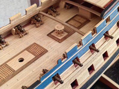

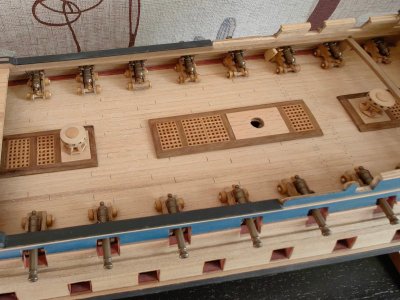

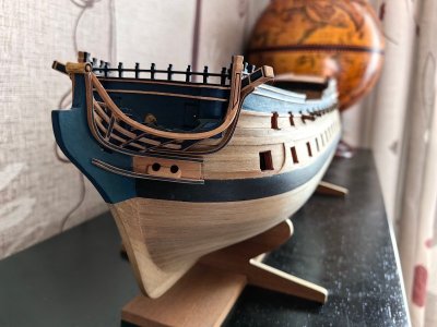

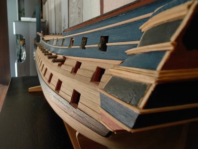

After installing the quarterdeck and lining the inside of the bulwarks, it became possible to align the row of gun ports. It turned out that the three aft ports on each side were lower than necessary. I had to install planks from below and cut off part of the bulwark from above to make the guns fit properly. That's how it turned out.

It is going to look beautiful, FriCap!
A general question, especially for our experts; I notice on several ships that the cannons are also secured with a thick cable. Are those proportions correct, or could that thick cable be a bit thinner?

You obviously mean breeching tackle? This is a tackle to hold the gun during recoil. It also presses it to the side during rolling. It was made of a shrouded cable, the thickness of which for guns on the main deck could be 7-11 inches. In a scale of 1:100, the thickness of the thread should be less than 1 mm. But in such a small scale, for better visualization, you can slightly increase small details. To be honest, I didn't bother and took the thread that was at hand. This is about 1 mm. It's not visible under the quarterdeck anyway) As I mentioned earlier, I will carefully select the details for the elements that will be visible. If I have made a mistake in estimating the thickness of the breeching tackle cable, I would appreciate hearing from experts.
