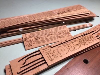

I have recently purchased the Blandford plank on frame kit in African pearwood. It’s an admiralty style model with exposed frames and stub masts. She is a 20 gun frigate and a sixth rated ship. I ordered the kit through Drydock models and was pleasantly surprised to receive the model down here in Australia 10 days after ordering. Excellent service.
I will not go into details about the kit contents as that’s been covered my multiple other build logs on this forum. I would say I’m very impressed with the quality of the timber, and the laser cutting of pieces are perfect. There’s no scorch marks on the wood which has been my experience from other manufacturers in the past.

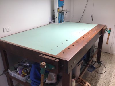

Anyway, to begin my build log, here is my workbench which is 1.2 metres by 1.8 metres ( 4 foot by 6 foot ) and it’s of an Australian hardwood timber called Jarrah and marine plywood, with 2 vices mounted.

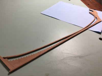

Hi Allan,
the stem (cut water) and keel has not been tapered by the manufacturer, but I shall endeavour to do that myself. As for instructions, there’s none but I found it helpful looking at the YouTube videos of HMS enterprise by the same manufacturer. I could deduce how things are assembled with those videos.
