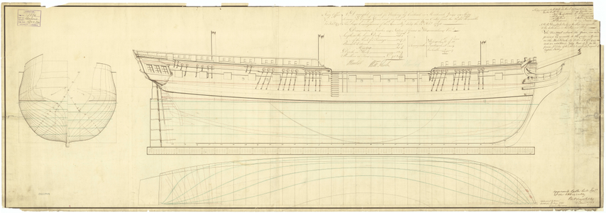

I just bought a new project HMS Diana 1794 scale 1:16, i bought this from china and there is no plans or instruction and missing lots of parts. So instead of trash this a will build this model and make my own parts, i just started to print all cannon barells in 3D printer, i will use the skeleton from the kit, but almost all other parts i need to remake.
So i am hunting for a buildning plan from a other brand in same scale so i have somthing to look at, anyone have one in pdf or know where to buy one ?

There is a Anatomy book available, which will help very much
and maybe also interesting for you

If anybody built Diana in scale 1:64 i would be happy to know then curv of the deck. lowest point midship to highest point on stern and bow

Take a look at this research - there are several offers of used Anatomy books less than 50 US$ - starting with 25 US$
Here is one for 20 US$
but off course check the postage costs

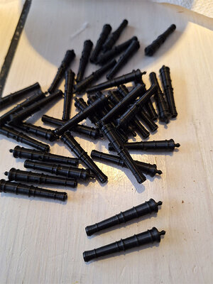

Finally finished the 38 barells in the 3D printer, the quality was better when printing one by one. Next the carronades.. then painting and make them look old.

Is there a stl-file available, somwhere, somehow?
Would like to do some barrels to, but did not find one to my likings. Yours are...
