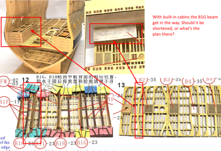

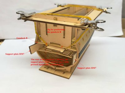

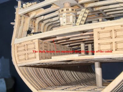

I guess you mean whether you need to sand down the parts of the beams protrude the bottom of gun deck B? Don’t worry about that. You can just place deck B on the cabin, and then, following the manual, use a jig to accurately locate the gun deck and then glue it to the inner hull. It's only at this point that you need to think about whether to adjust the bottom of the deck. Usually, it doesn’t need to be sanded.@Unicorn models
With built-in cabins the B1G & B1I beam get in the way. Should it be shortened, or what's the plan there?
