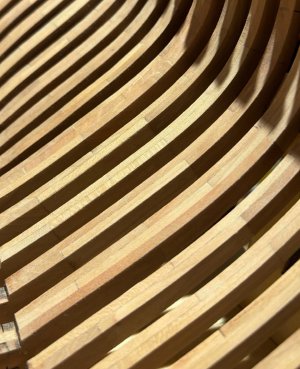

Good morning Gentlemen. I fixed the deck clamps to the inside of the frames. I decided not to bash the kit and include the lower decks and details. The way the kit frames are designed and presented I prefer the look through appearance than having this cluttered with internal details. So only the upper deck clamps are fitted.
These have been the most tricky and consequential part worked on thus far…..eish I hope my measurements and placement is good.
Nailing: I’m only going to add nails and treenails to those parts which will be seen after completion. These nails seen on the clamps are for fitting purposes and will not be visible…e.g:
I have been slowly sanding the inside and added the keelson. I did nail this. The British ships used metal nails on the keelson and I have used 0.5mm brass. The nailing pattern is not 100% but pretty good.
Plenty more sanding to go. Cherry wood frustrates me a tad. It sands/scrapes up to a lovely colour but then darkens rather quickly. What you see after sanding is not what you get. Cheers Grant
View attachment 515425View attachment 515424

Sanding, nailing, more sanding …… the lovely life of a PoF-builder. Nice work, Grant. She shows here lines more and more.

Hi Peter. Yep sand and more sand. I’m not planking the inside of the hull so once the frames follow the planking line from a presentation view I will have reach my objective here.

The result is impressive. I like these ribs.

I see your point, but Cherry is sure a nice wood to look at. My smaller Enterprize is pearwood.
Hi Jack. Perhaps it will stabilise and look really good once it is oiled or treated. I have no idea how the wood will change with some oil or poly as this is my first venture with Cherry.Maybe it is time to find out:D. Cheers Grant
