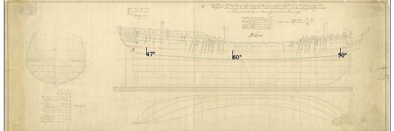

Some of my research: Frigates only have one set of main wales which do not follow the deck sheer. My instructions show these following the deck sheer. According to Goodwin “ The wales were not laid parallel to the gundeck but to the designed sheer of the ship.” I’ve looked at other builds and diagrams but cannot find the “designed sheer” of frigates from this time. They all seem to follow the gundeck? Maybe the wales Goodwin speaks of are for ships with multiple wales e.g the Victory?
Very few ships, if any, have wales and planking that follow the deck sheer. The wales and hull planks follow the same basic sheer. It varies slightly as the strakes become less broad forward, but basically the sheer of the planking has no relation to the sheer of the decks. The below is the contemporary drawing of Enterprise (28) 1774 and I marked the difference in distance between the top of the wales to the top of the upper deck planks. The gunports follow the shear of the deck so can also be used to see the difference. You can see there is a variation of over a foot between the wales and deck sheer
Hope this helps
Hope this helps
Thank you Allan. It helps plenty- much appreciated. Cheers Grant
