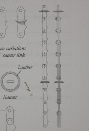

You have far more patience than most of us :) :) but if you want to go for it, the below is a picture from TFFM Volume 2, page 101 on the chain and saucers that might be helpful.
Thanks for this Allan. Wow that makes it even more complicated...Thanks I think ROTF. Cheers Grant
