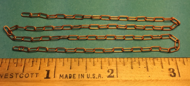

Maybe it would be better to keep it simple and use brass chain with elongated links. There are other sizes, the one below is just as an example. If you decide to duplicate the actual shapes I hope you show us how you do it, be it photo etched metal or plastic links or whatever you wind up with. This is getting really interesting..... :)

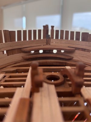

Good morning. Ricochet rabbit at it again. My cad design for the chain pumps and my wood supply for the wales is taking a while so I decided to do some wood work again.

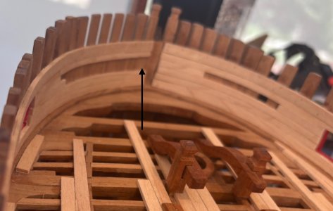

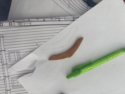

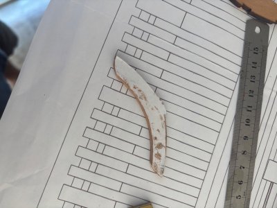

The kit does not have the upper breast hook and bolster so I decided to try and make these.
Trying to find scraps of cherry wood is the problem.

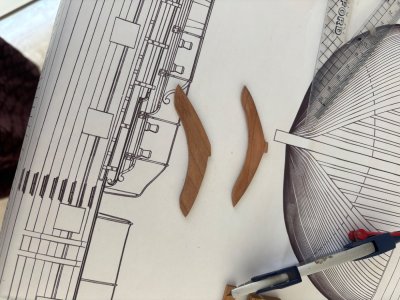

My design leaving gaps etc (as shown by the arrow) made this a little bit of a challenge as I had to make each side differently so it fits.
The upper breast hook.
Now to try and find thinner wood for the bolster…..hmmm. I may have to glue some pieces together. Let’s see…

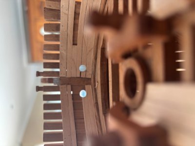

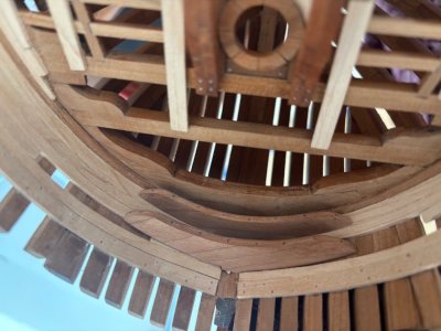

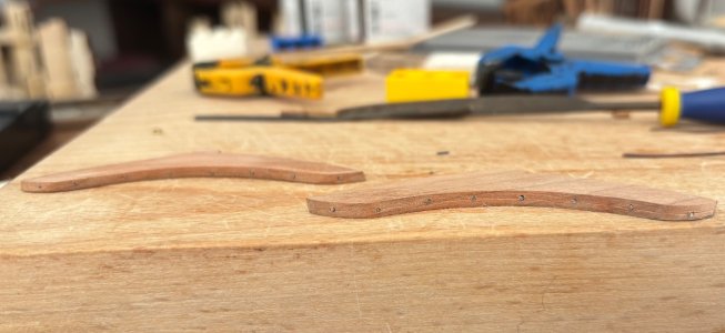

I did manage some more work on the Hawes holes, upper breast hook and bolster. It Was rather fun - being very tool inefficient I cut and shaped these with my dremel. Was interesting getting the symmetry. To reduce the width of the bolster I did some fun sanding by hand. They turned out not bad.

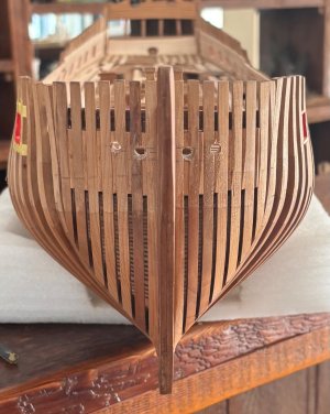

Hawes holes I took a big drill to my ship- full throttle Grant. I’m still busy so all looks a bit of a mess.
WIP photos: - nothing fitted.
The Hawes holes are not sized yet and the outer ones still need another size up drilling.
View attachment 555770View attachment 555771
View attachment 555772View attachment 555773

I always enjoy looking at your work. I know what taking a 3/8's drill to a ship model feels like, one slip and all that power could do some real damage.

Good morning Gentlemen. I don’t like doing a group response however I will just respond to each of you the same. Thank you kindly for the compliments. I delayed making the Hawes holes for a long time as I was a little nervous about messing these up. Firstly the measurements as I had a chance of getting these out by even a half a mm. No electronic tools in Grants shipyard…..I also traced the the holes from the drawings but had to adjust for curve of the bow vs a flat drawing. I started with a small drilled hole and needle files however this became a “watching paint dry” experience. So…..boom the big drill came out. It did damage my inner planks a little bit but nothing I can’t fix.The final finishing will be done with files and sand paper. Maybe I got lucky;).

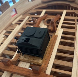

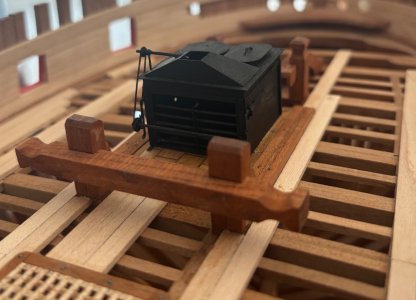

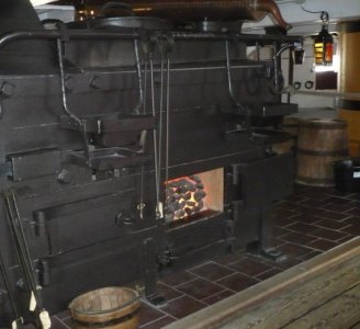

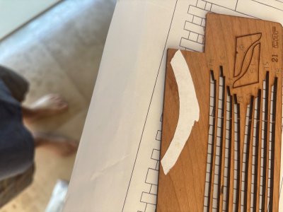

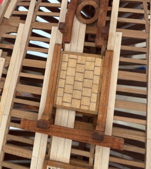

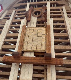

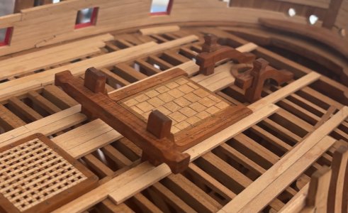

The heat tiles/bricks for the stove. I used the picture below as a reference.
I scratch build this and had to use walnut instead of cherry wood for the frame as the kit is really stingy with the wood supplied. It is not glued in yet.
I was going to stain the tiles a clay colour however they jump out at you too much.
I put the INCOMPLETED ROTF stove on :
