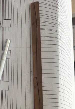

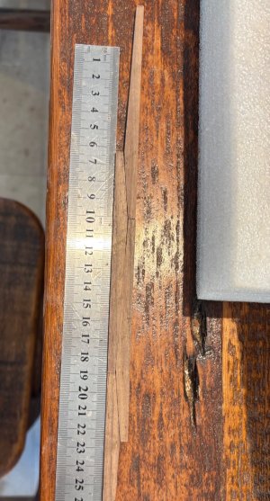

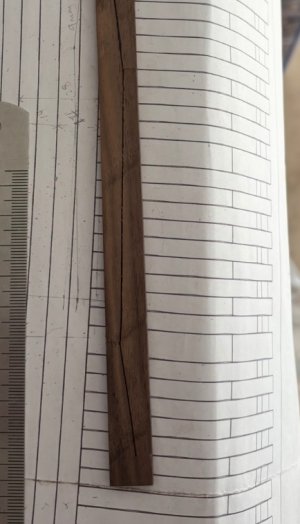

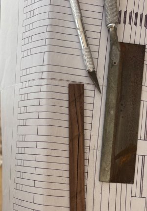

Good evening. I bunked the office today and attempted to cut wood for top and butt planks for my wales.
OH boy - it is a bit of a hack.

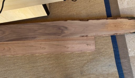

I bought some walnut and cherry off cuts:

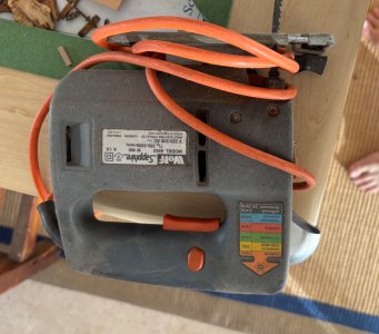

I cut with a jigsaw (a big oneROTF) into 300mm x 20mm strips or there about ROTF. I used my mini table saw to trim these down to 300mmx14mmx3mm. Luckily I have plenty blades I can see me shredding a few.
Nice toesRedface.
Now the hack part…..I used a xacto blade and hand saw to cut the top and butt pattern.
My first attempt:
If I can’t get these right I will have to resort to the kit planking for the wales.
Close ups :
Cheers Grant

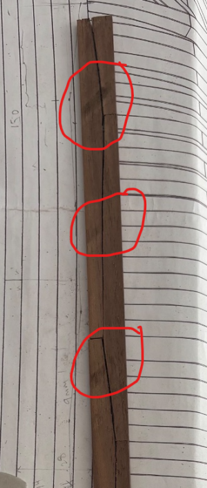

Close ups :
View attachment 559400View attachment 559401

Processing those by hand is no joke, Grant! Well done!
A tip: don't fall in love with the fit until you get them on a curving ship's hull. There will still need to be some finessing.
Well done Grant! That's not an easy task with an X-acto because the blade always wants to follow the grain of the wood.
My only comment/suggestion/criticism would be to try and make each plank separately rather than make matching planks from the same strip of wood. The reason is that any figure that spans across two planks will reveal that they were cut together and make it look like the joint was just scored into it, disguising all the effort you put into cutting them out and fitting them together. It will make them look like one of those one-piece decks with plank lines laser-etched into it and any cross-grain dark streaks going all the way from one side of the deck to the other across plank joints. Very unnatural.
True story, but Just swap a few pieces around to mitigate that concern. As Paul said, you can perfect the fit once they start to go on the hull
There is a scratch builder in you. I see you shed growing with tools
I’m still finding my scratch feet Stephan. Making these made me realize I have some way to go. My tool shed definitely needs some decent modeling additions as my hand skills just don’t “cut” it;). It is much more fun scratch building which to me is always the defining factor. :D. Cheers Grant
Good morning Paul. True story and thank you. I really enjoyed hacking that plank of walnut tho. Getting that plank down to 3mm was entertaining and any carpenter would be shaking their head in dismay. ROTF.
Thanks for the tip. I did not consider that and at least I’m expecting it now. Some more entertaining moments ahead. Cheers Grant
Good morning Russ. Thank you for this post. I did attempt to make each piece individually however that was like a comedy show- a very poor one. My hand skills are not up to scratch;). My X-acto blade was not cutting through so I finished with a hand saw. I glued some scrap wood to the underside to keep a straight line however even with this assistance it did not keep my pattern or a straight line of the individual pieces. Some decent tools need to be added to my shipyard……negotiations with the Admiral are required ROTF.
Maybe if I gently scrape the joining edges it will make it look like they were individually cut? Let’s see. I have plenty of wood for redo’s and to play some more.
I think the dark “cross grains” are from my little mini table saw. It is a very cheap one. They should disappear with some sanding.
Once again thanks for your assistance. Cheers Grant

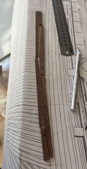

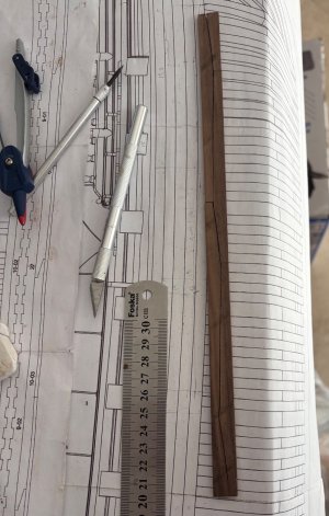

Good morning. Ok so that was a right royal messSpeechless.
I got the pattern wrong and the measurements of each strake totally “cocked up” Hmmm measurements never my strong point.
I decided to take Russ’s (@RussF ) advice of making these individually again. I tossed the knife and saw and used a plane and sand paper rather. I’m Still not getting the edges nice and pointy but a big improvement. I will paint my wales black so maybe these will come out ok.
Attempt no 3.
To quote Shakespeare with some of Grants PL “Some skills some skills my kingdom for some skills! “ROTF
Cheers Grant
