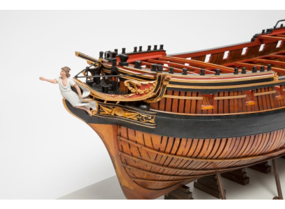

I don't want to hijack the thread, Allan, but Medea (1778) definitely did have knight heads, as can be seen on this contemporary model made by the ship builder, Hillhouse, and now stored in the Bristol museum.
