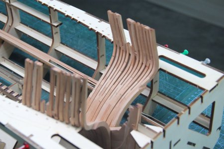

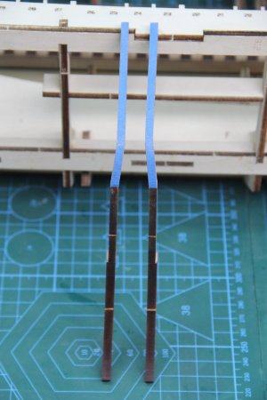

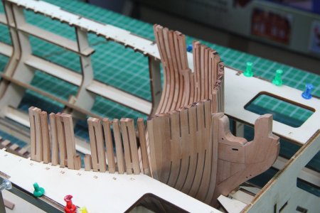

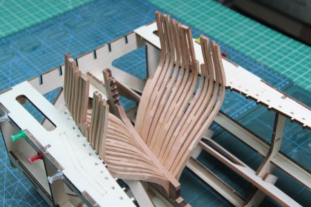

It looks like you have a filler between the hawse pieces and I don't see it mentioned in the instructions. Is that something you decided to add?

That method, from all references I have is absolutely correct, outstanding work.
I did the same with mine.

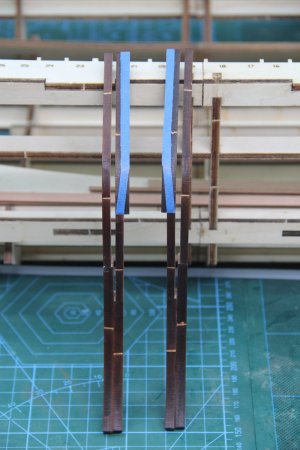

First, I truly appreciate your ongoing attention to my post!!! Due to language barriers and variations in technical terminology across regions, I've rarely responded to comments to avoid misunderstandings. For this, I offer my sincere apologies!!

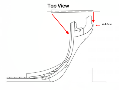

This section was made based on the relevant discussions in the book The Naiad Frigate 1797 by American scholar Edward J. Tosti, and completed with reference to the illustrative content in the book
In a true scratch built the bollards are cut to have no gap and then cut down( milled) to leave air space between them….my understanding and have used this method, not really practical for this kit, thus the spacers
.View attachment 527140
