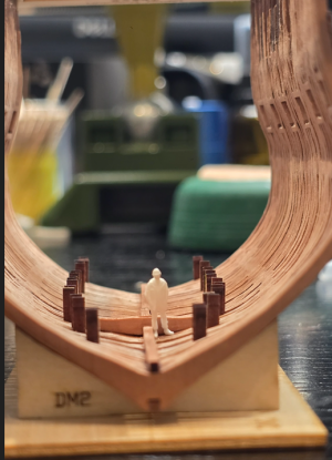

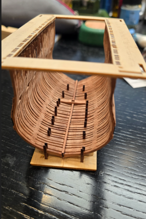

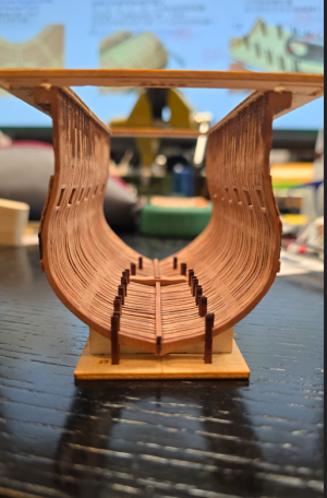

Hey

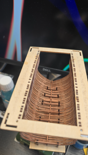

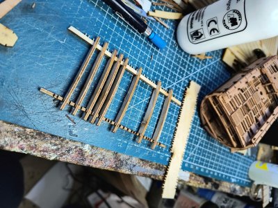

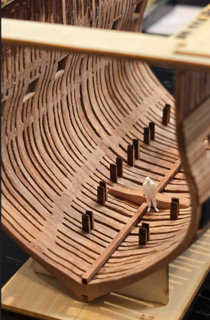

Here I have used the stabilisers for the hold planks. These are used to position and insert the hold planks.
And here is my engineer conducting the inspection. He is very strict, as he is working on behalf of Mr McRoudy... Phew, what a pain in the neck... ROTF

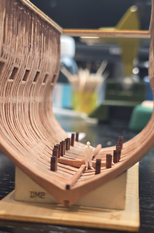

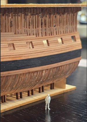

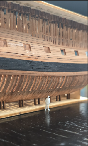

This image gives an idea of the approximate size, height and power of HMS Enterprize ...

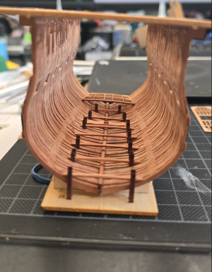

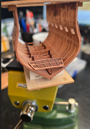

Enclosed is the installation of the crossbars for the hold ... It looks like cargo space ...
Gunther,
Look ahead in the instructions. There are hanging knees under the decks. These will provide added support. Also, If the deck is filed to fit tight, it won't move. You can also tack it with a few discreet touches of CA glue around the centre where it will not be so noticable!

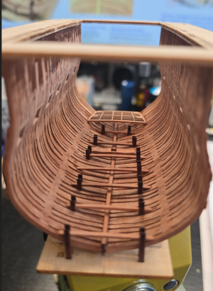

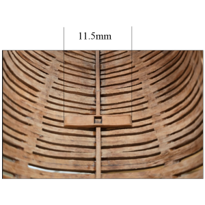

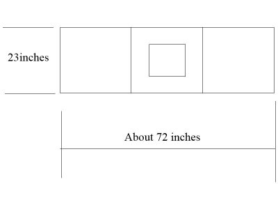

it should be the mast base for the main mast.
The reason I asked is that the well was 6 feet 6 inches athwartships and the step needed to be able to slide on the keelson inside the well to adjust the rake. Hard to tell from the photo but the step looks to be longer than 78". (12.4mm at 1:160) Considering the stantions inside the well, the step would be closer to 6 feet athwartships.
From the contract:
To have a well 6 ft fore & 6ft, & 6ft thwartships, or as the draught shall direct, birthed up with English Plank of 2 ins thick of a proper height above the Ballast & from thence with weather boards, wrought looverways. To have Doors, &c. as usual
The main Step to be sided 1 ft 11 ins and 15 ins deep on the Keelson and of a length to slide easy by the Stantions of the Well.
The sketch of the top view of the main mast step below may be more clear.
Hello Alan,
Hmmm, your question is certainly justified. I must admit that I can no longer measure this, as I have already glued both decks, the lower deck and the upper deck (pictures to follow). Unless you can tell me how and where to measure? It would be best if you could show me where to measure using the photo.

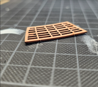

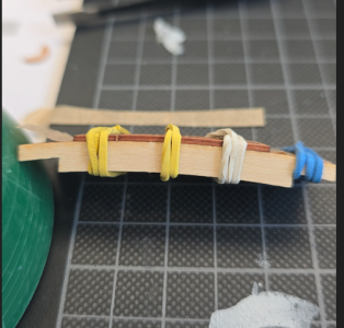

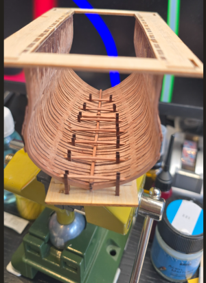

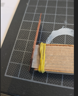

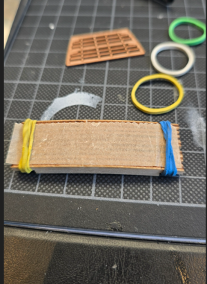

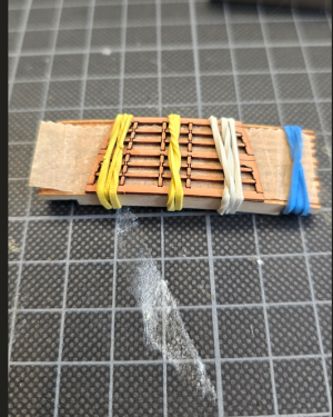

I hope you had a lovely weekend with your loved ones. Let's continue. I had to think about how to glue and adjust the planks for the inner area of the hold. I decided to take baking paper into account, as I love it so much. I took several pieces of wood (FM), as they were supposed to simulate the curvature of the planks, and two rubber bands. Then I formed a surface, placed the baking paper on top and secured it with two rubber bands. Then I moved on to parts D1 and D2. These are the planks for the lower rear hold area. Glue them together. I adjusted both plank parts and checked if and where they didn't fit.
Then I took capillary superglue, which is very, very thin, and glued the two parts together. The advantage of capillary glue is that it is easy to apply and spreads very well. Unfortunately, you have to be careful with the dosage, as you can quickly end up with more glue on the parts than you would like. Another advantage is that it dries slowly. This allowed me to adjust the two parts and attach them to the Fm parts with the rubber bands. The baking paper ensured that I could easily remove the planks after drying. This was very important to me because the planks are so incredibly thin and, as I said, can break easily! :D
In this picture, you can see how straight the planks are. I have placed them upright so that you can see that they are really straight and do not yet have any curvature.
And this is what the planks look like at the auxiliary points (FM). I hope that once the planks are dry, I will have managed to get the curvature right.
And surprise, surprise, I was delighted. My plan worked. I managed to get the curve right!:D

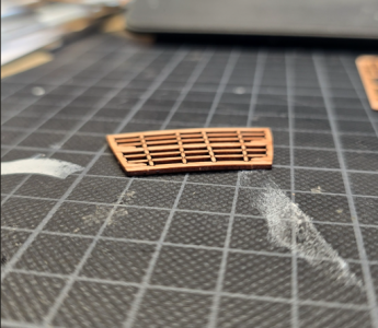

And this is what it looks like after the initial sanding and adjustments, when the planks are inserted.
This was a little update, and I hope you like it!
View attachment 560778View attachment 560779
View attachment 560781View attachment 560782
View attachment 560783View attachment 560784
View attachment 560785View attachment 560786
A very nice procedure to get the curve in those fragile ‘sandwich’ parts, Günther. Thanks for showing the ‘inbetween’ steps.
As you have most everything in place I would leave it alone. Did you put in the well and shot locker? The dimension below is at 1:160 scale. I cannot tell from the photo what the dimension is, but it looks quite long.

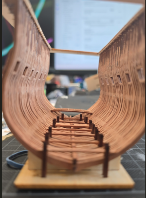

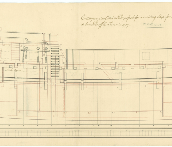

Can you explain what the below are? There were no beams between the forward platform and aft platform when she was a fighting ship so I cannot figure out what these are for. There were beams for an additional platform installed when she was converted to a receiving hulk. Thanks
Drawing is as a fighting ship.
Midships platform as receiving hulk below. Note that the mast step, well, and shot locker were removed when converted.
Cheers
Hey Allan, :D
Nice to see you here. Regarding your questions: Yes, you're right, the mast foot is definitely larger than 11.5 mm. I think it's at least 12–13 mm long. Unfortunately, I can't measure it exactly anymore. The question came too late!
Regarding your second question, I can only say that the beams are supposed to reflect the lower beams of the hold. These seven beams are also noted on the plan of the HMS Enterprize. I decided against building the ammunition box because I can't really see it when I set up the model. It was just a thought of mine. But I rejected it. I think Unicorn used both plans here. One as a warship and one as a prison ship. But at least they built it according to plan... We all know that it is certainly not entirely historically accurate, but that was not the intention of this kit. I think a model in this 1/160 scale sets new standards because it is really very detailed and excellently crafted. But I will write a conclusion on this when I have finished the kit.
Hey Peter, :D
Nice of you to drop by. Thank you very much for liking my construction method. I will continue to use it for the decks. I think the intermediate steps are important so that other builders who might want to buy this kit later on can find a little help here.
Nicely accomplished on the little deck, Gunther. It's very satisfying when a plan comes together!
