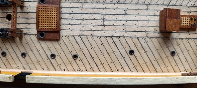

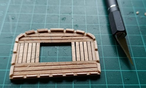

As always, I start by checking the box, the manual, and the plans. I prepare the base so we can work on it. On a piece of MDF, I've placed perfectly aligned wooden blocks so the frames fit inside and I can position them without the false keel warping. All the edges need to be sanded to remove the burn marks from the laser cut. Once that's done, I place the first frame, glue it in place from the inside using a mortise and tenon joint, and position it. I hold the freshly glued frame in place with two 90° aluminum angle brackets and clamps, and let it set. That will be the routine for all of them. While I'm putting on the six rows of deck planks, I make the divisions to adjust what would be the actual frames, cut them, and do the nailing. In reality, what you see are wooden plugs, as the nails are protected by them. I do it with a woodburning tool and a very fine tip. I hope you like it.Imagen de WhatsApp 2025-11-26 a las 12.02.21_242537ca.jpgImagen de WhatsApp 2025-12-01 a las 21.06.32_a1b232c0.jpgImagen de WhatsApp 2025-12-02 a las 00.01.23_c495a836.jpgImagen de WhatsApp 2025-12-02 a las 00.01.24_3cef21ef.jpgImagen de WhatsApp 2025-12-02 a las 00.01.24_36c0e9a9.jpgImagen de WhatsApp 2025-12-02 a las 00.01.24_c2728ffa.jpgImagen de WhatsApp 2025-12-02 a las 00.01.24_eb5bf3c7.jpgImagen de WhatsApp 2025-12-04 a las 12.00.23_ddceb974.jpgImagen de WhatsApp 2025-12-04 a las 13.01.58_5a23a2b3.jpgImagen de WhatsApp 2025-12-06 a las 17.50.23_33cba1f9.jpg

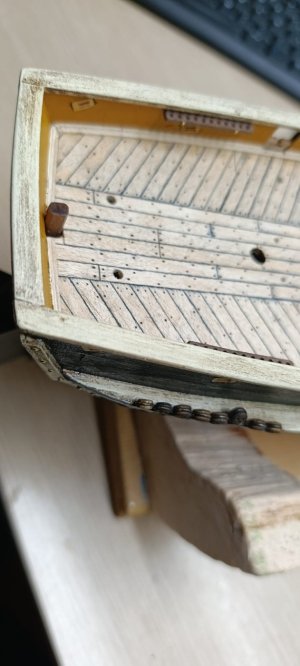

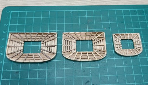

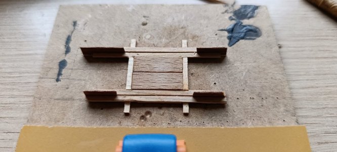

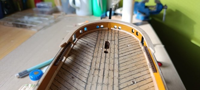

I continued gluing the frames, taking my time, while I planked the deck. Now I'm making a "bed" to fit five planks into and put them on the saw at a 30-degree angle so they all end up at the exact angle. I have to say that this time I tried using a black marker for caulking, and I didn't like it very much; depending on the wood, the ink runs. I still prefer graphite. Once all the planks were glued, and after a good sanding, I applied a coat of nitrocellulose sealer, a coat of steel wool, cleaned it well, and then marked the planking lines to simulate the nailing I reproduce with the woodburning tool as before. Onward... Best regards.Imagen de WhatsApp 2025-12-04 a las 12.00.23_4d698004.jpgImagen de WhatsApp 2025-12-04 a las 12.00.23_ddceb974.jpgImagen de WhatsApp 2025-12-04 a las 13.01.58_5a23a2b3.jpgImagen de WhatsApp 2025-12-04 a las 13.01.58_5668e0e4.jpgImagen de WhatsApp 2025-12-04 a las 13.01.59_bafe9e8f.jpgImagen de WhatsApp 2025-12-04 a las 13.01.59_bfda3679.jpgImagen de WhatsApp 2025-12-04 a las 12.00.22_601243ea.jpg

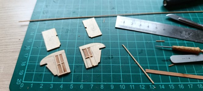

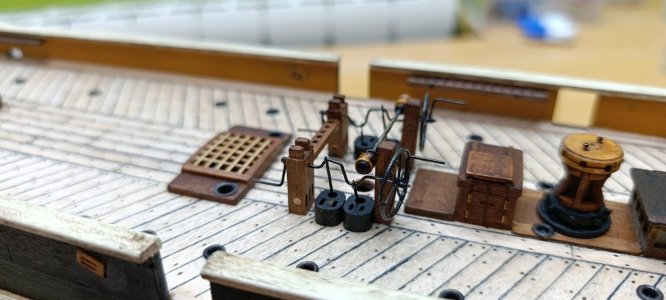

Okay, getting to the point, today I made a full-size copy of the deck to mark where the portholes, or skylights, or whatever they're called, will go. They're not symmetrical; I got the measurements from the actual maps, and I'll see when I get around to drilling them. I've been looking into reinforcing the mast pockets, and all four are the same diameter!!! :lol: :lol: :lol: which I highly doubt, unbelievable. I've already glued the deck in place; I've held it with rubber bands to force the sag, because it's not naturally swayed. I'm presenting the transom, and I see it doesn't fit. The hull needs to be lowered to accommodate the transom's angle. Furthermore, according to the actual plans and the shape of the deck, it curves at the stern, which needs to be forced. I'm looking for a large circumference so it doesn't break in the rudder area, where there's less material. The TV swivel works perfectly. I dampen it and gradually tighten it, applying heat at the same time, which helps maintain the curve. Cheers and shavings.Imagen de WhatsApp 2025-12-06 a las 18.38.38_0d1820ac.jpgImagen de WhatsApp 2025-12-06 a las 18.38.38_8e16845d.jpgImagen de WhatsApp 2025-12-06 a las 18.38.38_30c6f5da.jpgImagen de WhatsApp 2025-12-06 a las 18.38.38_ab82563b.jpgImagen de WhatsApp 2025-12-07 a las 11.47.46_b8190455.jpgImagen de WhatsApp 2025-12-07 a las 11.47.47_be718952.jpg

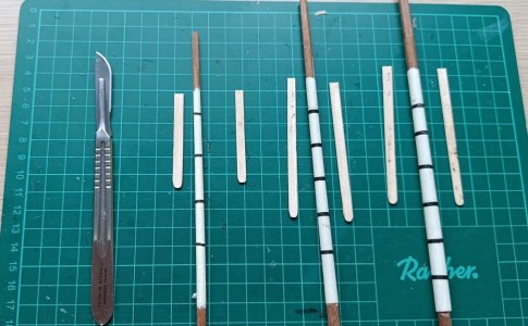

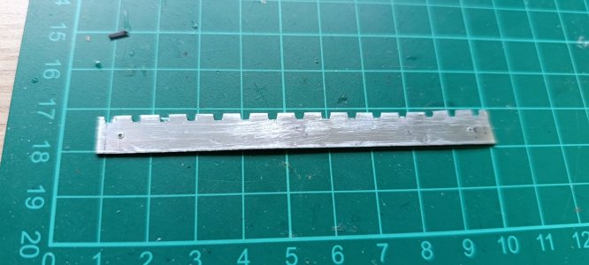

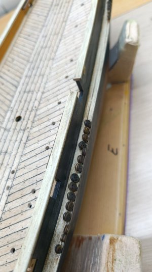

We continued with short breaks on the Nepo. I lined the bows with 0.5mm board and made cuts every 60mm to simulate planking, then painted it ochre yellow. As I said, I'll try to match its last voyage, and according to reliable sources, its interior changed from green during combat to yellow during the expedition. For 24 hours it rested on a flat surface with clamps to ensure it adhered perfectly with contact adhesive. Next, I began shaping it, starting with the edges of the bowls, but that wasn't enough. Finally, on a block of wood, I drew the curve of the deck at the bow, and with a coping saw, I cut along the line. Now I had a male and female part of the curve, so I lightly sanded it to create more space for the two bows. Little by little, I forced the curve by applying heat and steam with the plate placed on top of the mold, until it reached its full curvature, leaving it for 24 hours to set. Some of the boards glued with superglue shifted out of place, but it's a small section; I'll fix it. Having checked the curvature, I'm drilling 0.8mm holes to insert tacks for securing it against the ribs and ensuring a good glue bond.Imagen de WhatsApp 2025-12-11 a las 18.22.24_1fbec709.jpgImagen de WhatsApp 2025-12-11 a las 18.22.24_9238a8f7.jpgImagen de WhatsApp 2025-12-11 a las 18.22.24_f288d3a7.jpgImagen de WhatsApp 2025-12-11 a las 18.22.25_a0c0dd56.jpgImagen de WhatsApp 2025-12-11 a las 18.22.25_d5e7da3e.jpgImagen de WhatsApp 2025-12-11 a las 18.22.25_da628d51.jpgImagen de WhatsApp 2025-12-11 a las 18.22.26_7ef637ce.jpgImagen de WhatsApp 2025-12-11 a las 18.22.26_86c50e21.jpgImagen de WhatsApp 2025-12-11 a las 18.22.27_83ab4120.jpgImagen de WhatsApp 2025-12-11 a las 18.22.27_b8add103.jpg

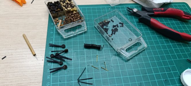

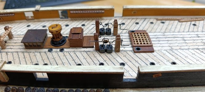

Good afternoon. As I believe—I say "believe" because in the end there are always blocks or rods missing—I'm focusing more on the Erebus-Terror with the SJN's yards. I've already attached the two bows and started planking the transom. I added the gunwale after shaping it somewhat. The bow's curvature with this ramin proved difficult; even when wet and hot, it kept cracking. I adjusted the openings relative to the gunwale, and on one side I had to add some filler to the bottom. I made the sides of the skylights; I finished one, and the other is in the process of cutting the glass, which will be translucent to simulate ice and frost. I made the table from 1mm thick board because the one that came with the model was 2mm plywood, which was too thick. The legs are made from the heads of round toothpicks, saving me from turning them.
It has three grooves in the bands; I'm not doing this step, as it's already done in the SJN, which also has them: two with two pulleys and one with three, all according to the plans. I make them from boxwood blocks, routing the pulleys and inserting 1.5mm rod to simulate them. I mark the position of these grooves on the bands, and first, using a drill and a 0.7mm bit, I drill the entire perimeter to make cutting easier. It's adjusted with a blade.Imagen de WhatsApp 2025-12-16 a las 16.53.53_5e7bb683.jpgImagen de WhatsApp 2025-12-16 a las 16.53.53_9da0d834.jpgImagen de WhatsApp 2025-12-16 a las 16.53.42_cb1d3267.jpgImagen de WhatsApp 2025-12-16 a las 16.53.42_f7441c71.jpgImagen de WhatsApp 2025-12-16 a las 16.53.42_fedec28c.jpgImagen de WhatsApp 2025-12-16 a las 16.53.43_f85c2d99.jpgImagen de WhatsApp 2025-12-16 a las 16.53.52_1dc39123.jpgImagen de WhatsApp 2025-12-16 a las 16.53.52_5cb21943.jpgImagen de WhatsApp 2025-12-16 a las 16.53.45_4c830d20.jpgImagen de WhatsApp 2025-12-16 a las 16.53.46_1f12ee4e.jpgImagen de WhatsApp 2025-12-16 a las 16.53.49_8be86239.jpg

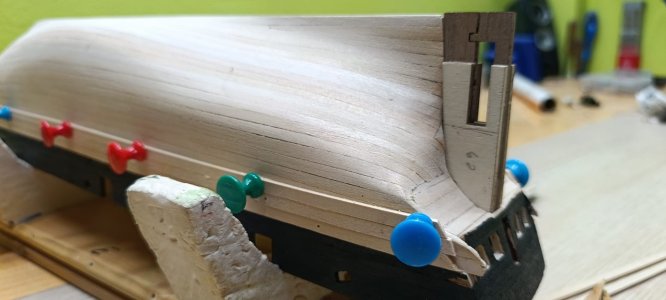

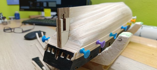

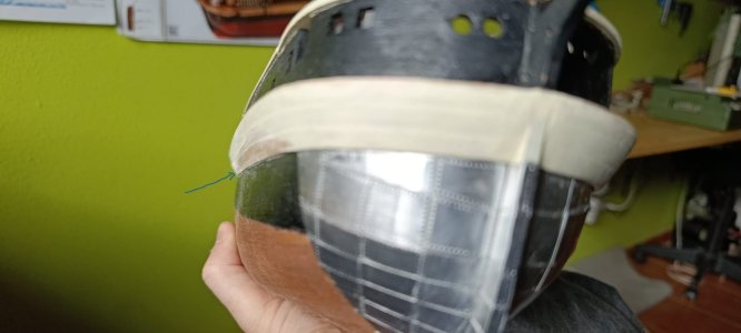

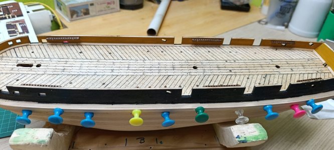

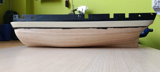

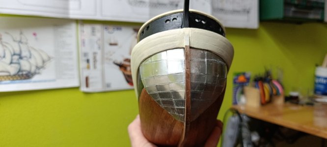

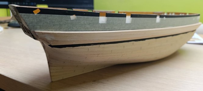

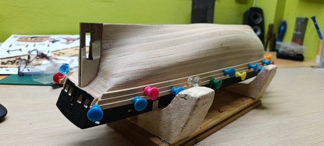

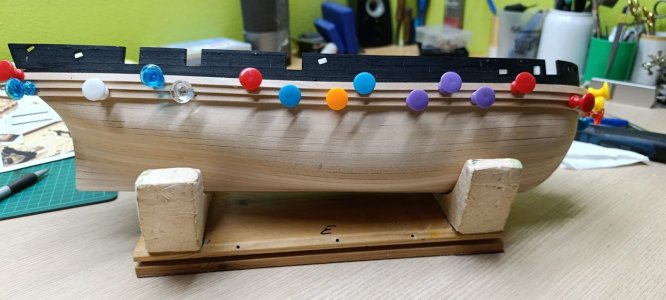

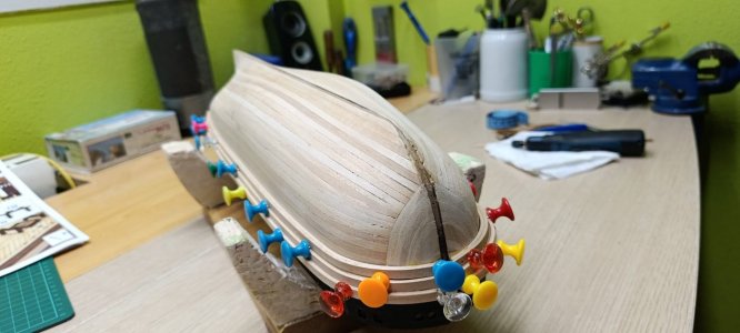

He seguido forrando el casco, alternando ambas bandas para evitar reviros, esta vez he probado con agua hirviendo y luego secador de pelo y el acoplador del soldador para dar forma a las curvas. El acople he de decir que va bien, no llega a quemar la madera y tiene suficiente calor para dar forma. Cuando llevaba 273 del casco empece a tomar en seria la de anchura de las tracas, aún así creo que tendre que poner otras atún medidas en proa. Ahora hubiera puesto en inicio un taco de refuerzo en la proa entra las falsas cuadernas 2 y 3 para dar más forma curva. La popa, no la he realizado como dicen las instrucciones, cuando este acabada pondre fotos de todo el conjunto. Un saludo y virutas.
I've continued planking the hull, alternating between both sides to avoid warping. This time I tried boiling water, then a hairdryer, and finally the soldering iron's coupler to shape the curves. I have to say the coupler works well; it doesn't burn the wood and provides enough heat for shaping. When I had reached 273 cm of the hull, I started to take the planking width seriously, but even so, I think I'll have to add other planks at the bow. I would have initially added a reinforcing block at the bow between frames 2 and 3 to enhance the curve. I haven't completed the stern according to the instructions; I'll post photos of the whole thing when it's finished. Cheers and wood shavings.

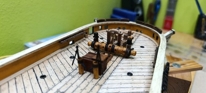

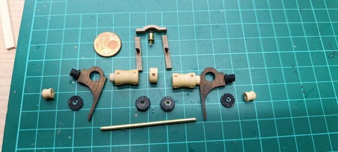

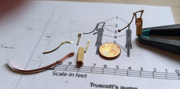

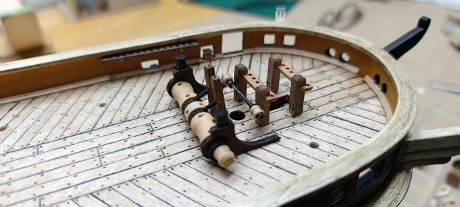

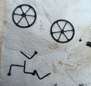

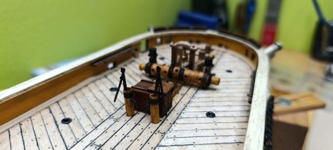

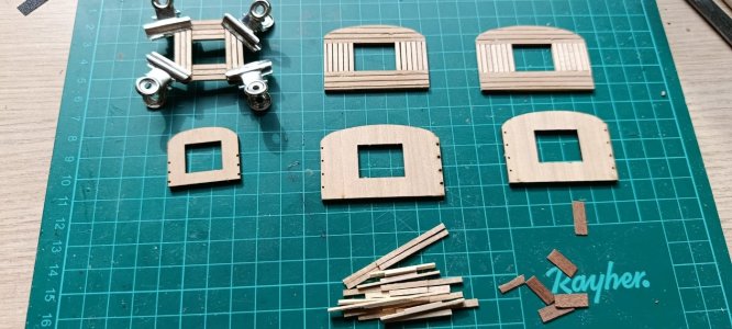

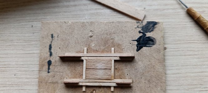

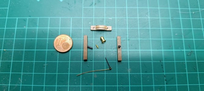

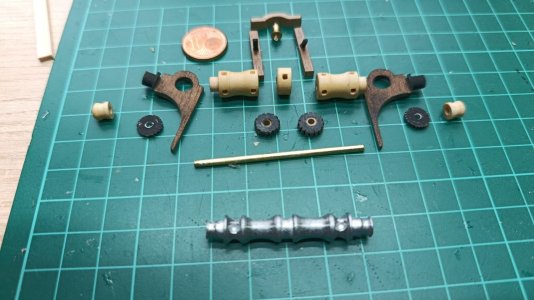

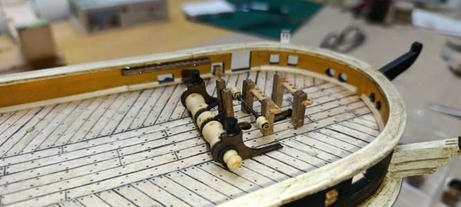

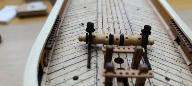

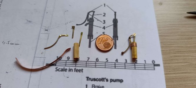

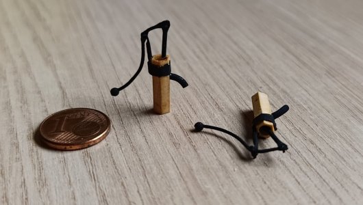

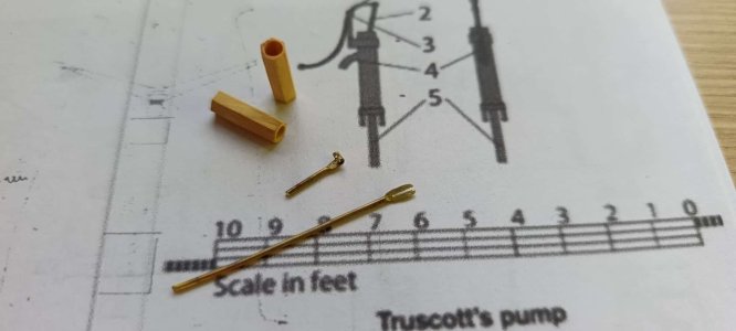

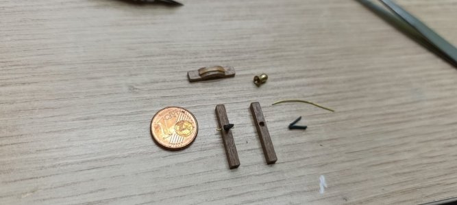

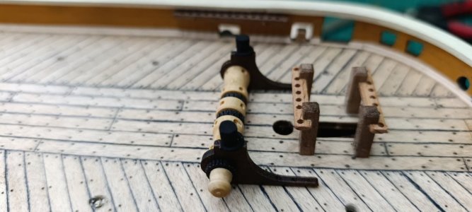

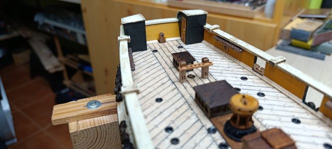

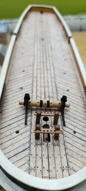

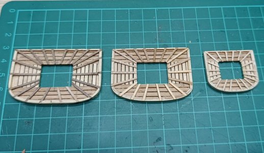

Y entre traca y traca, para gastar el tiempo, he realizado el cabrestante Philiphs, la información la he sacado del libro de Matthew Betts, HMS Terror: The Design, Fitting and Voyages of a Polar Discovery Ship que comprende en PDF, pero claro su modelo es a escala algo mayor, 1:48, con lo que los detalles se pueden hacer mejor, aún así esto contento con el resultado, eso sí, la maquinaria ayuda mucho, sobre todo el torno y la fresadora. Consta de 35 piezas de diferentes tamaños, para las uñas de freno he usado pequeños cáncamos, realizado casi su mayoría en madera de boj. La base donde lleva los trinquetes, es boj tratado de negro con tinta china.
And between fireworks, to pass the time, I made the Philips capstan. I got the information from Matthew Betts' book, *HMS Terror: The Design, Fitting and Voyages of a Polar Discovery Ship*, which is available as a PDF. Of course, his model is a slightly larger scale, 1:48, so the details can be done better. Even so, I'm happy with the result. The machinery certainly helps a lot, especially the lathe and the milling machine. It consists of 35 pieces of different sizes. For the brake lugs, I used small eyebolts, and it's mostly made of boxwood. The base where the pawls are mounted is boxwood treated black with India ink.

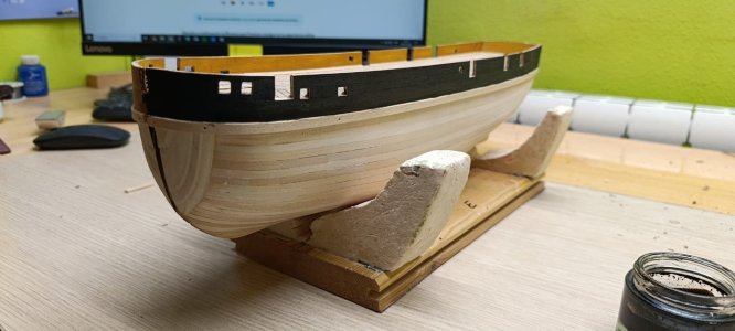

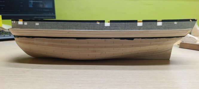

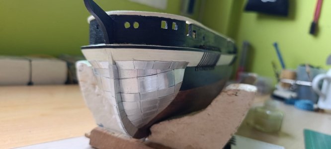

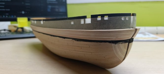

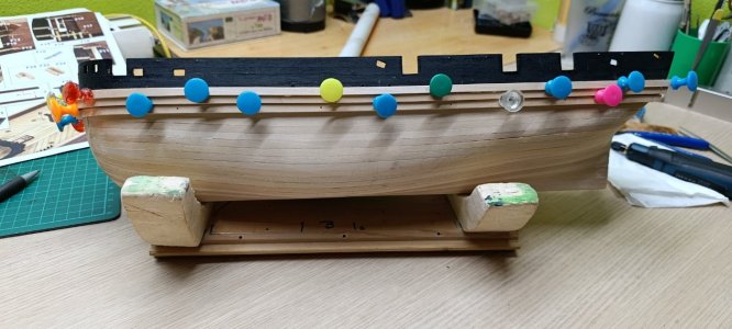

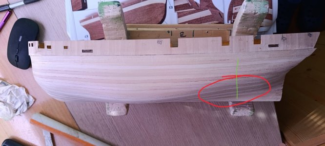

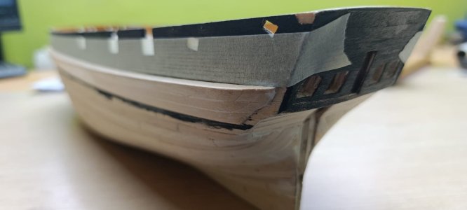

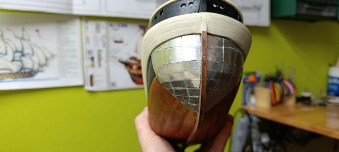

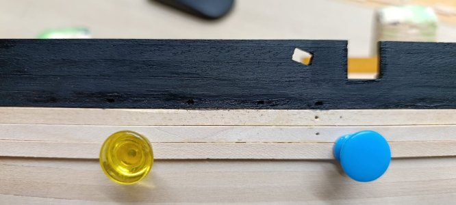

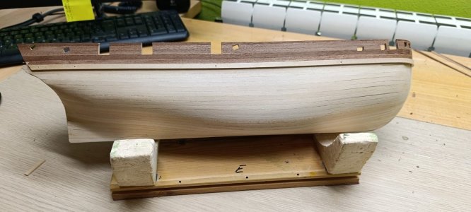

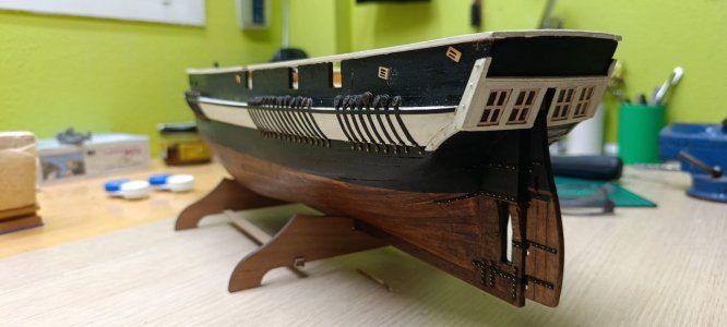

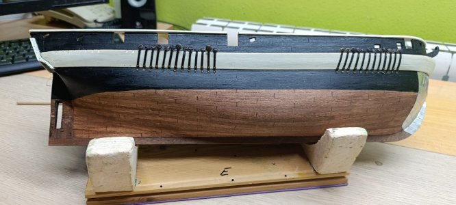

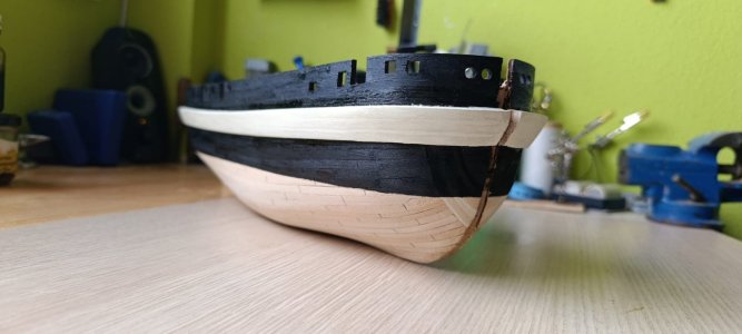

Como no me ha tocado la lotería, terminó el forrado del Terror. La final solo he tenido que poner dos atunes por banda, uno en zona de codaste de popa, pegado a traca de aparadura, y otros dos para cerrar el casco en proa. Me ha fallado por unos 3 mm el afilado de tracas, pero me siento satisfecho. Ya he pasado primero un cristal para desbastar lo más gordo y luego lija. El cristal es de un vaso que se me rompió el otro día, y he de decir que no había usado nunca y es una pasada, al ser curvo con diferentes curvaturas se da bien la forma. Un saludo y virutas de Reyes Magos
PD. En las cuadernas hay un error gordo en ambas bandas, por qué me extraña mucho que haga esa forma, desde el ordenador os señalaré el lugar y la cuaderna afectada, corregí algo pero no ha sido suficiente evidentemente, habría que meterle un relleno de 2 + - en ambas bandas.
Nota:
Lo marcado en rojo hace algo de hueco, y la línea verde sería la cuaderna afectada, lo estudiaré e intentare subir la solución, a ver si tengo foto del antes de forrar...
Efectivamente, en ambas bandas, se hace un "hueco" en la zona marcada, no creo que el casco tuviera esa forma, más bien es un fallo de diseño en esa cuaderna, la nº 9, le hace falta 1 mm de relleno en esa parte.
Since I didn't win the lottery, the planking of the Terror is finished. In the end, I only had to add two planks per side, one in the sternpost area, close to the strake, and two more to close the hull at the bow. I missed the planking by about 3 mm, but I'm satisfied. I first used a piece of glass to rough out the roughest parts and then sanded it. The glass is from a glass I broke the other day, and I have to say I'd never used it before and it's fantastic; being curved with different curvatures, it takes shape well. Best wishes and Three Kings' Day shavings!
P.S. There's a big mistake in the frames on both sides. I'm very surprised it's shaped like that. I'll point out the location and the affected frame from the computer. I corrected it a bit, but it obviously wasn't enough. It would need a 2 mm filler on both sides. Note: The area marked in red shows a slight gap, and the green line indicates the affected frame. I'll study it and try to upload the solution. I'll see if I can get a photo of it before the lining... Indeed, on both sides, there's a "gap" in the marked area. I don't think the hull was originally shaped that way; it's more likely a design flaw in frame number 9. It needs 1 mm of filler in that area.

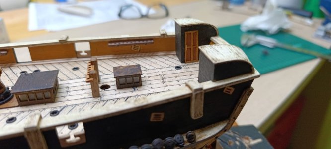

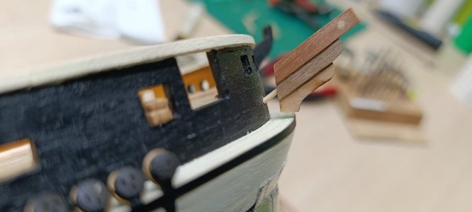

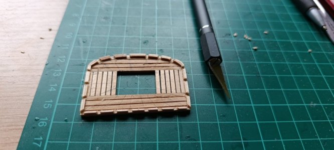

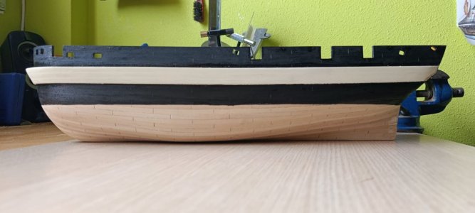

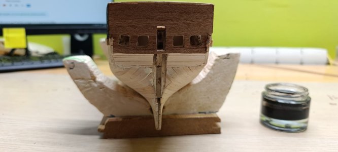

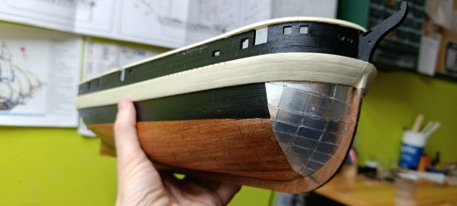

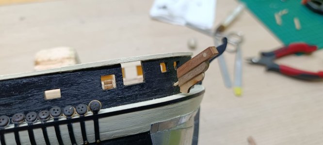

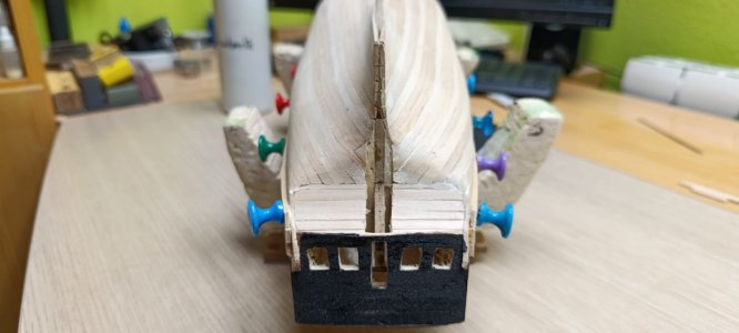

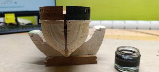

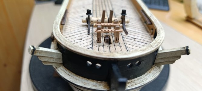

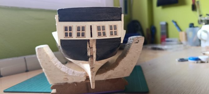

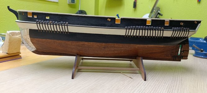

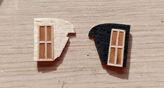

Terminado el forrado, colocados los refuerzos o tacos en proa y rebajados hasta darles forma, hoy lo hubiera hecho entero de tracas, con la plantilla que saque con el taco de madera, agua hirviendo y una noche forzadas en molde, salen con la curva deseada. Pongo la primera tabla para hacer el refuerzo que recorre ambas bandas, según Ocre le da una anchura de 5 tablas, osea unos 10 mm, según el plano original es de + - 8 mm y eso le doy, 4 tablas tres y dos, luego hay que rebajar y darle forma. Una vez pegada la primera, forro las amuras por el exterior, tiño de negro con tinta china, hago los imbornales, redondos en cubierta, ovalados a la salida en amura, los escobenes para las cadenas de las anclas, estos barcos llevaban 10 de diferentes tamaños. En este punto lo mismo, Ocre propone unos escobenes de 2 dos por banda, yo los hago de 5 mm que es lo que marca el plano. Sigo haciendo los refuerzos, y mientras, coloco los cabilleros en amura, les practico unos agujeros pasantes para poder poner un clavo y sujetar asi a las amuras.
Doy forma al pozo de la hélice, pero no lo pego aún y abro agujero en la zona de las ventanas para darlas profundidad cuando las haga. Un saludo y virutas...

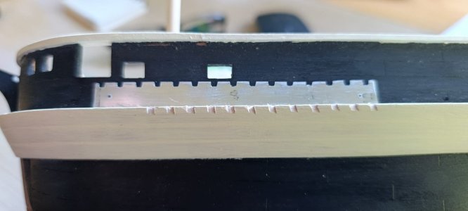

En las cuadernas hay un error gordo en ambos bandas, por qué me extraña mucho que haga esa forma, desde el ordenador os señalaré el lugar y la cuaderna afectada, corregí algo pero no ha sido suficiente evidentemente, habría que meterle un relleno de 2 + - en ambas bandas de la cuaderna nº 10 .
Ya sabemos que es un kit casi de iniciación, y viendo como dicen de forrarlo
:doh:
pero las cosas bien hechas, bien acaban no? No tengo claro si rellenar esa zona, pues va ir todo de negro,
:think:
creo que se va a quedar así, lo único para los siguientes constructores que lo tengan en cuenta.

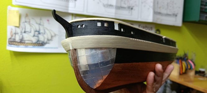

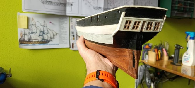

Ya he rebajado el "canal del hielo2 como lo llama Matthew, y efectivamente, con las tablas puestas es suficiente, si ponemos una más se va de escala por un 20%. Emplastecido los agujeros de las chinchetas, solo queda lijar y dejar fino. Un saludo y virutas

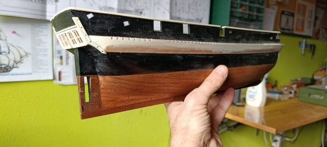

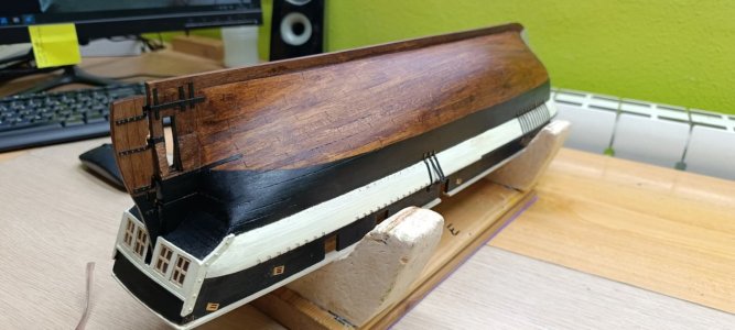

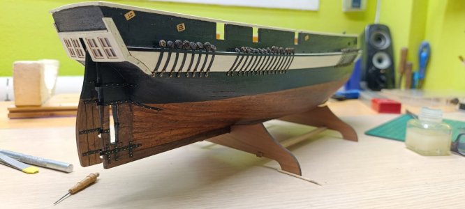

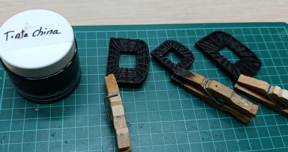

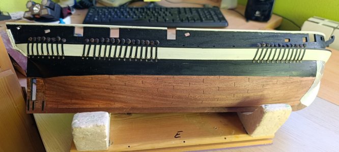

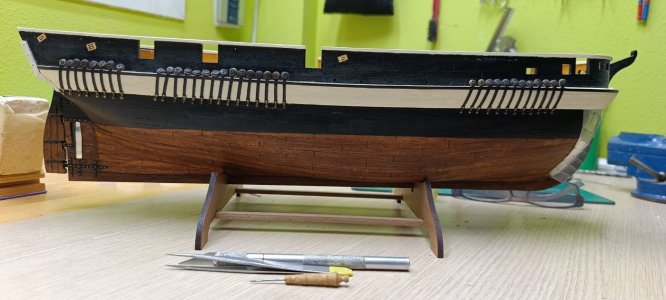

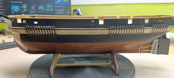

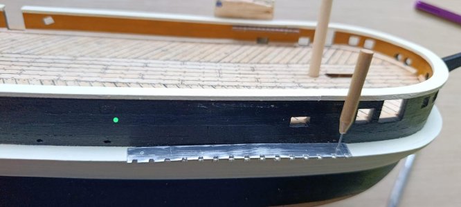

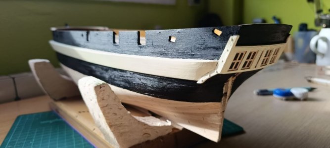

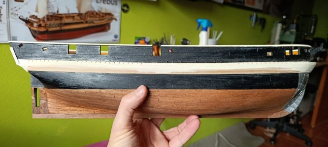

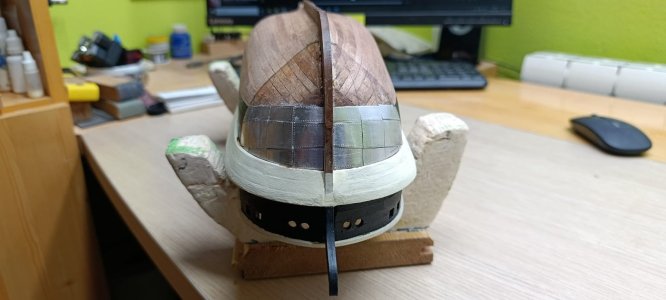

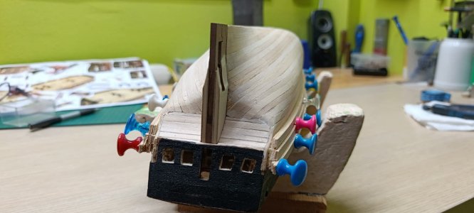

Seguimos avanzando, marco la linea de flotación, pues va de negro hasta ahí, luego unos lo tiñen de negro, yo lo haré en madera oscura, voy haciendo pruebas. Hago el espejo de popa, no quiero poner las ventanas del kit, osea que las hago de madera, con lamina de plástico translucido para simular la escarcha. Hago la parte de proa de la tapa de regala, pues viene en chapa precortada, uso tres tracas pegadas a y previamente dadas forma en el molde, como las tablas son de 5 mm con la sierra y hoja fina, corto a la mitad todo lo largo de la regala, coloco toda la regala, ajusto y encolo. Un saludo y virutas.
