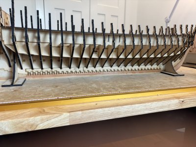

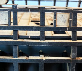

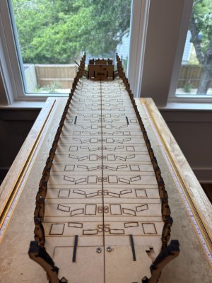

Only a couple more jig pieces to be installed, these MDF parts sit on top of the previous jigs and give more support to the bulkhead extensions at the level of the upper gundeck, they get screwed into the lower jigs to keep them securely in place.
These MDF sections as you can see also contain all of the gunport framing parts.

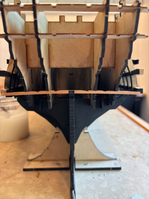

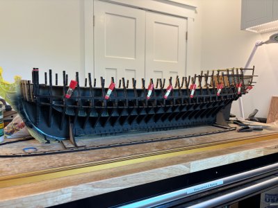

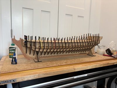

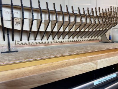

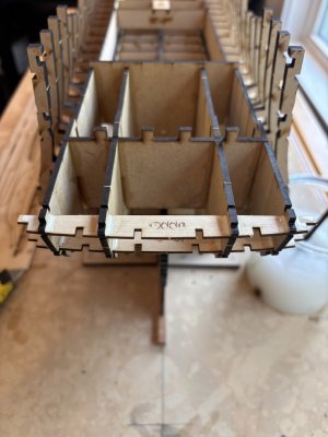

Here are the 6 lower frame locator parts glued to the former, 3 on each side. They are laser etched with the bulkhead locations at the top and the individual frame identifiers, very simple to figure out. I glued with a mixture of PVA and CA.

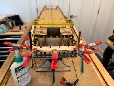

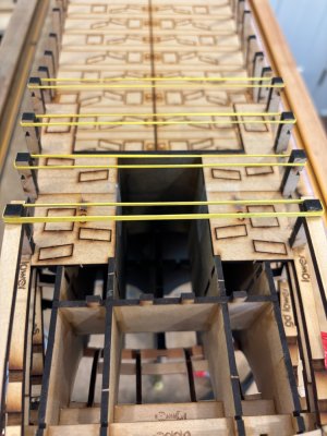

Here are the upper frame locator pieces, two mdf parts on each side that get clipped into the former at the bow and then into grooves on each bulkhead, I used a few rubber bands and some clamps to keep them securely in place while the glue dried.
Now that these have been installed I need to start masking off the keel and other parts so I can paint the former and all bulkheads flat matt black below the level of the gundeck so nothing can be seen behind the framing, or at least make it as invisible as possible.

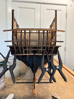

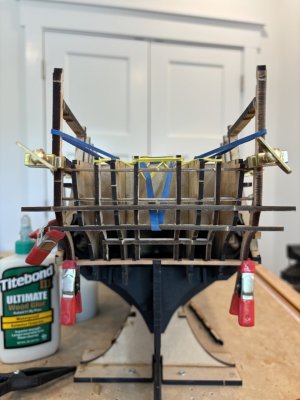

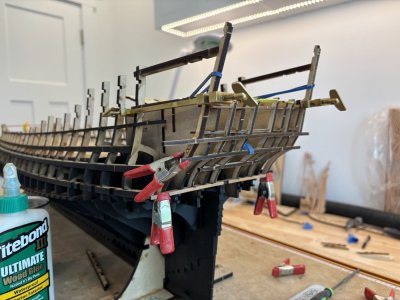

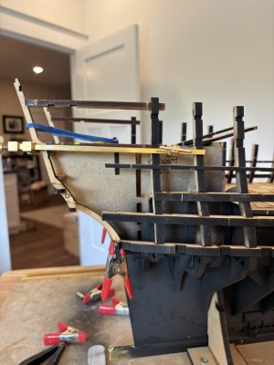

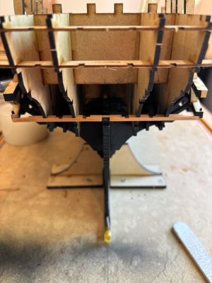

The beginning of the stern framing starts with the “wing” transom, this part has etched and cut into it the positions for the counter Timbers and the aft gunports.
I carefully removed the laser char and then using heat I bent it into shape so that it clicked into the jig slots correctly.
It only gets glued to the central former at the moment - NOT to the jig pieces
All six counter Timbers installed, the other horizontal ones are for the framing of the aft gunports and the other transoms.
The long runners down each side of the ship are not yet glued in place, just there to keep everything in its place until this stern framing is completed.
