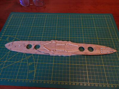

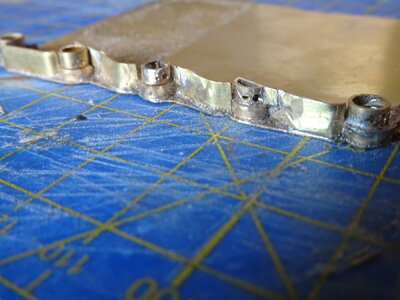

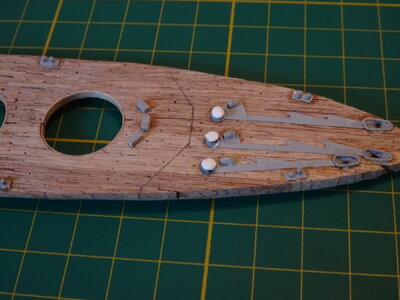

New long-term project: Building HMS Ramillies in het 1917 dazzle appearance. 1:500 scale scratch build in metal from plans with added PE. Started with the wooden decks, the gun turret barbettes, and now working on armour belt of the secondary guns. Building in brass on wooden plank-on-bulkhead frame (to be made after the decks are finished for exact size) totally new technique.

The decks are mounted with the fore secundary gun turrets and armour belt. First portholes made, an interesting eperience in 1:500 ;) Nice PE parts by White Ensign Models. The first part of the dazzle camouflage also painted. Started on the plank-on-bulkhead frame for the hull as a support for the metal plating.

Very nice! I'm intrigued by the deck material. Is is a repurposed commercial product- chipboard/Oriented Strand Board, glulam beam, veneer cored plywood? Or did you laminate it up yourself and if so how? A couple of links below to clarify US terms for the Netherlands.
chipboard: https://en.wikipedia.org/wiki/Oriented_strand_board
Glulam: https://en.wikipedia.org/wiki/Glued_laminated_timber
Veneer core plywood: https://www.columbiaforestproducts.com/product/veneer-core/
pebbleworm, I made the decks myself, using ,7x4mm abachi strips for the lower decks. These were cut up into 'plank lengths (1.8mm to scale) and glued into a laminate. That way the decks became a structural support part for the metal model. The deck of the boat deck is laid on a metal deck plate using cut-up abachi strips of .7mm
