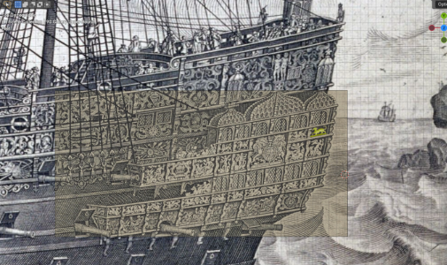

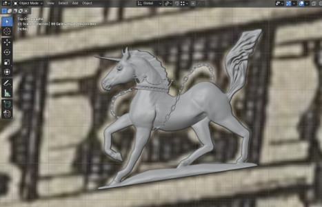

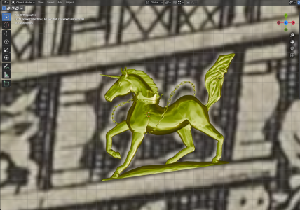

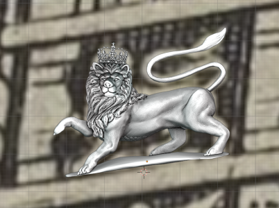

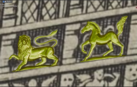

Thanks, Janos!

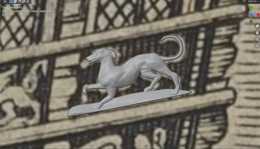

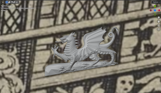

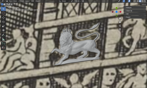

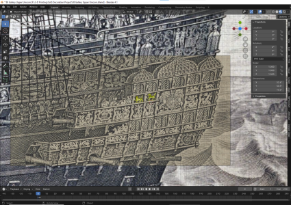

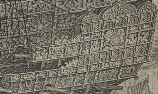

I understand. When you are hand carving all the decorations, many shortcuts have to be made. The detail of the carvings is so small that even fine boxwood has limitations on how small the details can get before they crumble. When I first started this model, it was with the intention of just building the kit as-is right out of the box. However, the disapppointment of learning just how many details were incorrect forced me to start the long kit bashing (modification) process, which very soon turned the model into a full scratch build just after the hull framing was assembled. The decorations just had to be replaced since no kit options were even remotely accurate. Having the Payne engraving and the painting of Peter Pett and the Sovereign as sources provide as nearly a complete picture of what the decorations should look like as one could hope for, giving the lack of information typical for ships this old.
Ship model like yours and Wolfgang Rotter's were the inspiration that started me on this long effort to create better decorations. Even so, some shortcuts were made. All of the decorations, particularly the earliest made ones, could use more work. My skills in Blender have grown from nothing to what you see now, but I still rely largely on modified assests from other artists. Only the ones that do not contain human figures and animals were wholely ccreated by me. That doesn't bother me, because the entire ship model project is a best effort from an intermediate skill level. Keep in mind, this is my second wooden model ship. It's like climbing the Matterhorn without any experience. The learning curve is quite steep! :D

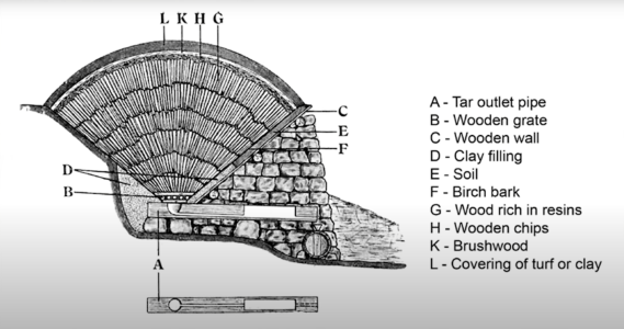

I came across a wood preserving video today and it discussed how to make pine tar, which was used for centuries. LINK. I have a bottle of it which I used to stain the sails on my previous model. You can still buy it today, even on Amazon.com. The useful picture shows now they made it. The wood chips and brushwood at the top were lit on fire, which would burn slowly because the covering limited the amount of air that could reach the fire. This provided heat that melted the resins in the wood (G), which would be collected at the bottom from the outlet pipe. Pine tar smells like smoke from a campfire. If you leave some out in a bowl, open to the air, the whole room smells of wood smoke in a hour. Even my sealed bottle makes the utility room it is stored it have a slight smoky smell. Imagine how a tarry sailor with this stuff on his shirt and hands smelled.
