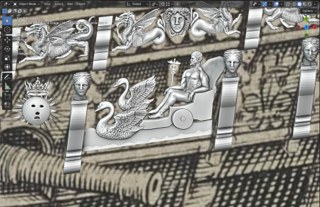

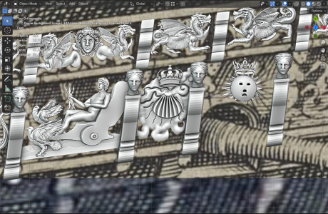

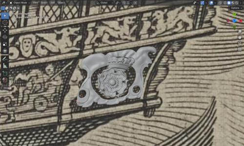

The sun with rays and crown, panel 5 on the lower balcony, is done.

Hi Kurt;
(Edit: I am referring to the panel to the left of the cannon barrel, not the one to the right. I think I have replied to the wrong post, somehow)
I truly hope that you will not be upset by my post here, but that panel is not the sun's rays; it is a scallop shell, which is a common motif in carved decoration.
It was also the emblem of St James of Compostella (James was a fisherman before he became one of Jesus' main disciples) the patron saint of Spain, I believe. The scallop badge was carried by thousands who made the pilgrimage to Compostella.
See examples below: there are probably thousands around with a quick search.

Upset? Heck no. Team effort! If anyone has ideas, I'm going to entertain them and it's easy for me to misinterpret these objects because of lack of historical knowledge regarding their origin. Members here have new sources of information. I'll redo this panel, since you were kind enough to provide a much better interpretation of it. No worries. Keep the advice coming! My sources are limited. As for the images, these are the only ones I have, and the black and white ones are far more detailed than the color image. I don't trust any painting's proportions, only the subject elements. You certainly can't trust the porportions of the stern painting of the ship in the "Peter Pett and Sovereign of the Seas". The gun decks don't even line up between the sides and stern.

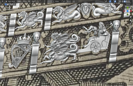

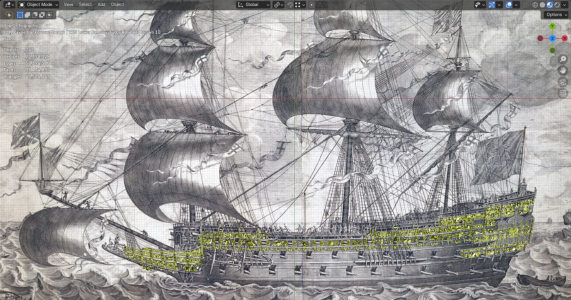

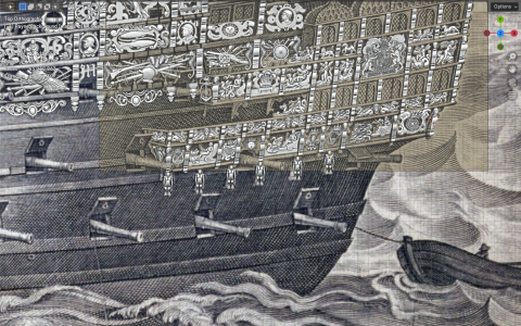

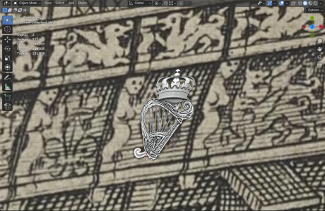

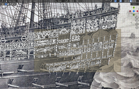

Here you go. Bear in mind that because of the angled aspect of the ship in the engraving, the objects appear slightly out of position and appear to have different angles than the image behind them. After printing, the parts can be filed a small bit to help fit them together or reprinted after being adjusted in shape in Blender.

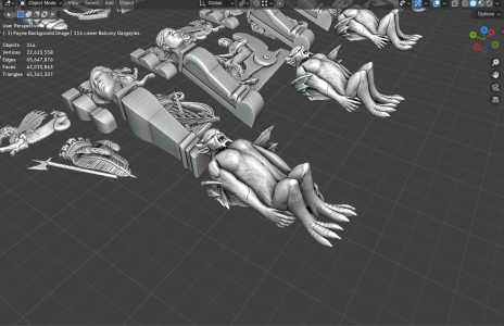

Hi Kurt. It looks like you've mastered this design program by now. Fantastic decorations, and the collection seems to be growing at a rapid pace. Keep up the good work.
Much of it is admittedly downloadable assets. The skill comes in how you bend, twist, and edit them into what you want. In other words, work outside the box! I'm getting better at using the sculpting tools to stretch, bend, and reshape things. Bones are used to repositiong limbs of characters and animals. Also, cleanup of interior and overlapping polygons is getting faster. If the object gets badly mangled, re-meshing tools can give it a second life. I am hoping that the free bas relief making tools like Bildeform will get better and have more options for refining their results. So far, at the small scale my objects are at, they are satisfactory. Visible flaws like stripes, polygon edges, and lines on surfaces would show up if the models were printed in sizes greater than 3 cm.
