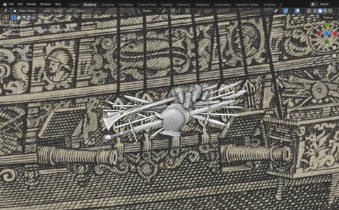

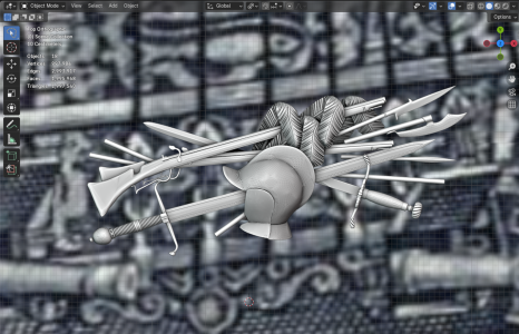

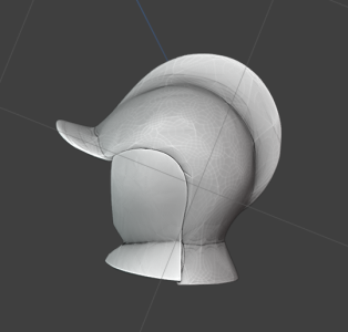

OMG! I see it now! It's a burgonet! Well done, @Namabiiru ! Can you pick out any other items? This ship project has become a test of pattern recognition.
Thanks to both of you. Truly helpful. :D Thumbsup I noticed that the comb of the helmet appears to be occluded by some object in green, which looks like foliage or a cloud.

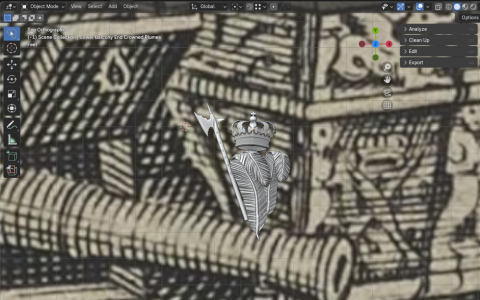

Comparing this panel to the one on the Morgan drawing, You can see an extra bracket and crowned object just aft of the panel we are discussing which is not found on the Payne engraving. This blurry picture is the best scan of the Morgan drawing which I can find. If anyone has a better one, please let me know.
The Pett presentation painting of the starboard side of the ship is no help, since the panel in question is completely different. It should a round shield over a collection of weapons. Note that he extra bracket and small decoration panel forward of the balcony is shown here just like on the Morgan drawing.

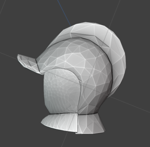

Luckily, I had a backup of the blender file which still has the unmerged objects for this panel. Hiding the two roses, here is what's left:
Hi Kurt;
The Morgan drawing is of no help here; Payne has made a better job of the decoration here, whereas Van de Velde's panel is not clear. Also, the details of the stern galleries on the VdeV drawing are very poorly defined, and do not match in quality the remainder of the works. I think that VdeV struggled with the details of the stern; in part because, when he drew the Sovereign, she was in dry dock undergoing a repair. The stern galleries he obviously was not happy with, as what we see now is a separate piece of paper stuck over the top of whatever it was that he had drawn previously. There are definite errors in his work here though, as the cannon shown are not in line with the remainder of those on the same deck.
Regarding the additional bracket and small panel, I would certainly believe this to be correct, as in other areas the arrangement of the brackets is retained from the top to the bottom of all the decorative works. Payne presumably made a bit of an error here.
Ratty
Hi Kurt;
Ratty
Making the additional small panel would line up and match the brackets vertically. I wil have to rethink how to squeeze that panel in over the Payne engraving, or leave it as-is.

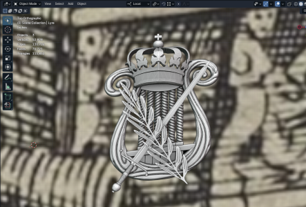

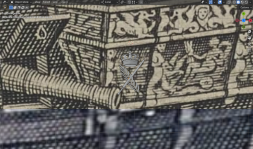

The next decoration panel, according to Hendrik Busmann, shows a sword crossed with an olive branch under a crown, which he states is associated with King Henry II Plantagenet. A google search shows that those items are more commonly associated with King Charles I, for which this ship was built for. A triple unite (coin) from 1644 below shows the sword and olive branch symbolizing war and peace. I am not sure what the background behind these objects is made up from because the engraving is indistinct. This is the sort of information hunt I have been doing for each of the decorations on this model. Each one becomes a history lesson.

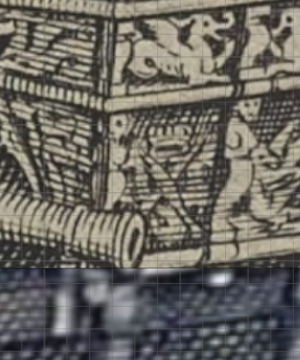

Here is the 1st panel on the lower balcony of the gallery. I can't make out what shape is behind these objects. In anyone knows what it might be from a coat of arms or badge they know of, let me know.
Here is the 1st panel on the lower balcony of the gallery. I can't make out what shape is behind these objects. In anyone knows whoat it might be from a coat of arms or badge they know of, let me know.
The term "sovereign of the seas" is a historical phrase, most famously associated with a 17th-century English warship, but it does not directly relate to the emblem shown in the image.
The emblem in the image, featuring a crown above a crossed sword and olive or laurel branch, appears to be an "escudo". The term "escudo" is a Spanish and Portuguese word meaning "shield" or "coat of arms". It was also a former monetary unit used in Portugal and its colonies. The specific emblem likely represents a particular organization, military unit, or historical entity, but its exact identity is not specified by the provided information.
From AI. ;)
