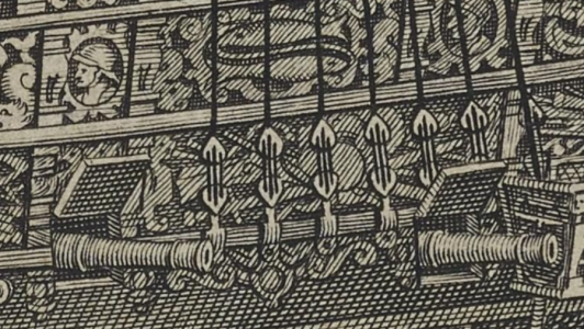

I understand your thinking behind the contradiction of displaying the Tudor Roses and the military themed icons on that row of decorations. I agree. Hendrik Busmann was not specific regarding what objects were in this particular panel. That object can be re-made, but it is so difficult to make out what it is. You mentioned a drum lying on its side, but I am having trouble making that out. I can't make out if the central object(s) are shields or something else. Failing that, I placed two roses there. I think I see the butt stocks of two matchlocks on the left. The swords are more clearly shown behind the deadeyes. To our other members, please tell me what you think, guys. Often others can see what you do not.

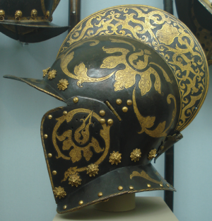

I could see it being a drum, a shield, or even possibly a plumed helmet.
Hi Kurt/Namabiiru;

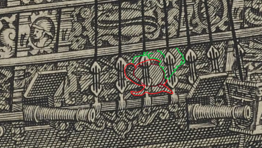

Thanks for the better picture of this panel: I think that Namabiiru's suggestion of a helmet is correct; well spotted! The peak is pointing to the left, between the 2nd & 3rd set of deadeyes; there is an ear-flap pointing downwards and left, below the third deadeye in the bottom row, and a neck-guard at the bottom between the 3rd & 4th deadeyes; and there could well be a crest on top, behind the 4th deadeyes.
It is possible that the object at the top, between the 3rd & 4th deadeyes, is the stock of another arquebus, whose barrel is pointing downwards to the right, ending at the top of the port-lid, and passing behind the helmet's crest.

OMG! I see it now! It's a burgonet! Well done, @Namabiiru ! Can you pick out any other items? This ship project has become a test of pattern recognition.
Thanks to both of you. Truly helpful. :D Thumbsup I noticed that the comb of the helmet appears to be occluded by some object in green, which looks like foliage or a cloud.

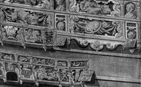

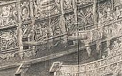

Comparing this panel to the one on the Morgan drawing, You can see an extra bracket and crowned object just aft of the panel we are discussing which is not found on the Payne engraving. This blurry picture is the best scan of the Morgan drawing which I can find. If anyone has a better one, please let me know.
The Pett presentation painting of the starboard side of the ship is no help, since the panel in question is completely different. It should a round shield over a collection of weapons. Note that he extra bracket and small decoration panel forward of the balcony is shown here just like on the Morgan drawing.

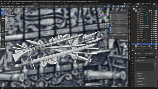

Luckily, I had a backup of the blender file which still has the unmerged objects for this panel. Hiding the two roses, here is what's left:
