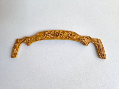

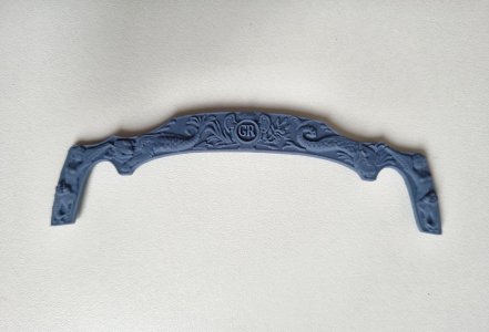

I’ve finished the resin stern decoration piece...or rather...I’m done with it haha. Of course, there’s always something to criticize, but I thought it was good enough as it was. And I was afraid that if I worked on it longer, I would mess it up more than it would improve.
Stages of painting:

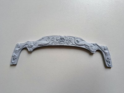

First of all, as stated in the manual, briefly immerse it in freshly boiled water for a few seconds and hold it against the stern to establish the correct shape. This went fine. I actually repeated it once more to make sure the shape was there.

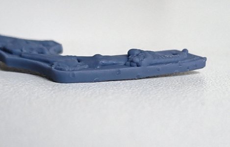

Be aware that there are these small dots/dimples on the sides that need to be sanded away. I assume these are the mounting points for the printing? You could possibly use a little filler for the dimples. On one of the sides, you also saw the "layers" from the printing. I sanded this smooth a bit as well.
Primer on laquer base
For the base color I used the gold brown from Vallejo as used earlier for the windows etc. Then a rust brown wash for the deeper laying parts. This will also mute the gold brown a bit. And in the end a lighter mixture (more like dirty white) for some highlighting (dry-brushed) As you can see I didn't go overboard with this...just subtle effect which I like.
And then of course the blue... I spent a few days on that, about 20 minutes or so every day, after that I start shaking too much or I can't see properly anymore. So I stopped at a point where I'd had enough. So there is always room for improvement, but I think it's okay this way. I found the thin line around the edge to be the trickiest, especially. Because it blends in a bit rather than being a hard line, you have to paint it neatly yourself. Quite tricky!

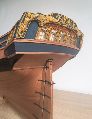

Anyway...this is how it looks assembled!I will take some more photos when the rest of the decoration is on the stern, plus the name. The camera is also acting a bit vague here regarding the colors, but I will see if I can get that a bit better with the other photos as well.

A nice paint job of the stern decoration, Ronald. Also the overall look of the stern!
Beautiful work, thanks for posting.
Could you explain the finish on the Wale? Is it straight paint? In my shop use a light coat of stain or shellac prior to airbrush applied Tamiya.
Thank you,
-Rich
You mean the black? Yes it's just straight paint. It's the Admiralty Ironwork black from Caldercraft.(if i'm not mistaking...all those data is lost with the hack of MSW, but i'm 90% sure :p ) It's a nice flat black. Caldercraft does also have a "dull black", but somehow their ironwork black looks more flat. I applied it with a brush.
Awesome, thank you.
Excellent work on the stern decorations. I like your muted color hues, very pleasing.
I did expect you would appreciate the color tones; you always have such beautiful warm tones in your models! Wonderful examples for inspiration;)
