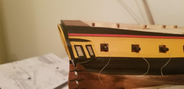

I finished up the three gratings that go on the gun deck underneath the longboat as well at the longboat cradle. All these pieces are made from Walnut so even with a neutral clear stain they are of a very dark hue. When placed on top of the gun deck the starkness in colors between the deck planking and the gratings was extreme and I didn't like it one bit. So I "watered down" some Minwax Golden Oak and applied another coat on the deck planking. I sure Forrest Gumped my way through this part of the project, the end result I really like. I also added some shot racks along the side of each large grating, this feature is not on the plans. I'll install the cannon balls after planking the hull and Surprise is right side up again.
The second picture is the kit provided cast longboat which I won't use. I just ordered another Falconet longboat that I just finished for my Rattlesnake build, this is picture three. It's 5mm longer than the kit provided boat but it'll fit just perfect in the longboat cradle.
The last picture is an example of the supports for the deck immediately above the gundeck, forecastle up front and quarterdeck in the rear, notice the camber that the false deck and then deck planks will follow. The plans call for the center pillar being 21.5mm long. I found the camber to be very pronounced and so I shaved a bit off that central pillar, it's more like 20mm long now.
View attachment 170088View attachment 170089View attachment 170091View attachment 170092
I liked your idea of replacing the cheesy pot metal life boat, so I found a kit from Master Korabel of a long boat. It took two tries, but I think it will look pretty nice. I painted it to match the Surprise. The rudder is removable, like a real long boat's.
The beginnings of the upper rail for the rest of the ship. This truly is custom work, as the lower rail slopes down as it goes forward the supports for the upper rail are all different heights. Each one has to be done individually. Starting at the stern with a set height and ending at the most forward point where the external ladder will be (1/4" high) the upper rail will slope down but at a different rate as the lower rail. The plans make it look easy....it ain't.
