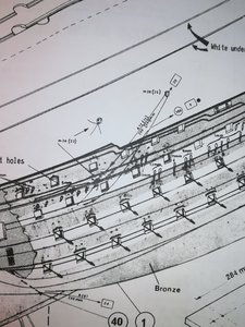

G'day Arntos, the rope is attached to the hull with an eye bolt, it then goes up through the block 26 back down through block 24 ( which is attached to the hull with a three legged Fixture ) then it goes through the hull and is tied off to a cleat, hope this helps you,
Best regards John,
