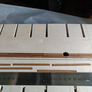

This is the false lower gun deck with the planking I've done so far. OK, so its not perfect, so here is my mitigation.
This is my first ever attempt at proper deck planking, and I had no idea even after experimenting how I was going to get around some quite important issues. So I just bit the bullet and went for it.
Also only a small percentage of this deck will ever be seen once the ship is complete. The manual calls out that only a part of this deck be planked but in order to get my self experienced in this Im doing the whole of this deck. The manual also calls for it to be fitted first and then planked. Not on my watch!
Plank length. Should be 85mm x 4mm according to the manual so I had a colleague at work 3D print me a pattern for cutting planks at 80mm, 85mm and 90mm, all at 3mm and 4mm widths. A colleague at work very kindly 3d printed a design for a plank length cutting gauge, various lengths and for two widths. However I didn't allow for shrinkage of the printed gauge ( I didn't even consider shrinkage as I had no idea it would shrink).and it shrunk enough to give me less than 85mm and 4mm width planks do no fit it the 4mm gauge recess. They did for a while but then they didn't.
Cutting: I bought a really flimsy cutter. The handle flexed like a flag in the wind when tryin' to chop me wood up! However, a slight mod to this has made the handle stiffen to a degree where the planks can be cut with a decent 90 deg. angle ( I superglued lolly sticks into the recesses of the cutting handle and that stiffened it enough.
Colour of the planks: Easy, I used Colron Geogian Medium Oak wood stain, The reason for staining rather than varnish is that after all this is done I'm going to have to sand this all down flat and so it will probably need staining again. Theres only one coat of stain on each plank. The stain is quite dark but then that deck would be a rather dark part of the ship I would think. Subsequent decks will be lighter
The false deck so far .....
Caulking: Using the brick layers technique, of using a line of thread to give me straightness. I laid thread (with some tension) across the length of the deck using the planks as width markers, in the photo's there is one either side of the planks laid. The thread also then becomes the caulking, or at least the first layer to give me the gap to run another line on top and in between the lines of planks. (The plan here is to drizzle some extra thin super glue to soak into the thread to make it hard and sandable.)
The only unsolved issue I have is how to caulk the butt joints. Where I did attempt it I used black paper but soon gave up on that, too fiddly. so I decided not to bother but for the next two decks that go on it needs to be solved. They need to be more or less perfectly done.
The important thing here that quickly became apparent was to lay the planks in between the lines of thread and not to butt the sides of the planks together. Lay them inbetween the lines of thread and they will be straight. Tacked down with wood glue and when the "big drizzle" of this extra thin superglue happens then it should soak doen into the wood fibres and consolidate the bond of the panks to the deck.
Four butt shift pattern: Complicated but I think I've done it right. There are 5 pencil lines running across the width of the deck that are 17mm apart. Each row is lined up against thes lines in the pattern that I believe to be correct shift pattern.
All the planks are 4mm wide, give or take a few hundred microns, to allow for natural wood imperfections. The exeption to this is the centre plank which is 6mm wide. I did this to allow for the width of the false keel slots and the 4mm planks go either side in a mirror image pattern.
So, thats where I am right now, A few more weeks of just laying this little lovelies down and it can be trimmed, fitted and glued.

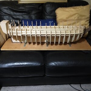

So, this 'monster' has been sitting under cover for the best part of 2 years and being rather neglected.
This weekend I chiseled off the original deck planking I did. I just was not happy with it. Starting over, I turned the deck over and started, this time I will plank this deck in situ and this time define borders of the (to be) planked area. If it goes well then I will do the entire deck. No need to make more work for myself but, its one of those things that is just crying out to me to be done.
Im sticking with a King Plank down the middle just simply because its the same width as the ply it sits between and then from there use that to lay the planks down.
Planks will be between 84 to 85mm long X approx 3 to 4mm wide x 1mm thick. I think, if my memory serves me correctly that 84 to 85mm is the scale length of these planks in 1/72. I could be wrong about that though.
I stained the original planks (shown in previous pics) in some kind of dark oak wood stain but I wont be doing that this time.
The planking will be laid down using the 4 plank shift method. May be I will use the thread I used previously between the planks for caulking.
Lime wood strips (not from the kit though) cut on my newly refined strip cutter. I'm going to try to work out a method for skimming planks to a uniform width and length which would be how I would want to do the more visible deck planking.
The next phases of this build is to shape the hull formers into some kind of shape to take the sides and the hull planking.
Although I do have a sticking point here where I've glued the stern post on and I believe it should be attached after the hull planking is done. Has anyone else done this in their buld? I'd be interested to know
Also I will be looking through all the build logs I can find on here for this, and probably following them.
