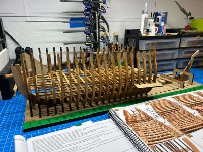

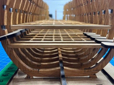

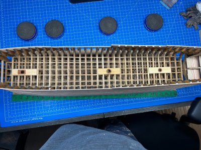

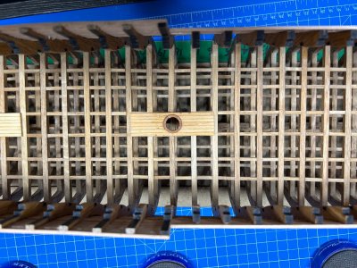

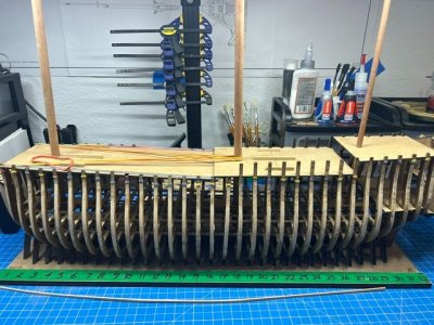

This is slow going. Those giblets suck. I never liked giblets anyway. But, I have to admit, once they are glued in, the whole structure is definitely more stable. I am on rib 19 of 32, 2nd deck. I've had 3 of the oak ribs just snap at weird places, not joints. They were tensioned only with very loose fitting rubber bands. The oak is very porous, dry & brittle. It soaked up 2 coats of danish oil immediately. It's imperative that the supplied spacers stay on. The upper parts of ribs have a tendency to drift.

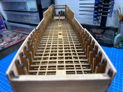

I think I'm on track according to the pic. The straightness of my giblet placing was much improved on the second deck. This would be much easier & straighter cutting rabbets on the oak beams with a mini table saw.

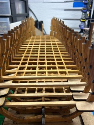

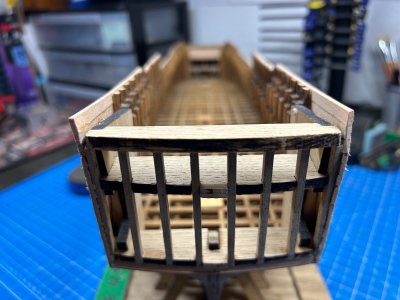

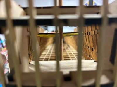

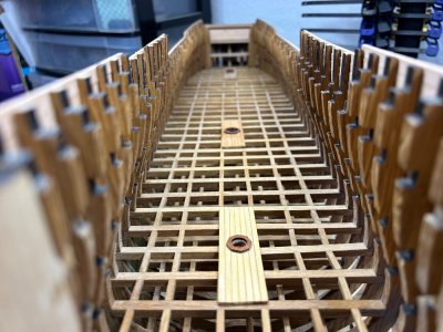

They are the 2x2 mm beams that are perpendicular to the 5x5 beams running the length of the ship. They are all cut to appx 15mm. Someone else on here called them "Nuggets or Noggins". There are hundreds of them. Me tagging them "Giblets" is from my Hillbilly upbringing in Southern Illinois & Kentucky. I have no idea as to the exact terminology. See pic below. The hardest part is keeping them all in a straight line. My second deck of giblets were much straighter than the first deck. I have one more deck to go with them.
